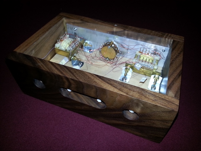

my discussion about resistors found an end. For pots and ladder switches ect , I´ve tried an inductive pot. I´ve never heard something that open. It can be dangerous, as long as it´s not burned in and you probably would have to redesign part of the cirquit, working point, bypass caps ect, but I won´t go back.
And I´ve tried resistors all over the cirquit, like cmf55, AMR, Allen Bradley, beyschlag, Texas Components...
Again, the whole environment is important, and it may be necessary to change old habits, but I´m satisfied with TX2575 naked Z-Foil from Texas Components. (in hifi Amps!) They steal less sound as any other resistor, especially in the high frequencies dynamics. it´s worth a try. And you have no chance to see the difference in sound on an oscilloscope...best place to get them: Arbie Lopez from Texas Comp.
Now I have to find out best Voltage divider Rs in sower supplies with more than 1 W. Any ideas?
Hi jh, the inventor of the inductive pot I´ve tried is Pieter Teurniet from Gronau Netherlands. His mail adress is pieter@tribute-audio.nl. Tribute - The final word in audiotransformers
Low frequency limit was about little below 20 Hz, high -3dB point wasn´t reached at 100 kHz in all positions. You´ll find more information on tribute audio´s homepage. Peter
autoformer
I too went inductive attenuation. In my case Slagle unit from intact audio. Awesome sound beats any form of resistive attenuation.
What amp are you using: SS or tubes?
Tube. 110w 6c33c OTL monos. 100k input. tube output DAC.
