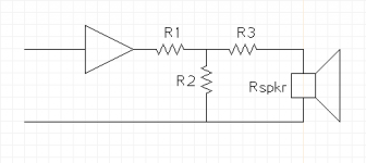

How do we go about designing something that absorbs 99.9% of the output power, while maintaining the same driving impedance as the amplifier?

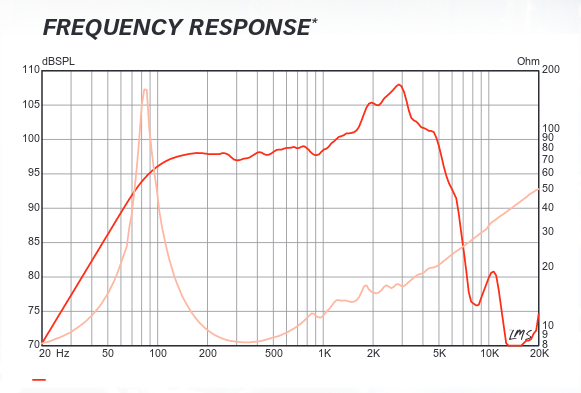

With a typical vintage guitar speaker (around 90 dB/W @ 1m), and shooting for "no louder than a vacuum cleaner", that still works out to somewhere in the ballpark of 10 mW for overdriven tones, and 100 mW for clean tones.
Keep in mind that there are plenty of modern guitar speakers that are actually much more sensitive than this. As an example, I've attached the manufacturer's published frequency response for the Eminence Rajin' Cajun - it has a sensitivity around 98 dB/W@1m over much of the guitar frequency range, and over 105 dB/W@1m in the range where the human ear is most sensitive, around 3 kHz.
( Here's a direct link to the manufacturer spec-sheet: https://www.eminence.com/pdf/Ragin_Cajun.pdf )
At 98 dB speaker sensitivity, you need a whopping 1.6 mW of audio power from the guitar amp to get 70 dB SPL at a 1-metre distance!

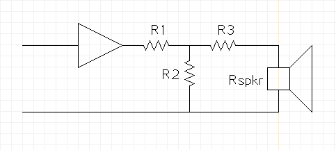

This is actually not too hard, if you know (or can measure) the output impedance of your guitar amp. You can use the three-resistor L-pad schematic I drew up and attached.How do we go about designing something that absorbs 99.9% of the output power, while maintaining the same driving impedance as the amplifier?
Chris
For large attenuation factors (like the 99.9% you describe), you can use a simplified design method. Start by setting R3 equal to your guitar amp output impedance.
Now calculate the attenuation caused by R3 interacting with the speaker impedance. Suppose this is 10 dB, and you need a total of 20 dB.
That means R1 and R2 have to provide the remaining 10 dB of attenuation. R1 plus R2 should equal 8 ohms (or whatever your amp is expecting). R2/(R1+R2) should -10 dB, so you can now calculate R1 and R2. (For large attenuation factors, R1 will end up basically the same as Rspkr, and R2 will decide the attenuation amount.)
Keep in mind we don't need exact values here. For practical purposes, assuming your amp is happy feeding an 8 ohm speaker, I would just make R1 6.8 ohms, and fiddle with R2 to get the attenuation you need.
If you try this, I hope you'll tell us how you liked the result. (I'm pessimistic about how good the sound will be, for all the reasons discussed previously on this thread. But I may be wrong. )
-Gnobuddy

-Gnobuddy
I bought one at a surplus outlet once, but never dared to use it on my (valve) guitar amps, because I wasn't sure how it worked, particularly whether the primary impedance would stay anywhere near 8 ohms as you twiddled the attenuation knob. I was concerned that it was just a variable-ratio stepdown transformer, and therefore that the primary impedance might go very high at larger attenuation settings.
Do you happen to know how these work, and/or if my worry was justified?
-Gnobuddy
Strap a 20ohm resistor across the primary, it'll be fine.
Thanks for the hint on the 3-resistor L-pad. I'd been doodling something similar but wasn't sure how well it'll work.
With my 2w amp, I can use small components and probably add a bypass switch!
Chris
