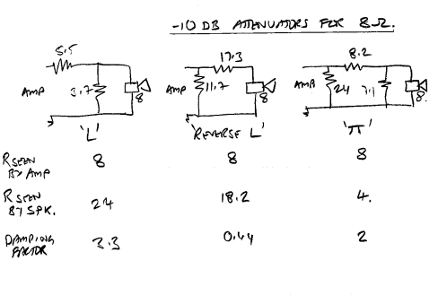

I’m wanting to build a simple fixed resistive attenuator, to bring two of my tube guitar amps down to about 5W, ie -10db reduced from 50W. The reason is for quiet home playing, but still with the tone , features and speakers of a full sized amp and without buying another low power amp. *Its also just a nice project to try out.
Im hoping for some comments on the options for how to do this.
Both the amps (Marshall VM226c and DSL401) have good master volume controls, and sound good at very low volume but they sound great if turned up at least a bit (and wonderful at high volume but I can save that for other times).
I’ve already rigged up a -6db box, and it works fine, tone is still good, but I want to try a few more db reduction. I figure -10db is a good target. It will give me some more spread on the volume control, reduce noise floor and let the tubes start to run a little more.
There are lots of variations on combinations of resistor values to match this attenuation while maintaining 8 ohm load on the amp. Here are three, being a conventional L-pad, a reversed L pad and a ‘Pi’ configuration.* Once all are calculated, they all have the same load to the amp and attenuation level.
The difference is in the output impedance as seen by the speaker - see sketch below., ranging from 2.5Ohms up to 18Ohms asuming 1 ohm amp Zo.
As I understand it, a tube amp has considerably greater output impedance than a solid state amp, and in a guitar amp, this contributes to the tone from the speakers, reducing damping allowing bass resonance to develop, and relatively adding to highs on account of the speaker impedance rising with frequency.
Some commercial attenuators have reactive components to maintain better tone as volume is further reduced. I’m not planning to go there yet, but what do you think of these arrangements, for my application? Any other comments? Once I settle on a design, Ill make each branch out of a group of wire wound resistors so that power dissipation is adequate.
With thanks for any comments.

The simple "L pad" is the most common.
I suspect it is used because it manages to obtain the lowest source impedance. Your numbers nearly confirm this. Rs ~2.2ohms, not 2.4ohms. 1ohm for amp output impedance is unreasonable.

The 1ohm Zo value is just an example, but Ive seen several references to a range of around 1 to 3 ohms for tube amps. The higher values apply to non negative feedbacj designs and lower to NFB circuits. Mine are one of each.

There's a few things going on here.
The first order thing is that (with lots of attenuation) the amp is seeing a resistive load NOT the reactive load that a speaker presents. This is amplified (sorry) if you've got an amp that uses feedback.
The second order thing is that at lower power levels the speaker non-linearities are going to be reduced (e.g. voice coil heating and non-linear magnetic gaps) or removed (e.g. cone breakup)
Thousands of electrons have died discussing this and there's many clever schemes around
I built up a -7.5 db attenuator, using a 'Pi' arrangement with resistors only. The amp sees 8 ohm and the speaker sees about 5.5Ohms.
It does what I wanted at very low volume so I'll probably pause here for a while. I tested it with my Vintage Modern combo, and in case anyone is interested, here is what happened:

Resistive attenuators are electrically flat by themselves and can be designed so damping factor as seen by speaker matches the one seen by directly connecting it to amplifier; main problem is that human ear loses high and low frequencies *a lot* when listening at low volume, check Fletcher Munson curve to see by yourself how gross it actually is, so in practice simple attenuators tend to sound thin - buzzy - muddy .

The comments and experiences above are very interesting. For myself, Im happy with the passive resistive design for what Im doing, I like the results I get and Id like to undestand deeper. Im not worried about the Fletcher-Munchen effects and the ideal is if a good 50W amp can be run with an attenuator as a good say 5W amp. I also think that guitar sounds are best heard through guitar speakers, even at low volume.
The effects of damping are interesting. An SS amp or a simple Lpad with large attenuation could add a lot of damping to a speaker response. That will reduce bass and treble, I think, for two different reasons. At the high end, the rise of inductive speaker impedance, combined with a higher amp output impedance, results in a higher voltage across the speaker than at lower frequencies, so lifting the highs relatively (ok so thats not a damping effect but an impedance/frequency/voltage divider effect). At bass frequencies, the free resonance has a peak, seen sharply in speaker impedance. If amp impedance is very low, this resonance is damped down greatly. But with higher imepedance, damping is less. The effect of less but still significant damping on response is to reduce the peak but also spread it wider. So a sharp peak in free resonance becomes a smaller general lift across bass in a hi z amp and is squashed flatter in a low-z amp or high -db attenuator.
But, coming back to resistive attenuators, using a 3rd resistor, we can achieve control of Z as seen by the speaker, and reduce damping, if this is what we want. But is this what we want in a guitar system?
