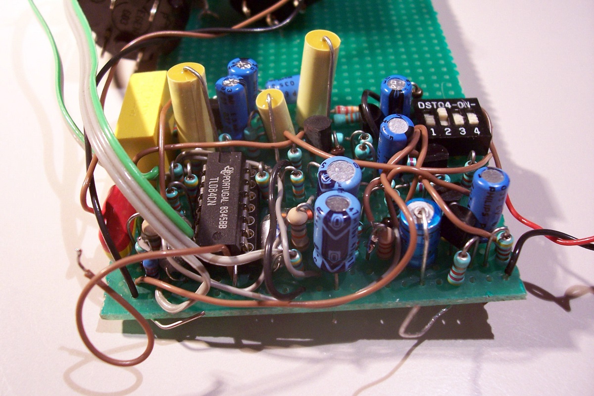

I have vast quantities of NOS components, including E-caps more than 40 years old, and when I use them, I don't care about reforming: I just build the circuit and power it up brutally, without any particular precaution.
I never had any problem with this method.
For example, in this project, nearly half of the E-caps are 40y NOS.
http://www.diyaudio.com/forums/atta...3240-simplistic-distortion-meter-100_5166.jpg
That said, if I had to test a tube radio set that has never seen power for 50y, I'd be a bit more careful
