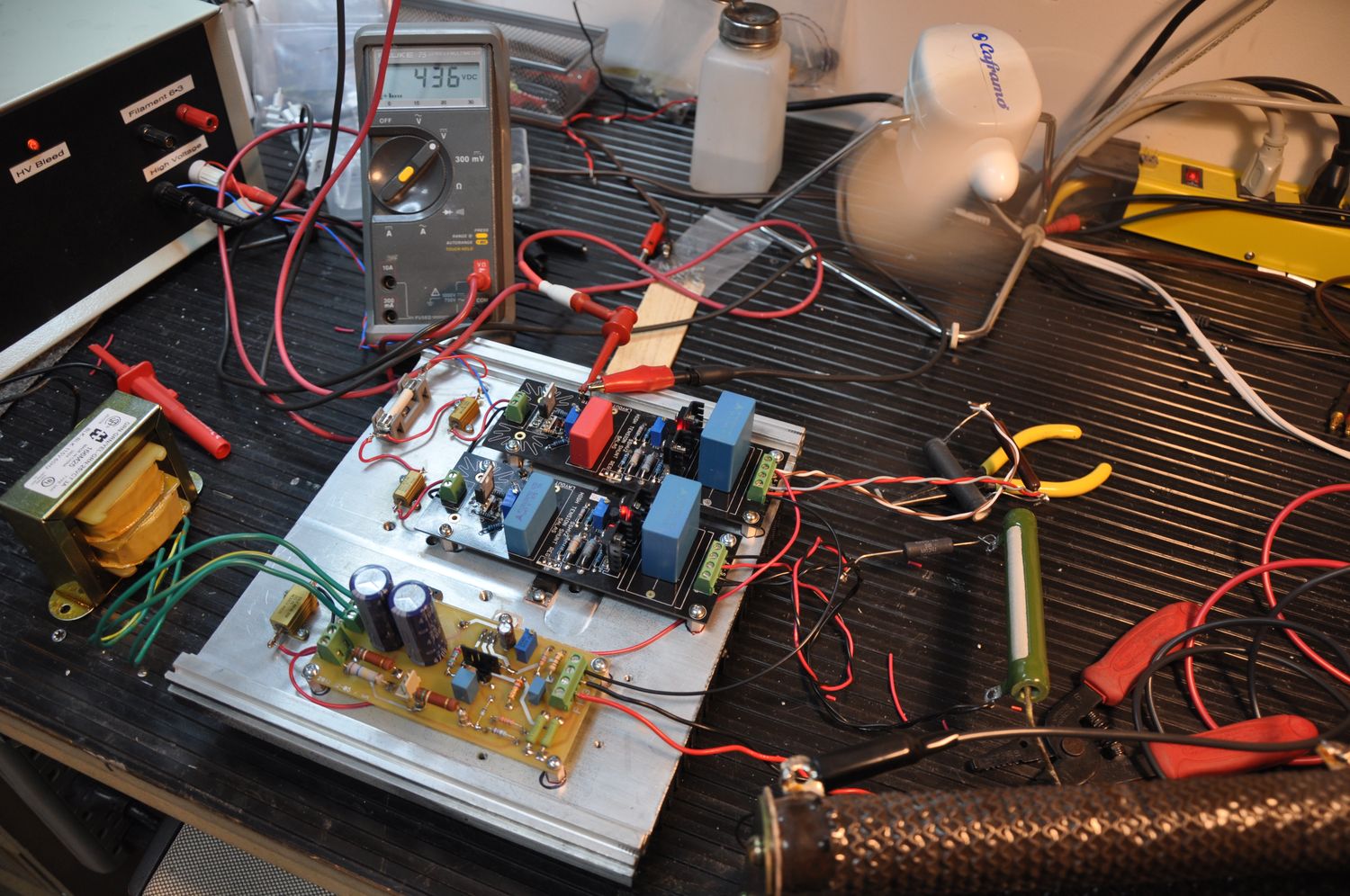

During the course of installing the new regulators, I updated the pre/driver PCB. There are "unmarked" connection points on the PCB where the coupling caps are connected. During reassembly I inadvertently swapped on one channel those tie points. No wonder the cathodes were going a bit crazy. I had to think about where this exact incident had happened before. I remembered that during my amplifier bench prototyping 3 years ago, I did the same thing. Once I recalled that, I looked for a swapped connection and discovered it. I had a very late night, last night. I should have realized this much sooner...I went as far as re-connecting my old power supply regulator PCB and once seeing the same thing was happening, knew it was something DUMB!!!!
After reconnecting the SSHV2's, I'm happy to say that your SSHV2 is STELLAR driving the screen load! Absolutely no issues, even with 100 ohm screen resistors. The cap is a 0.47uF (did not have a 0.33uF)
So now the only concern is spot heat on the IRF840. (see attached picture) The other PCB is the DC filament regulator w/cathode reference and fan supply. The chassis has a low volume, super quiet fan to move air through it from the bottom out the right side.
After running it for about 15 minutes with the amplifier playing, the IRF840 is measuring about 65C to 72C, measured directly on the metal tab of the device with an IR tool. I'm thinking this is a bit high, and would like to get it down. I'm presently using a mica insulator with thermal compound, and it's mounted on a flat aluminum surface That heatsink is heavy; the fins underneath extend at least 3cm from the backplate.

65-72C with 1C/W RthetaJC device like the 840 is not too taxing if it does not burn more than 10 to 20W on average. It breaks at 125C internally, but less average means more life in all electronics. It should get its max standing temp on idle signal. How high it goes for 840 case temp if you leave it alone without signal? Say for 30 mins. Look for German Keratherm insulators. Red. Watch out for some conductivity with Arctic Silver and the like, this is HV. Some state they are zero conductivity, others state some degree.

I will also try the test you are suggesting; I'll idle the amp with no signal and check the temperature after 30 minutes. I'm probably over-worried, the maximum device temperature (Vishay) is 150C, and I'm not half way there yet. Although your sentiments are exactly mine on the issue of heat: in a case such as this, cooler performance results in better "in-spec" performance and longer life.
