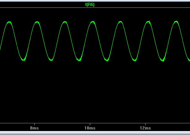

I scoped the screen supply, and nothing odd there; just 10mV of noise. Where the trouble starts is when I apply a signal to the input; the cathode voltages go wild. I already trashed 1 tube so I don't want to apply an input signal until I have this figured out.

Here's corrected model with the installed screen resistors (100 ohms) Also find the model for the "pentode 2"
Ignore the frequency response; the transformer is modeled without real parasitic values. The model was to verify overall correctness, voltage values and distortion plots.
  • 6L6GC_Full_Amp_Simulation_As_Built_Plus_CCS_DN2540x2.asc

I have measured the screen before and it "idles" with no signal in around 4 or 5mA. At full voltage in, around 1.8V, I measured 3V across a 50 ohm resistor and it dropped 3V (60mA) This is RMS; the model's predicted value is
about 70mA.
