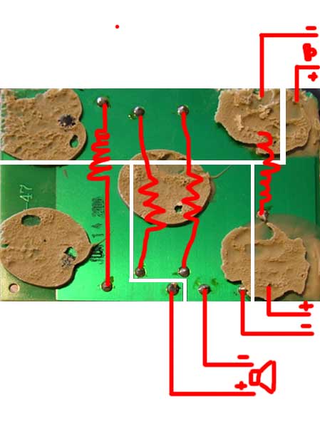

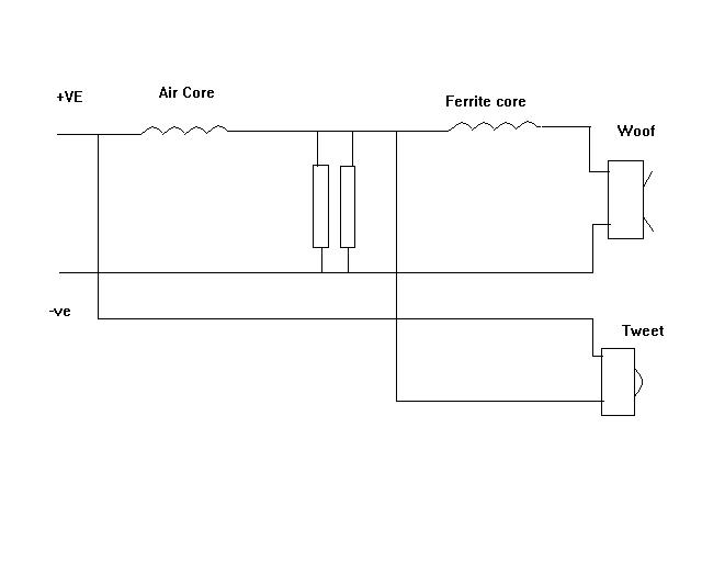

Replace crossover in existing box

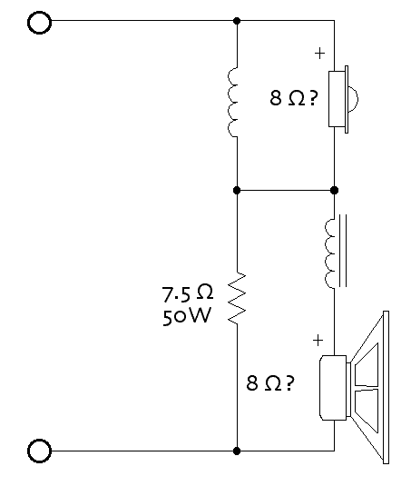

Shown is the treble section response into the ~ 6R section.
Note this ignores the impedance profile of the tweeters.
(And of course tweeter response)
:)/sreten.

I found I had one of those vifa tweeters sitting in an old cabinet so I have taken measurements of response on axis at 1m and impedance from it.
If someone has one of the vifa bass drivers and can take some measurements then I'll stitch the two together with a simulator and see how it works.
It won't be perfect as the cabinet diffraction will not be right but it should be enough to know how well the xover is going to work.
Andrew
Well it was a wet Sunday afternoon so I decided to try to work out the response of the two different tweeters. The responses are compaired below. If nothing else this has been an interesting exercise for me as I have never used any of these tools before.
In the end I entered both drive units using the data sheets so that the comparision was fair, rather than using measured from one and data sheet from another.
The data was traced in using FRD trace tool then the phase information was extracted using the FRD frequency response combiner program.
After this both sets of data were imported into speaker works and the Swifty crossover network applied to both of them.
Unfortunately the data link given for the Vifa woofer no longer works so I couldn't add the bass drive information to get a full response.
However I think this data is clear enough, whilst there will be some minor deviation arround the crossover region due to slight phase mismatch, overall this is a very good substitution.
I didn't change the values of the resistors in the crossover at all and it appears that this is probably the best option as the SPL is well matched.
Appolagies are in order; Sreten's idea was a very good one.
If anyone has a copy of the vifa data sheet or knows where it can be down loaded I will complete the responses.
Andrew

The apparent rise of ~ 5dB from 2KHz to 5Khz region to the top octave
is a little perplexing, if this is due to the tweeter inductance then the
reduction of "50R" to "15R" will reduce this significantly.
