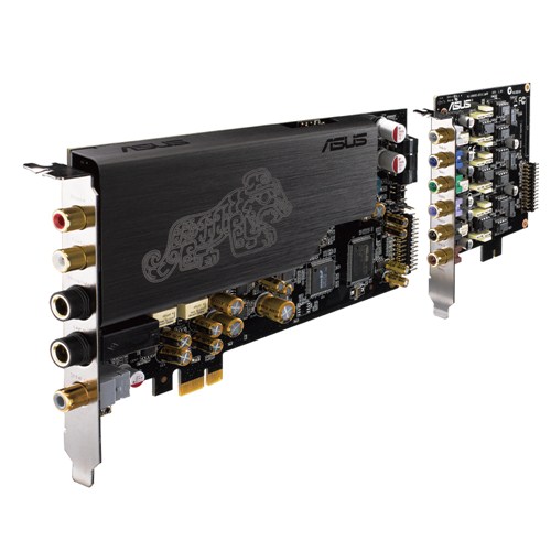

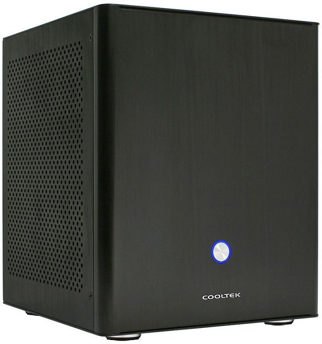

A few month ago I had to made a decision wether to use a complete hardware like MiniSharc or to build a PC for convolution. My requirement was a "black box" which acts as a FIR crossover with 8 output channels. I ended up with a small PC on Linux basis. It was cheaper and much more powerful than the MiniSharc. And it can directly stream my music. No jitterful S/PDIF or AD/Da conversion is involved.
As sound card I use a Xonar Essence STX II 7.1. I wanted an internal solution and no USB involved. So I can turn-on and shut-down the "black box" with one push the power button. And my little daughter can not pull out any USB cable. ;)
attachment.php
And btw. the Xonar has much better D/A converter than the MiniSharc. And filter length is not restricted which is great in the low end.
I use a Debian Linux with command line interface only on a small SSD. MPD accepts the music stream and BruteFIR does the convolution. There is also a small program that does the volume control and is triggered by a HID remote. The whole signal chain is in 64 Bit floating point. At the end there is high quality dithering to 32 Bit.
This Linux box is very stable. I had no crash and no malfunction yet. And I don't need any display or keyboard to control it. The HID remote is enough and the streaming sender can be a smartphone or another PC in the network. It works very well and you can not mal-operate the box.
On the downside I had to spend much time to get it running that good. ;)
PS: forgot to mention that the PC was cheaper than a MiniSharc with case.

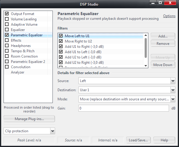

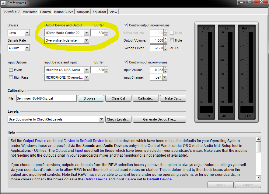

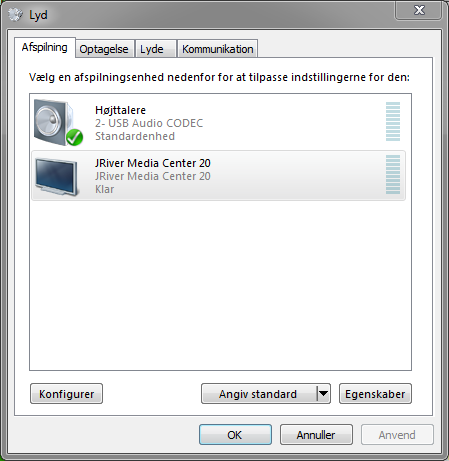

Can Arta be set as REW because following works for me measuring with REW and using JRiver as DSP for all sound streams.
Use JRivers virtual soundcard to listen into measurement chain, see JRivers help or website if virtual soundcard is not installed by JRiver setup. This soundcard if set as default in windows settings or manual is set for every program that create sound stream, will make sure all sounds be routet through JRiver DSP engine including web browser sound streams, but be sure JRiver program always is open or running in background, picture 1 is virtual sound card device. I don't view video on this computer its only used for audio but seen some articles annouced at JRiver website how to have video in sync with the delay that routing all sounds via JRiver DSP engine create.
Picture 2 is REW settings where JRiver soundcard is set instead of real hardware output device, and inside open JRiver program the real hardware device is set as output device.
Picture 3 is JRiver DSP window that always is open when measuring, example make a sweep tick off a filter or on to a new filter and compare plots, same goes for sum of multiway speaker verse single LF/MF/HF measurement just tick off/on channels and sweep again to compare.
