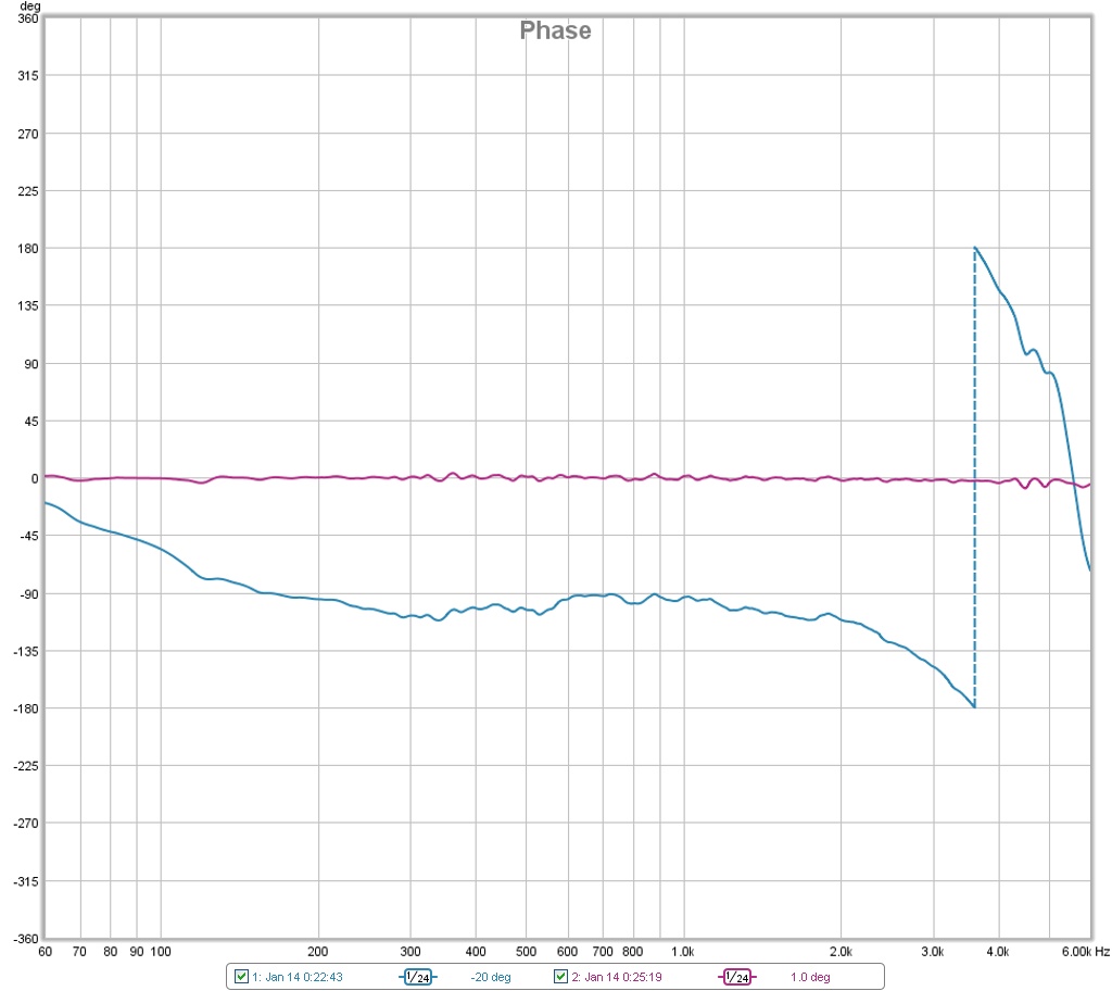

So I can now get ruler-flat phase from the driver's impulse response using my homebrew active crossover software, with a selectable degree of smoothing. But what is the rationale behind correcting the phase and not the amplitude? My best efforts with corrected phase-only seem to give me improvements(?) in the stereo image but (and I may be imagining this because I'm half-expecting it) I'm not convinced that it's not also producing some 'uneasiness' in my ears. Perhaps transients are less 'solid'.
If I correct the amplitude as rigorously as the phase, I'm not sure I like the sound as much as the uncorrected (it is testing measurement technique and microphone quality in a much more clearly audible way than phase alone). However, and again I may be imagining it, it does seem to get rid of the 'uneasiness'.
The definition of minimum phase says that phase and amplitude are inextricably linked. Does correcting one without the other mean that the system is no longer minimum phase and our ears detect this as unnatural? The phase is then effectively floating around arbitrarily compared to the amplitude, and vice versa with no way for the ear/brain to link the two together.

Yes. This truly evil.The definition of minimum phase says that phase and amplitude are inextricably linked. Does correcting one without the other mean that the system is no longer minimum phase and our ears detect this as unnatural? The phase is then effectively floating around arbitrarily compared to the amplitude, and vice versa with no way for the ear/brain to link the two together.
The vast majority of multiway speaker systems are not minimum phase to start with. Equalizing such systems to have perfect band pass response using minimum phase equalization will therefore not correct phase. So whether you use MP EQ or nonMP eq in such cases makes little difference. If MP Eq is used the amplitude correction will also impose phase corrections. If you use amplitude only corrections the phase will remain unaltered. The two approaches with yield different system phase but in neither case with the EQ'ed system be MP.
Yes but in case of a multiway loudspeaker only linear phase crossovers can give a minimum phase system (summed responses)Yes. This truly evil.
