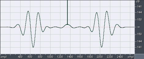

I use rePhase for creating linear phase Linkwitz-Riley 48dB/oct 80Hz high/low pass filters for crossover, sample rate 16kHz and 2688 taps. These I import into Cool Edit for inspection. Summation of filters produces ripple in tails:
This is completely avoidable if high pass filters are all derived from low pass counterpart via single sample inversion (subtractive filter).

The ripples you are showing occur at -144dB. I don't think it should be considered as a problem as is.
As the HP and LP will likely have different length and window, iterative optimization will give different result, so a subtractive solution would probably not give the best result for a given impulse length...
As for the ripples you showed me starting post #9 (low level ripples at the Nyquist frequency), I have found a way to reduce them using oversampling (and double the number of taps) and subsequent downsampling (with amplitude derivation being corrected during the fist iterative optimization step).
Not sure I will implement it in the next release though, as I would like to focus on measurement import first.
You may think it isn't problem, a simple one to fix. Calculation of high pass should be done buy calculating low pass and subtracting normalized value of one from peak sample. Additionally, linear phase version filters for IIR family is faster and more accurate to calculate IIR with 1/2 gain/slope, convolve with time reversed copy, trimming to desired tap count, and applying symmetrical fade in and fade out at ends.

Subtracting is not the way it is done in rePhase, so 100% complementarity cannot be guaranteed. But you know what you get when looking at the ripples, and frankly a -144dB complementarity error is not something that would worry me. How is the complementarity of the acoustic filters?...
You can also use more taps for the given frequency and these complementarity problems will go even deeper in level as the result curve will fit the theoretical one better (and theoretical filters generated in rephase are 100% LP/HP complementary).
