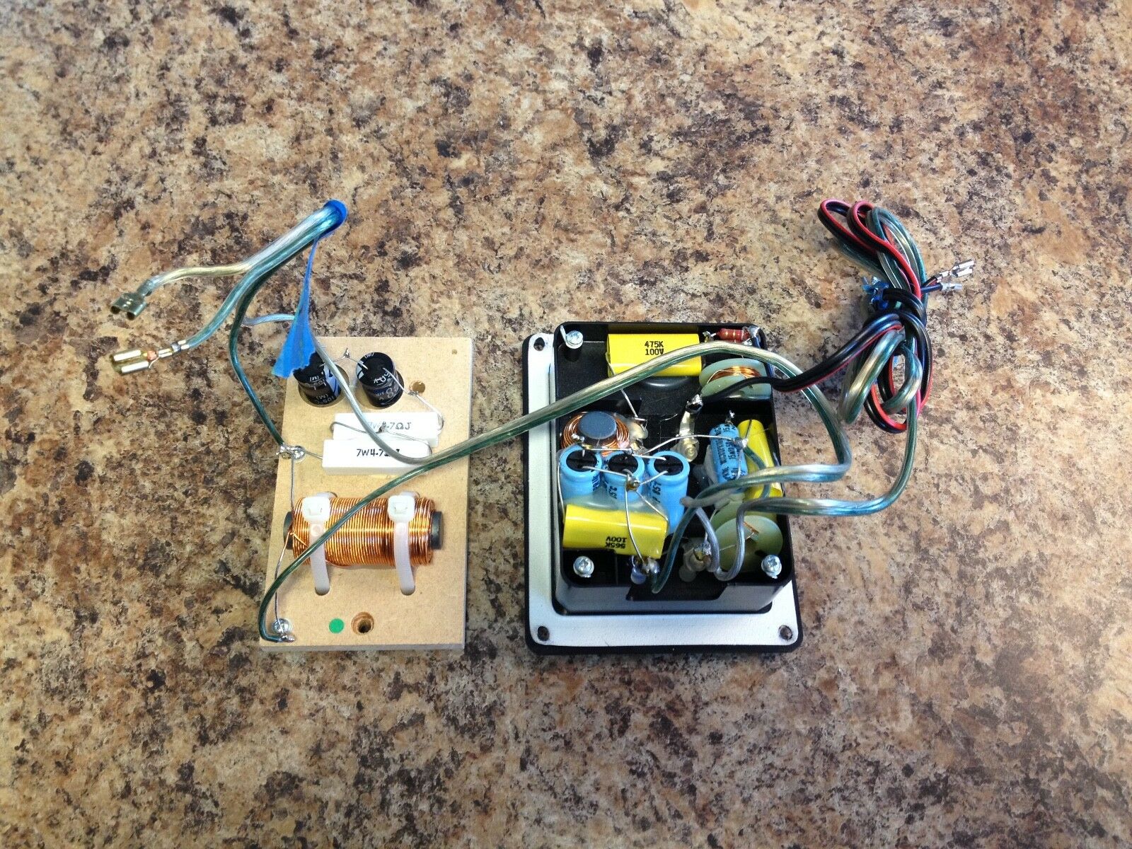

I've found this image of the Mission 782 crossover board, if it is of any assistance.
Thanks for that! It looks like that's the bass low-pass on the left board, and the rest on the right, wouldn't you say? Ferrite inductors and bipolar electrolytic caps, huh. Although there's nothing wrong with those components per se, it's hardly high end as some have suggested.
