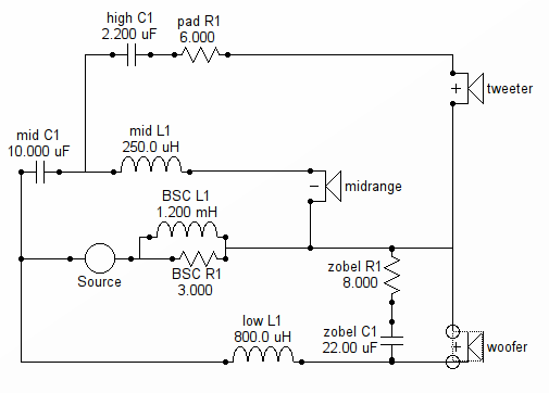

Physical laws. A capacitor makes phase difference +90° And inductor too -90°... The result is 180° difference, then to keep a good summation, you must invert the mid.Why did you put negative mid wire to positive woofer and tweeter wire?
DC resistance for the coil near or below 0.3 ohmsWhat parameters about coil? DC Resistance Max? 8ohm or no matter?
The crossovers are done for 8 ohms drivers and you have 8ohms drivers ? no ?

Note : in the second schematic you can adjust the midrange level by R2. You can increase the value (3.3 to 4.7) if you have too much mid. The crossover frequencies are 1kHz and 4kHz The overall sensitivity of the speaker is 90dB. It was my first tweak of a speaker using measurements.

Here's a diagram of what I was suggesting plus a couple extras that might be worth tinkering with...
Thanks mdocod
But it's a bit difficult (according to the amount of components)
note 2: in your schematic, the first, to adjust the level of the mid put a simple resistor in series with L2 C2, R2 to 2.2 to 4.7 ohms.
Firs schematic in my first message of this thread?
YesFirst schematic in my first message of this thread?

Another question, i have an amplifier with 4 to 8 ohm speaker conection (Right + left). If you calculate one 3 speaker system impedance in parallel, you get aproximately 2 ohm (according to the real impedance). Good for amplifier? Are you overcharging it? Right channel with 2 ohm and Left channel with 2 ohm too, according to measurements in parallel (1/8 + 1/8 + 1/8 = 2 ohm each speaker (All the box with 3 way system))

re:'you get aproximately 2 ohm ' - no, the crossover separates the impedance across its various freq bands, so it remains at (approx) 8 ohms
re:'you must invert the mid' - I disagree, here the components are for 1st order slopes at different crossover points, so no inversion.

Sorry you could be disagree but you are wrong...

When we use 1st order filters we usually have to invert driver polarity and this is how it looks when
we connect bass and tweeter with positive polarity and mid with inverted polarity:
Jerome,
Have another look at the ‘Prelude’ crossover. It is essentially a first order crossover on the mids, with quasi 2nd order on the woofer & tweeter. Normally one would invert the polarity of the woofer & tweeter; here, Troels has chosen to connect these in phase & invert the mid – same result.
Re: the ‘Greencones’, Troels himself says ‘Polarity of tweeter is dubious’

Pete no we don't read the same things
Look at the graph of inversion of the polarity of the mid to positive on the prelude, sure it doesn't sound good

Finally i invert mid truth?
I don't want to confuse you more, yes as i said you must invert the mid.
You are free to connect the mid with the same polarity ...
BTW what schematic will you do ?
This:
I have the components and its the best way for me
