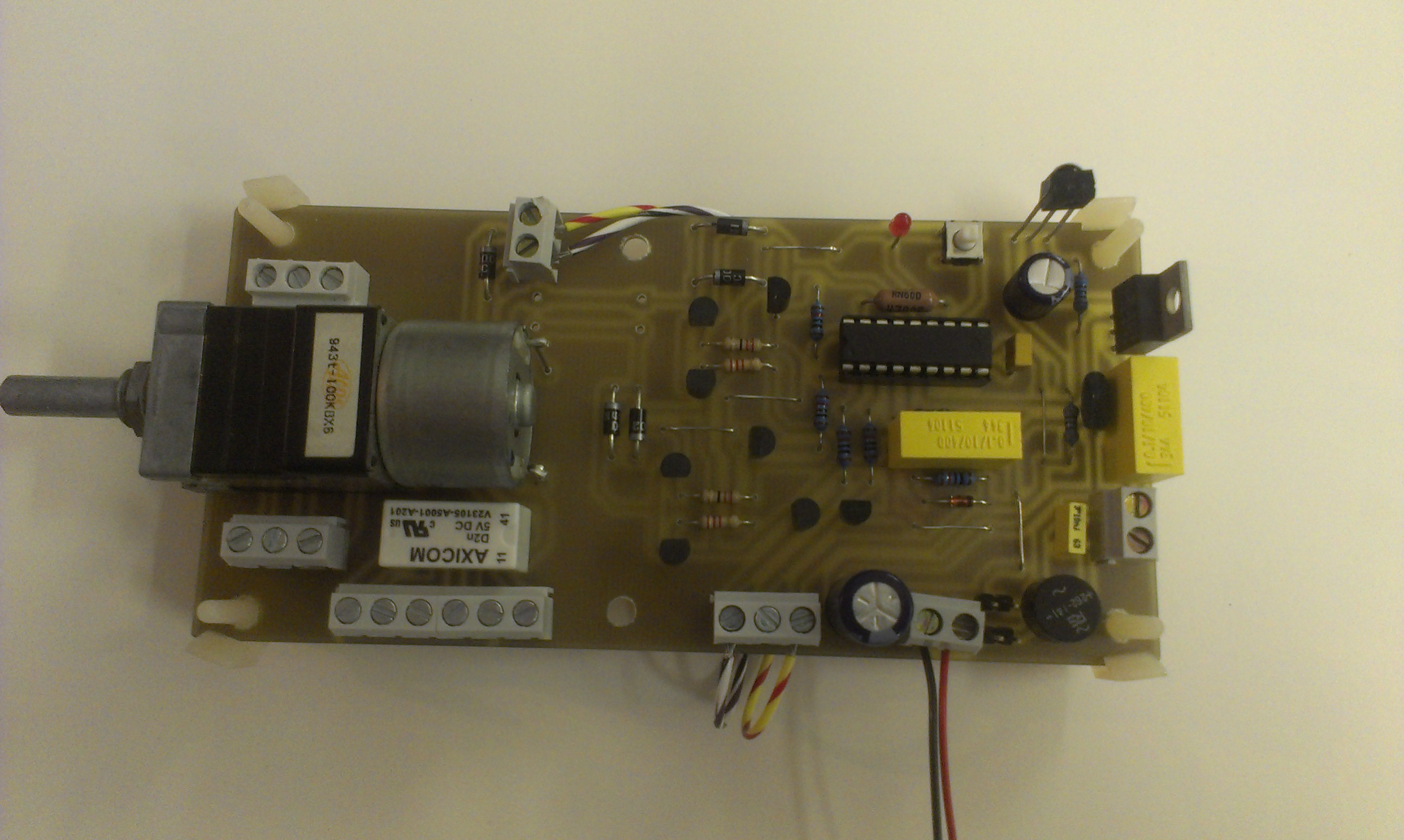

Hi Fotios
Ok, we are up and running....sort of
I will get some photos up shortly
The issue I have is that VR1 only turns in one direction and the mute relay will not work either with the remote or with SW1. I have not connected a relay to the power / standby connection as its not needed for my appliction.
I have used FCv5.HEX
Any thoughts?

Hi Dagwood.
First of all check carefully your hardware for any possible mistake. The FCv5.hex file you use (MOT_POT_RC5_FCv5.hex, right?), is configured for PIC16F88 microcontroller. Make sure that you use the same micro. You must use the command "Import File" of the assembler of your programming device, if you use "Open File" will loss the microcontroller configuration bits (osc. frequency etc).

Hi Dag
You refer PIC18F88 and i am sure that is a typing error of yours, you mean PIC16F88. OK, your micro is correct. I don't know (i will look on the web for it) your programmer "PICpgm", i just use two programmers the Matrix Multimedia EB006 and the Microchip ICD2. Both ICD2 and PICKIT2 (or the recent PICKIT3) programmers are managed by MPLAB ICD software and for this was my reference "use Import File and not Open File command". But i think "Load File" command of your programmer is the same with "Import File". Well, i will try again to program a PIC16F88 with ICD2 and with the HEX file i have uploaded in Matrix Multimedia forum (NOT this stored in my PC!)and i will confirm you if the file works correctly.
Transistor substitution you did is not problem, your transistors are OK.

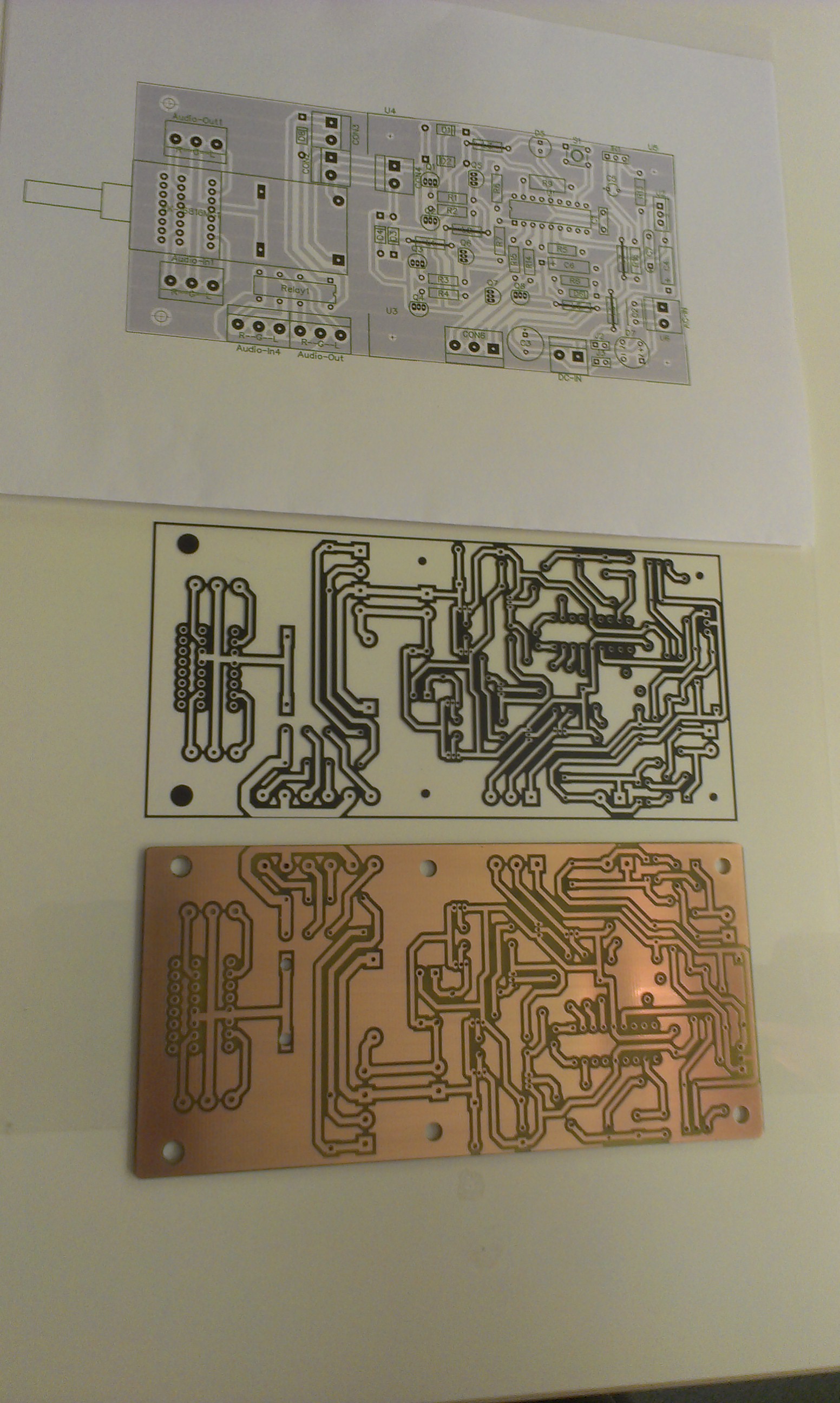

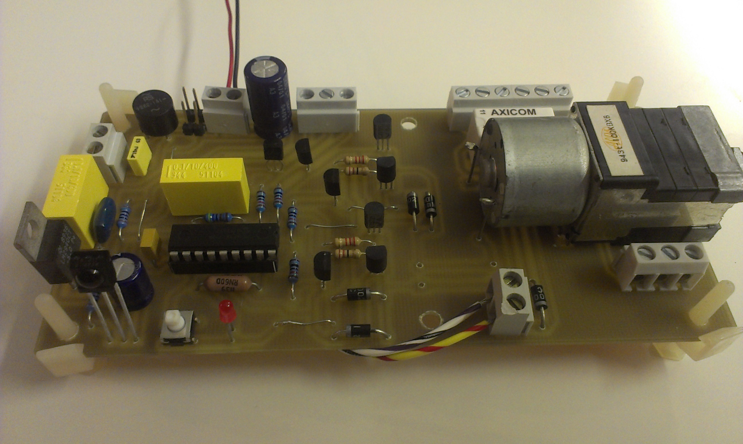

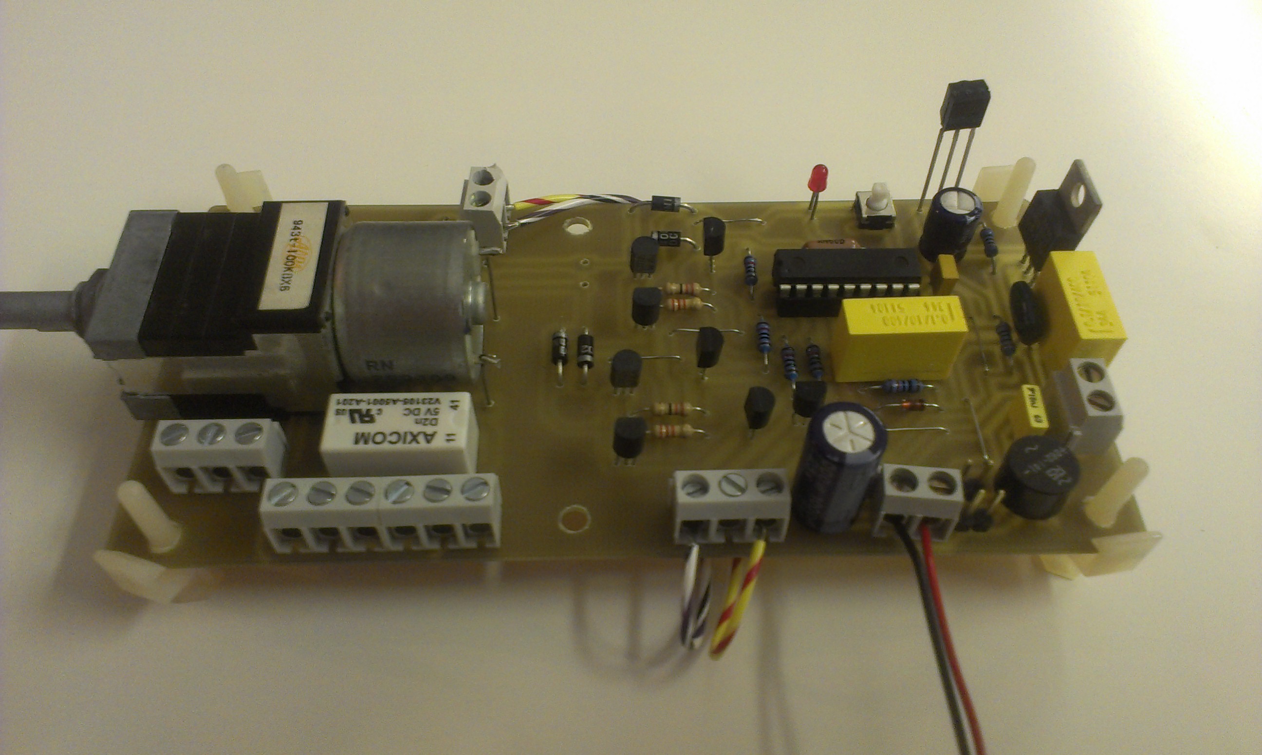

Hi Fotios
I'm away on business for a couple of days but will re-check all parts on Friday.
I have loaded quite a few programs using this programmer with no issues:confused:
photos attached:)

Hi Dag
Thanks for pictures, are very informative. I haven't time to check them at the moment, i will do this tomorrow. But from a first view (from those i can see) i think some tracks of "Reset" circuit are missing. I can't see the common connection node of R5 - C6 - R8 - D6. Check it please.
A very important thing i forgot to refer is that: When power is applied to circuit is automatically placed in STBY mode and of course the MUTE output is also activated constantly. You will be able to operate the MUTE function only if you activate the micro by pressing the POWER ON switch on remote control handset. It should be noted that the volume control function is independent in either mode STBY or PWR ON, it works normally in either state.
That's to the present.
Fotis

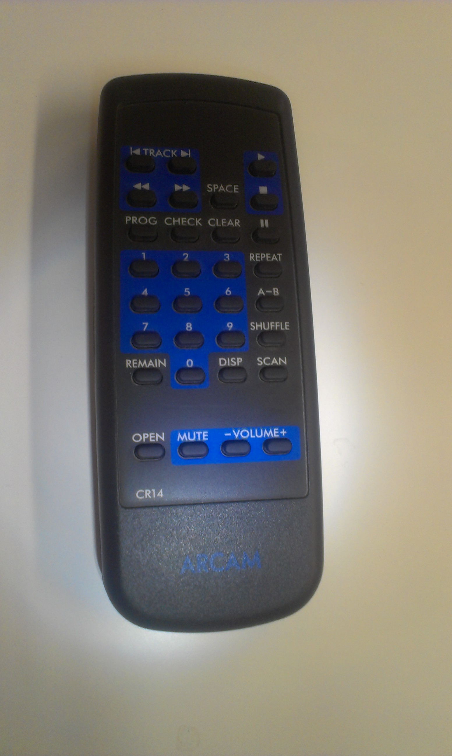

Hi Fotis
Ok...make that 2 errors! Doh. There is alotto be said for not working on stuff when you are tired:headbash:
Problem, my remote dose not have a power on button....any ideas:confused:

Hi Dag
Are Volume+ and Volume- functions working now? I mean, can be the motor of volume pot rotated CW and CCW using your remote control handset? Please let me know.
Regarding ARCAM remote handset shown in picture, is for use with CD or DVD player. If it can manage motor rotation in both directions then should be OK. You can make the following test to confirm that can also manage the MUTE relay. Solder a cable in GND (0V) node of PCB. Apply power to remote control board and wait until LED stops to blink. Then, carefully touch the other end of cable at pin 10 of micro, i.e. ground the PwrON/STBY input. Then the MUTE function should be permited.
Try this and if works will proceed in a program code change to use another switch of your handset.
Fotis
Hi Fotis
Yes, Volume + & - are working perfect ( my error)
Arcam remote is for Alpha 7 CD player
Tried shorting pin 10 to ground, still not working??

OK, it shows that your ARCAM remote is compatible with RC5 protocol. Try the following test:
1) Remove cables from CON6. Get 2 LEDs and screw the cathode (is the short lead of LED, the long is the anode) of each one in the terminals of CON6. Solder one 470R bleed resistor in the other terminal of each LED. Screw the other leads of both resistors at the +5V output of CON6 (is the first from the right side). Apply power to remote control PCB, the LED that is screwed at the left terminal should be lit constantly, that represents the MUTE output. The other LED that is screwed at the middle terminal of CON6 should be stay OFF and represents the PWR On output. Now, try again to ground the pin 10 of micro. The middle (PWR On) LED should be lit now, while the MUTE LED should be turned Off.
If this test works, then your hardware should be OK. Make please this test and let me know. Then i will try a search if the MUTE code is same for both CD and Preamplifier.
