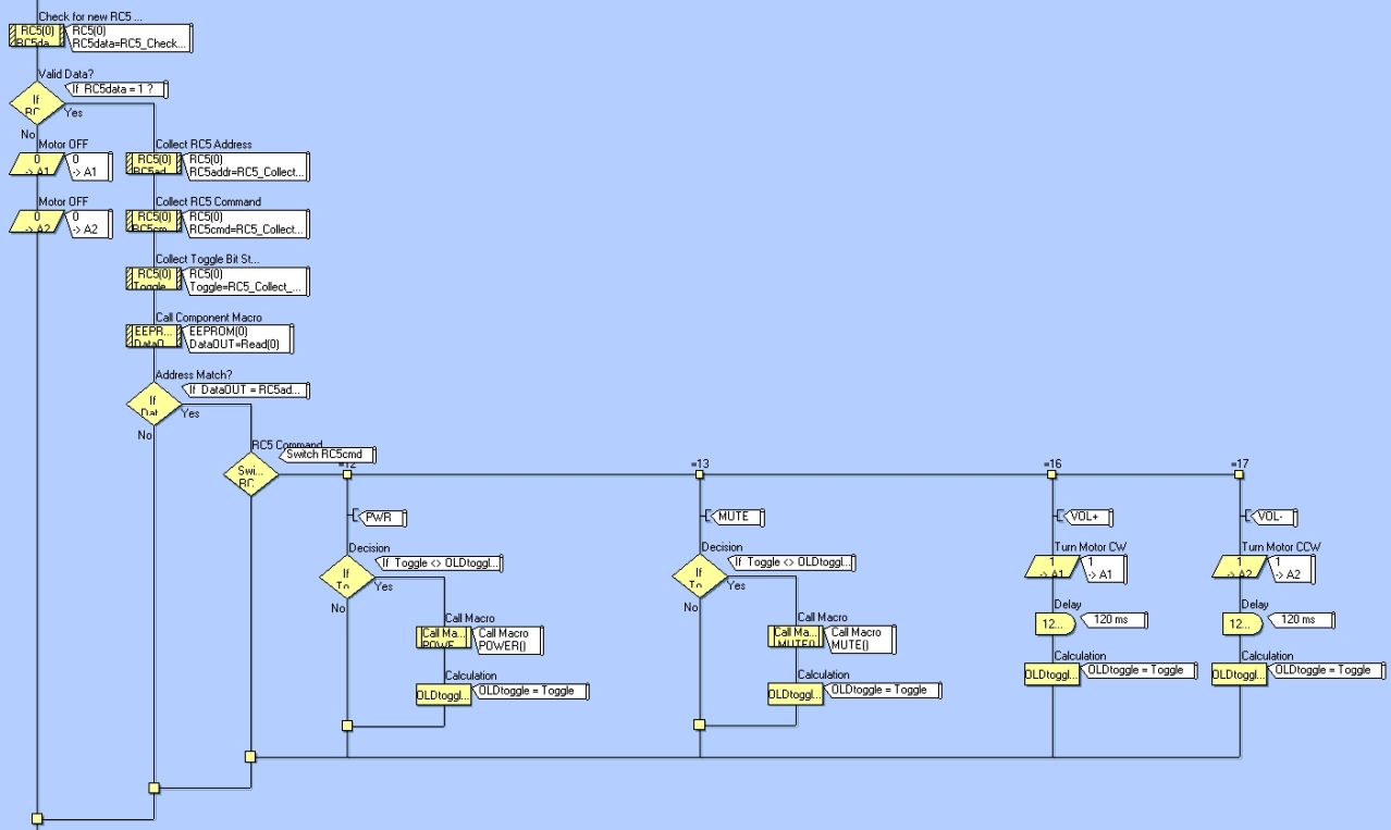

Of course, there are a lot of similar projects on the market that offered either like pre assembled units or like kits. Here the difference is that the HEX code to program your own PIC16F88 is FREE!
The unit is remotely controlled with the use of RC-5 protocol. A brief description of unit: It offers the VOL+ and VOL- functions plus STBY and MUTE.
The micro is programmed to communicate with any RC5 compatible remote control handset. Each handset transmits a unique address code, e.g. TV address = 0 and Preamplifier address = 16. To initialize the micro for communication with a remote handset, we have to turn off the supply of micro and then to turn it on again. Then immediately the red LED starts to blink fast 10 times. Within this time we have to press firmly the button mounted on PCB until LED stops to blink and remains constantly glowing and then we release the button. Now, and within 3 seconds we have to press firmly a button (MUTE is preferred) on remote control. If address has been stored successfully, then the LED blinks slowly 6 times and we can release the button. If we don’t press any button on remote control then the TV address code = 0 is automatically stored in micro and the LED does not lit. If the remote control is incompatible with RC-5, then the LED starts to blink fast for 10 times and in micro is again stored the TV address = 0. That is all. The internal EEPROM of micro retains constantly the address code that stored.

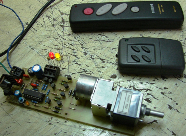

In the picture you can see that I have connected the IR receiver with a screened cable of 20cm to the PCB. This not cause interference or missed signal problems and, at the same time, offers flexibility in the mounting of IR receiver IC on front panel of device.

Hi fotios,
nice project.
Could you tell me how you managed the behaviour of the pot for single push/constant push oh the remote control ?
Thanks,
Max
Thank you Max
I hope you know some things about RC-5 transmition protocol. The process is based on the examination "If Toggle Bit flips state". When a button on remote control is firmly pressed the "Toggle Bit" does not change state, while if button released it does. In program code and for VOL+ and VOL- functions, the test "If Toggle Bit flips state" is omitted and a time delay of 100ms in the specific program loops prevents empty intervals between succesive train of pulses. So, as long as VOL+ or VOL- buttons on remote control are firmly pressed, the potentiometer is rotated continuously. When button is released the rotation stoped.
On the contrary, for STBY and MUTE functions "If Toggle Bit changes state" is taken into account in program code. So if e.g. the STBY button is firmly pressed, the receiver does not change continuously state. We have to release and to press again the button to do so.
Hope i was somehow understandable.

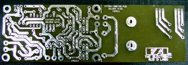

PCBs and microcontroller
Though i offered the program code free as a gift to diyAudio members instead a money donation to forum (is the same thing) some people asked me for availability of PCBs and pre-programmed micros. Most of them are users of "Lightspeed attenuator". For this use, there is no need for an expensive ALPS Blue Velvet motorized pot (23 Euro the lowest price on e-bay) or for the RK16 series (16 Euro). Recently, the well known for its quality BOURNS launched a range of economic motorized potentiometers for audio use. Mouser has stocked some values (10K, 50K) of these potentiometers for 9,50 Euro/piece. I allready ordered two pieces to try them. So, i will draw a second PCB with the footprint of BOURNS.
I think BOURNS will make the job pretty good.

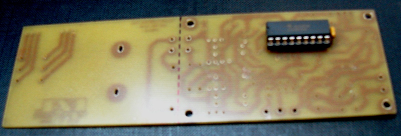

Well, I can offer you pcbs and micros in the less possible expense. To this, pcbs will be simply tinned - no solder mask, no silkscreen - for saving cost, like this on the first picture.
1) A simple PCB with the programmed micro mounted on it:
18 Euro + 4,5 Euro p&p (registered parcel) + 1 Euro PayPal fees = 23.5 Euro (see picture 2)

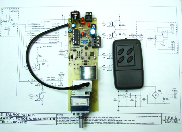

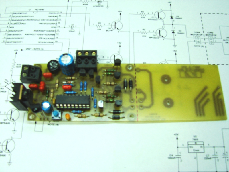

2) Ready assembled PCB (see picture 3):
30 Euro + 6 Euro p&p (registered parcel) + 1.6 Euro PayPal fees = 37.5 Euro
It should be noted that the PCB can be divided in two parts with the use of a blade. The one part is for the potentiometer while the other for the control circuit.

What kind of capacitors are:
C1, C4, C6 100nF
C2 10nF
C7 220nF
In the picture C1 is different to C4 and C6 despite them all having the same value of 100nF :confused:
C1 is the supply decoupling capacitor of MCU and so it is the usual multilayer ceramic cap = 100nF.
C3 is electrolytic, if your AC input is greater than 12Vac please use a 470μF/35V. It has same dimensions and footprint like a 1000μF/16V.
All other capacitors are MKT type.
BTW, parts marked as LK (LK1,2,3,4,5,6,7) are just wire links.

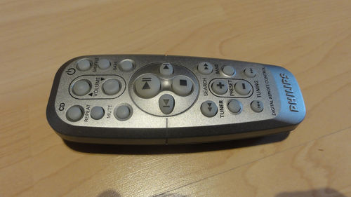

I got a remote control Philips RC 19420002-01 on yaBe for 1 Euro and it works just great. This remote has a different header to the TV codes and as expected does not interfere with my Philips TV.
This project was fun and painful at the same time. Next time around I think I will just buy the boards from fotios. The price is good and the concept is solid and professional.
