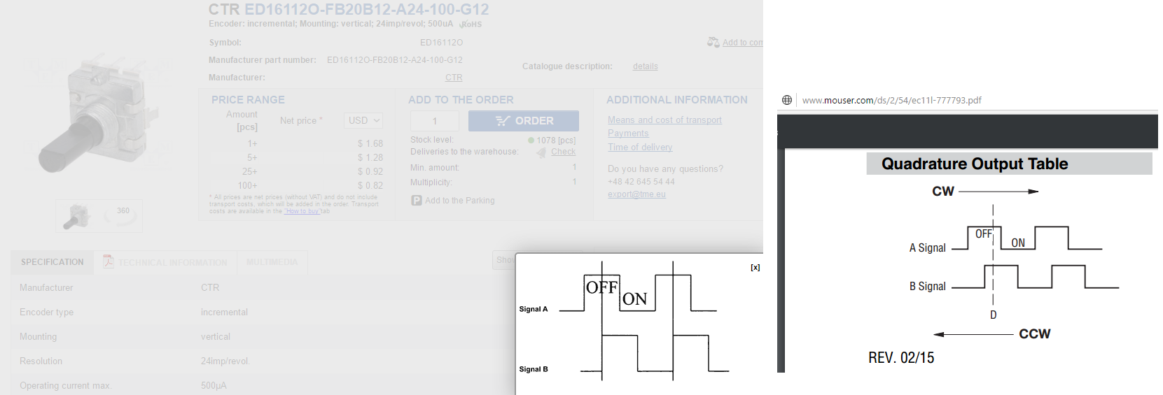

This one is much cheaper (2USD piece). Code should be same but it has 15PPR
http://www2.mouser.com/ProductDetai...GAEpiMZZMsWp46O%2bq11WctisI4PwQMvLIaNbNGpexI=
The effect of less pulses per revolution should be only the speed of volume change when you rotate the knob. I'm considering this as I'll probably use remote most of the time anyway.
I don't know how encoders work.output 2 bit Gray code, not quadrature or incremental."
What does this difference mean?
Gerben,
notice that your statement reads:
output 2 bit Gray code, ..... or incremental
The not tells us that the quadrature is different from the other two.
I think you meant to type:
output 2 bit Gray code, not quadrature, nor incremental." nor tells us that both quadrature and incremental are different from Gray code.
On a per-code basis, there is no difference between Grey coding and incremental coding. Incremental coding is 2-bit Gray coding which has been compressed and is repeated into a series of so called "clicks".
The main difference is that Gray coding covers the full 360° rotation, while incremental covers just one little portion of it and that sequence is repeated on and on.
Gray coding is perfect when you are interested to know where in the rotation you are at any one point in time giving a rotational indication for accurate positioning. This is what we want to implement in a future Maya firmware version. We want feedback from Maya to be sent to phone via bluetooth and accurately display several functions.
Incremental/quadrature coding indicate only which direction the shaft has moved and how far, not exactly where it is.
Hope this extra short explanation is OK.
Brgds,
Tibi

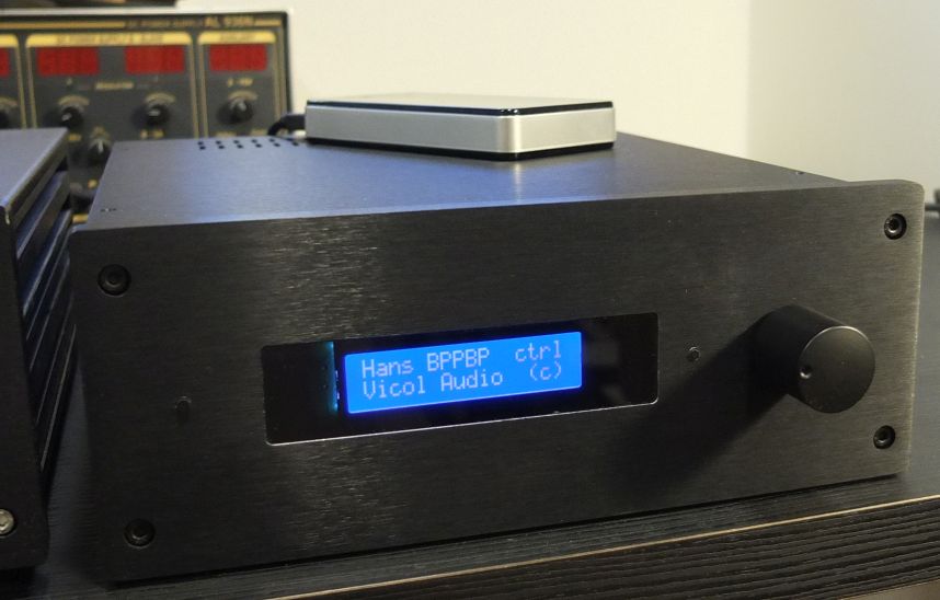

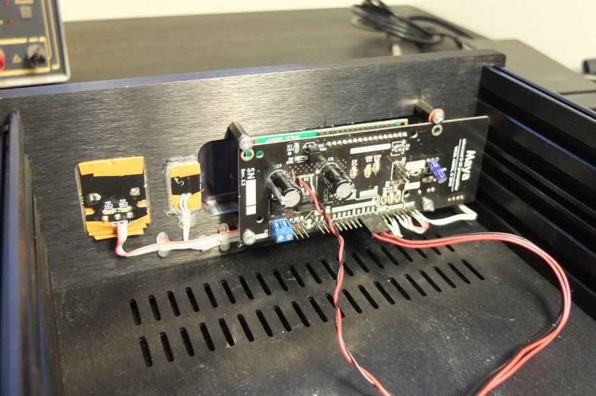

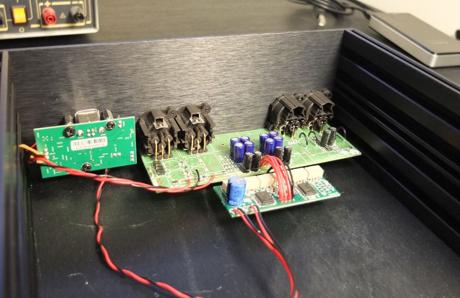

I have finally finished my build...
It's taken a long time. I now have a Bruno's Balanced Pre with Hans relay boards for volume, controlled with MAYA. Power is done with Jan's SilentSwitcer.
Listening results to come but I'm happy with visual and objective data. Objective measurements are a challenge actually - I do not have good enough equipment to measure this unit This will pair with the ICEpower 200ASC based poweramp.
Thank you to Bruno, Hans, Vicol and Jan for the various parts of this project! (Edit: ...and Xavier for original GB)

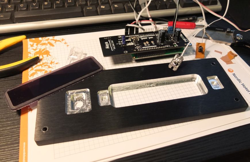

The 'small' is a bit relative here. The machine is a CNC Step High-Z 1000/T
https://www.cnc-step.de/en/cnc-machines/
Mine is 600x1000mm bed size but they have much smaller models also that would fit this type of front/back panel. It is a nice piece of German engineering and I've been very happy with the quality and precision.
Yes, the power goes in via USB socket, so I've been using a 5V powerbank for it. You see a link SilentSwitcher in bottom of jan.diddens message - that is the one.
