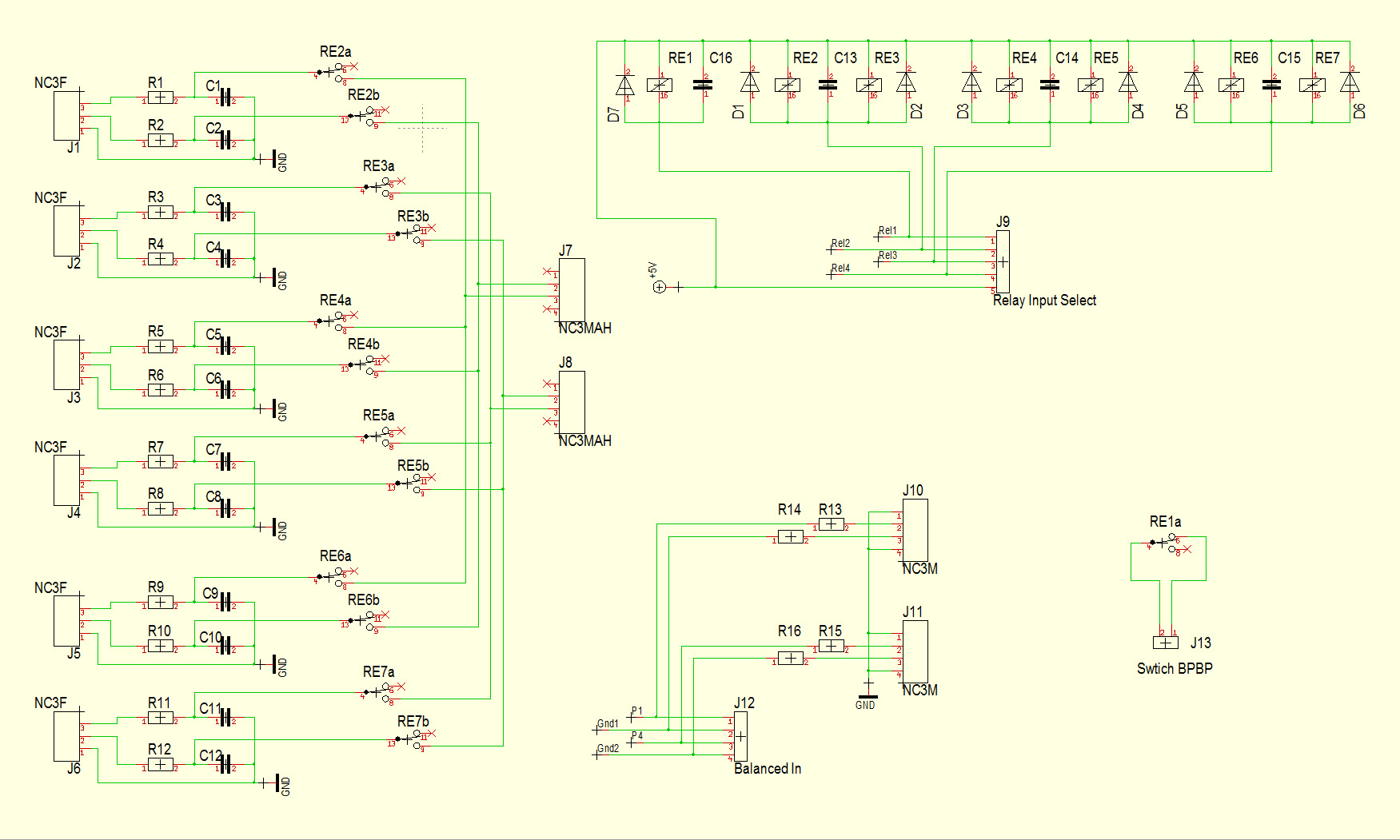

Here is the circuit diagram of the "4 channel remote PCB", rest to follow soon.
The working is as follows:
The middle XLR inputs on the BPBP remain to be channel 1.
The outer XLR inputs (the former BPBP channel 2) connect to J7 /J8 of the new boards, see the diagram below, outside the cabinet with short twisted wires, preventing to having to change anything at all to a fully populated BPBP.
J1/J2 on this new board are for Channel 2, J3/J4 for channel 3 and J5/J6 for channel 4.
J9 connects to the VolCB, for selecting the proper channel, J10/J11 are the balanced tape output, coming via J12 from the VolCB, and J13 replaces the channel select switch S1 on de BPBP.

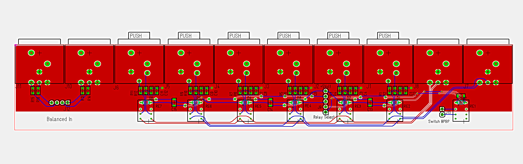

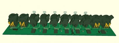

Here is the final PCB providing 4 input channels plus a tape output for the BPBP.
I have asked Tibi whether he could produce this board just as the VolCB.
But anybody could take the challenge to make a GB of both boards, this PCB and the VolCB.
The Gerbers are available.
The PCB measures 235 x 40 mm.
The text on the left `balanced in´ is misleading and should be ´Tape Out´.
Hans

Hi Hans,
Just found this thread. The solution with Maya it's really interesting. Thanks for your effort
As per schematic you post the input board is identical of the one I proposed in the 6 input GB. The only difference is that I use 12V relays instead of 5V you propose.
I take the chance to reassure everyone that join my GB that the board that they have bought is fully compatible with Maya board. At least is what I understand reading the posts in this thread but plase let me know if I am wrong.
A question about your new VolCB, with the normal linear 10K pot I can't go more than 2 o'clock rotation. After that the ampli go in DC protection. Is quite annoying but is safe! Maybe in your design you already taking care about?
Best Regards,
Enrico

Hi Enrico,
1) I have no details of your 6 input board, maybe you can send me a circuit diagram, then I can confirm if and in what way it can be steered by the VolCB and Maya.
2) There are no 2 o'clock issues with the digital vol pot, because gain goes from -57dB to +6db.
Hans

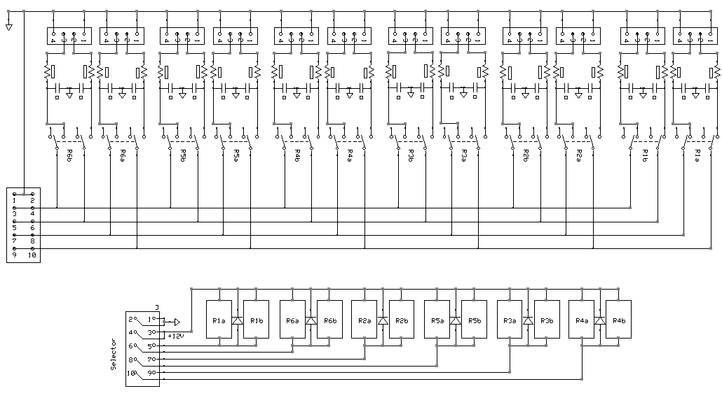

Hi Hans,
Thanks for your reply and for the really good news about the pot.
Attached is the schematic of the 6 input board, not really professional but I hope understandable. Anyway looks similar to your schematic, the +12V (that I take directly from the BP board) is fix to the relays's coil and the switch is done through a 6 contact rotary switch to the GND. The input parts are installed on board near the input.
I am curious about the J7 and J8 in your board. As far I understand looking in the 3D you post here all the 8 XLR are installed in the rear panel and in the rear panel there will be also the 6 original XLR from the BP board. The 2 XLR of the BP input 2 should be connected to the J7 and J8 of the additional input board. If I am right this mean that we have 14 XLR in the rear panel for 4 input (input 1 from the BP and the 3 additional) and all in line. Maybe I miss something?
Best Regards,
Enrico

Being able to use the 6 input board with VolCB would be excellent.
@Hans
In simple terms, how does the input select work from the VolCB? Does it have a 6 way relay which will select the input relay directly, or does it cycle through each input relay one at a time? I just wanted to know for knwoledge's sake, not for a practical reason.
On a different note, is there such a thing out in the world as a simple I2C data transmitter which will respond to simple control like a data wheel and send data to a single, selectable address?
I ask this as I will want to implement a second variable output but one which does not need to be remotely controlled. Your VolCB gives a better output range so is there a way to control only volume level with something simple like a manual data wheel or even a set of DIP switches?
Best Regards,
Enrico
My understanding is that the 4 input board sits as a separate board, perhaps even in a separate box. That way it can be added by anyone already using their bppbp as a two input preamp with no changes to the original board.
I'm sure that anyone who wants to and hasn't yet installed their bppbp can instead solder wires directly to the bppbp and extend the bppbp's outputs to the rear panel.
I am not sure about a separated box. As far I understand the Maja board will control the inputs and the volume. So there will be a connection from the Maja to the BP preampli for the pot and another connection for the additional input board.
Ah yes, the Maya and VolCB would be in the same box as the BPPBP (so just front panel change addition of the Maya and VolCB boards internally). But the 4 x input board looks to be designed as an expansion board for BPPBP's Input 2 with I2C input select from the VolCB (originating from the Maya).
As an expansion board, it leaves the BPPBP components alone and so can be used both in a separate unit or within the same box, as the user wishes.
I just looked again at Hans' 3D rendering - indeed it is only a 3 input expansion board so requires Input 1 on the BPPBP to be considered as the one of the inputs.
That is slightly different from your 6 input board which replaces all the BPPBP's inputs and output entirely and is should be considered to be integrated by the designer from the very start (as I will be doing).
Hi Hans,
The VolCB has 6 outputs, so yes, your board can be controlled by Maya, but only when 5 Volt relays are used, since the I2C chip on the VolCB cannot handle 12 Volt.

The 5 XLR pairs on the "4 Input Select Board" are resp.: Tape Out, Channel 4, Channel 3, Channel 2 and output (J7+J8) to connect to one BPBP input.
The BPBP will keep Channel 1 and the Main Output. Former Channel 2 on the BPBP will be connected to J7+J8 on the 4 Input Select board.
In total the backpanel will show 8 XLR pairs: 5 on the "4 Input Select" + 3 on the BPBP, giving in total 4 Input Channels, 1 Main Output and 1 Tape Output.
The two pairs connecting the two PCB, are making it possible to leave a fully populated BPBP unmodified.
@Hans
Selecting an output to switch a relay is performed directly from a I2C chip, in this case a PCF8574.
To control a I2C chip, you will need a CPU, a simple replacement is not possible.
Yes, by simply removing (or not mounting) the volume PCF8574, you have direct control over the 6 steering lines to select any code between 0 and 63.
