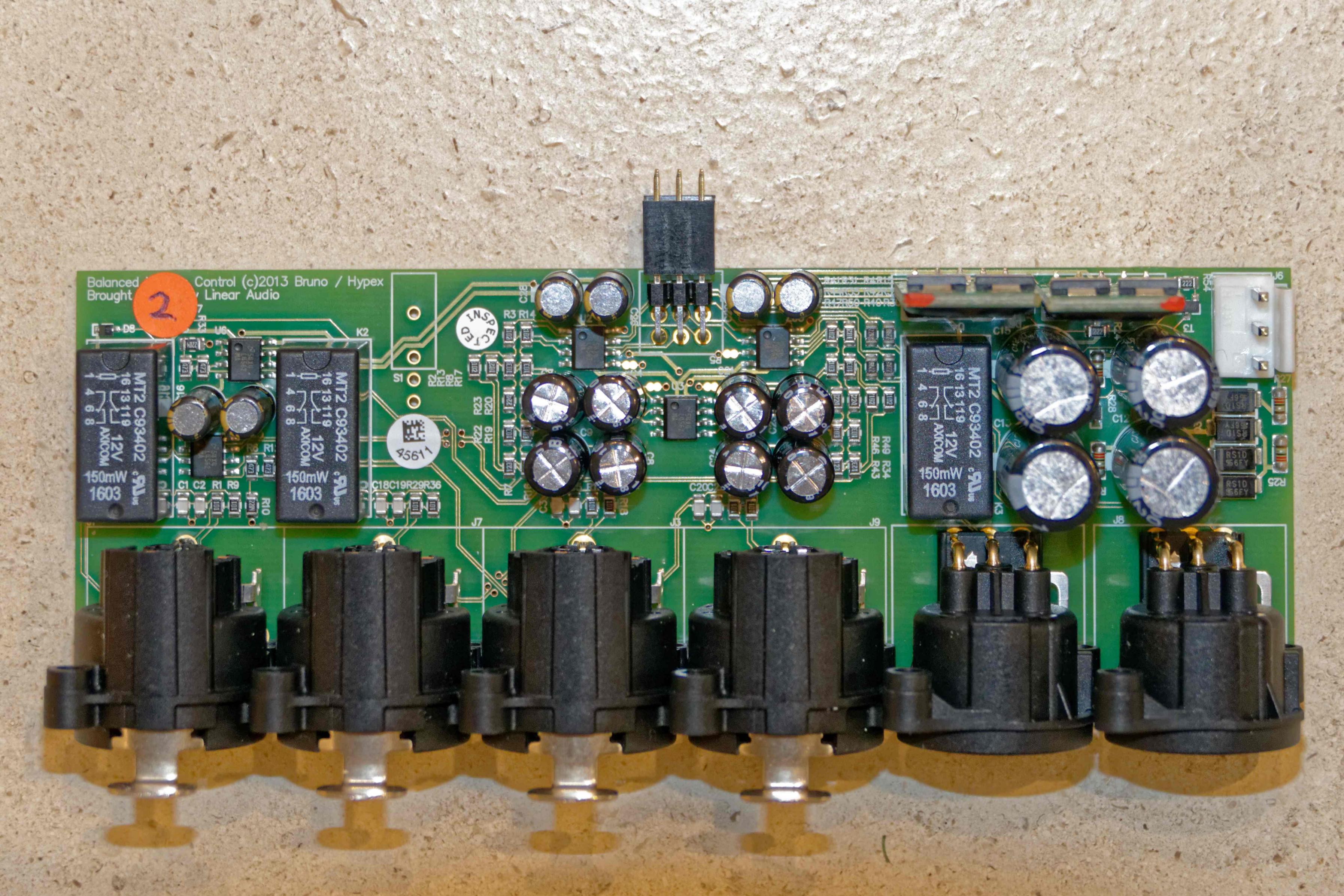

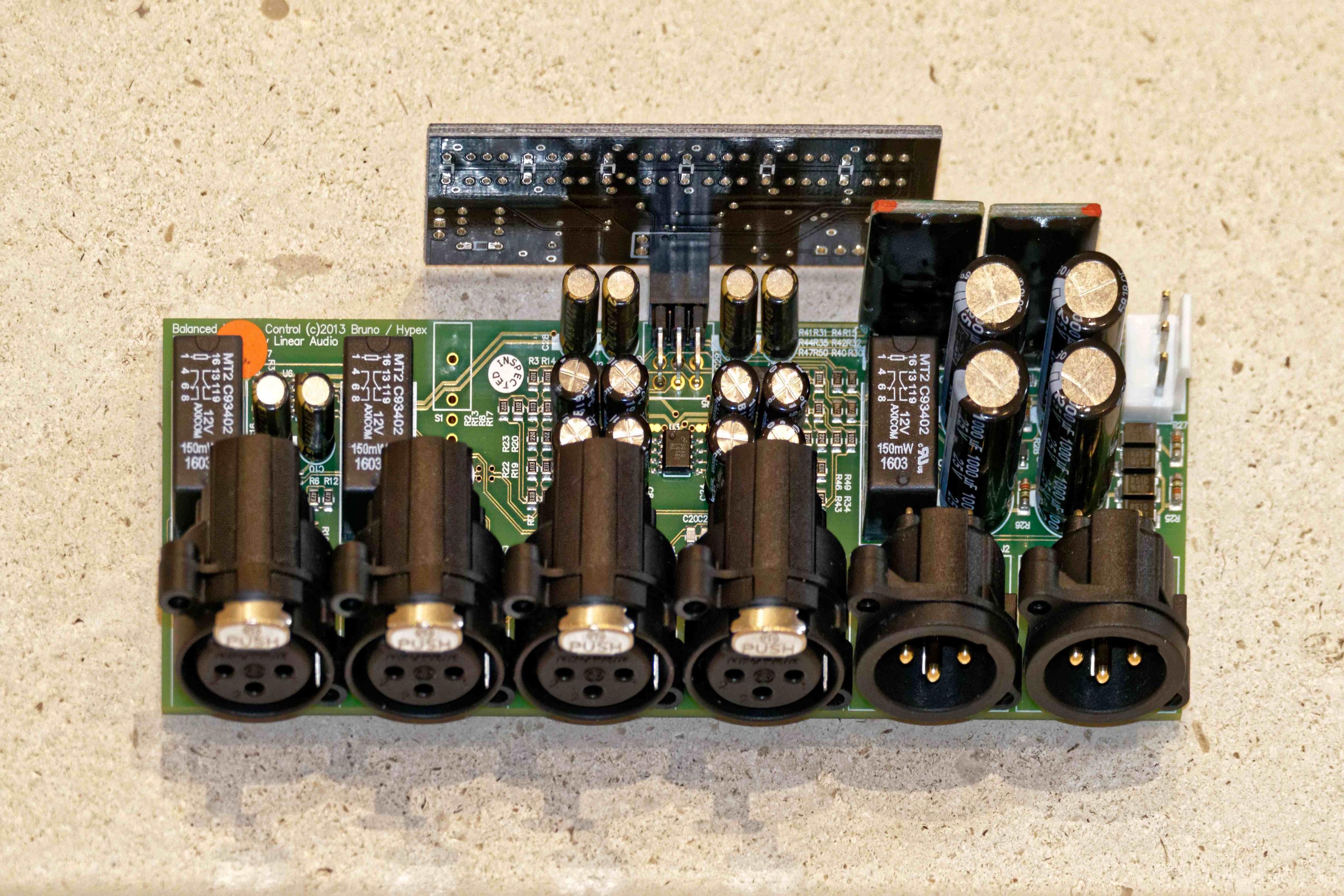

Anyone have an idea how to mount the VoICB board from Hans P. ?
It doesn't have mounting holes, thus chassis mounting seems not to be possible especially because of its rather "compact" dimensions.
Because of those Hypex regulators "overlapping" on the left using dual row "very long" pinstrip headers (>30 mm, dual insulator) soldered in place of the 10 kOhm pot, as suggested, might be possible, but will restrict access to those BPBP components directly underneath it, which I don't like. Note: The VoICB is then sitting "on top" of the BPBP. Otherwise one has to unsolder the VoICB before getting at those components and locations located underneath it. Height might be problematic too...
Any 90° mounting done without those Hypex regulators getting into its way either ?
This way the VoICB would sit right in front of the BPBP (vertical orientation) centered in front of the 10 K pot location.
What available hardware / connectors did you use for this ?
I tried a 90° dual row pinstrip header (pot location) for this already but it doesn't fit (to short) having the VoICB conflicting with those Hypex regulators on the left (again).
May be any pictures available if done so ?

I bought the Maya controller with your VoICB stepped attenuator board from vicol-audio.
I admire the layout of that densly packed PCB but after a closere look have two "wishes" for a board version 2.0, if there ever will be one:
1) the placement of those direct "pot replacement connections" (6+2) is unfortunate, because the Hypex regulators are in the way making it necessary to have the PCB rising quite high above the BPBP board overlapping one of the Hypex regulators. If that connection would have been placed somewhat further left the VoICB would have fitted snuggly just above the small electrolyte capacitors and relays etc.
2) extending the PCB even further right would allow added mechanical support (and direct connection) to that input toggle switch connections underneath. Additionally another relay + resistors could be added then to increase the resolution of the stepped attanuator to may be 0.5 db (128 steps).
Just my thoughts (and suggestions)
Thanks for the suggestions.
1) I mounted the volCB with an angled board to board connector, soldered on both sides.
And since the Vol board is very light, no further support was needed with this firm connection.
In this case the VolCB is standing vertically before the BPBP board.
2) The JND (just noticeable difference) lies at ca. 0.7dB, so having 0.5dB volume steps does not make much sense.
Therefore 1dB steps is as low as you should go.
Hans

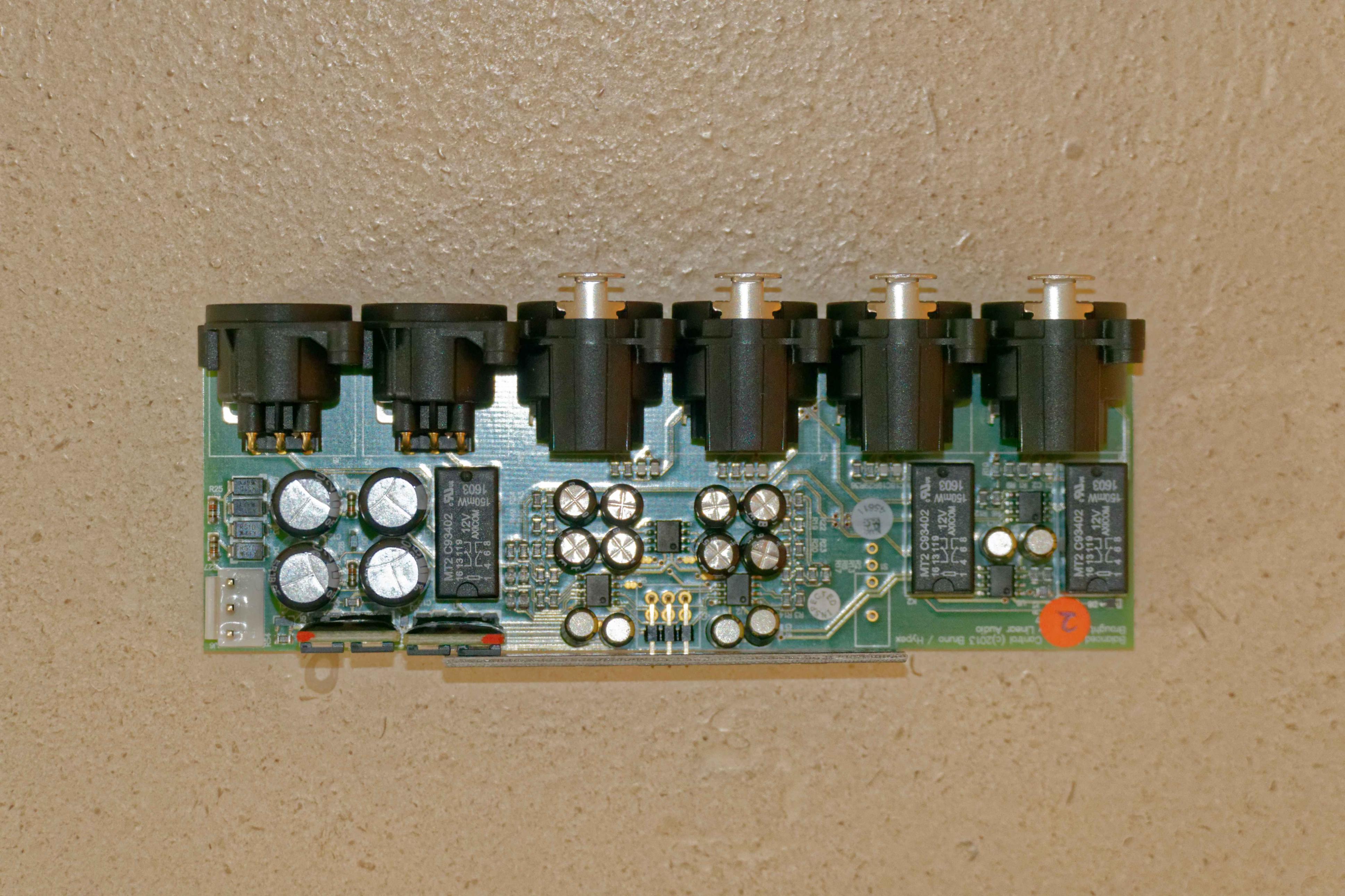

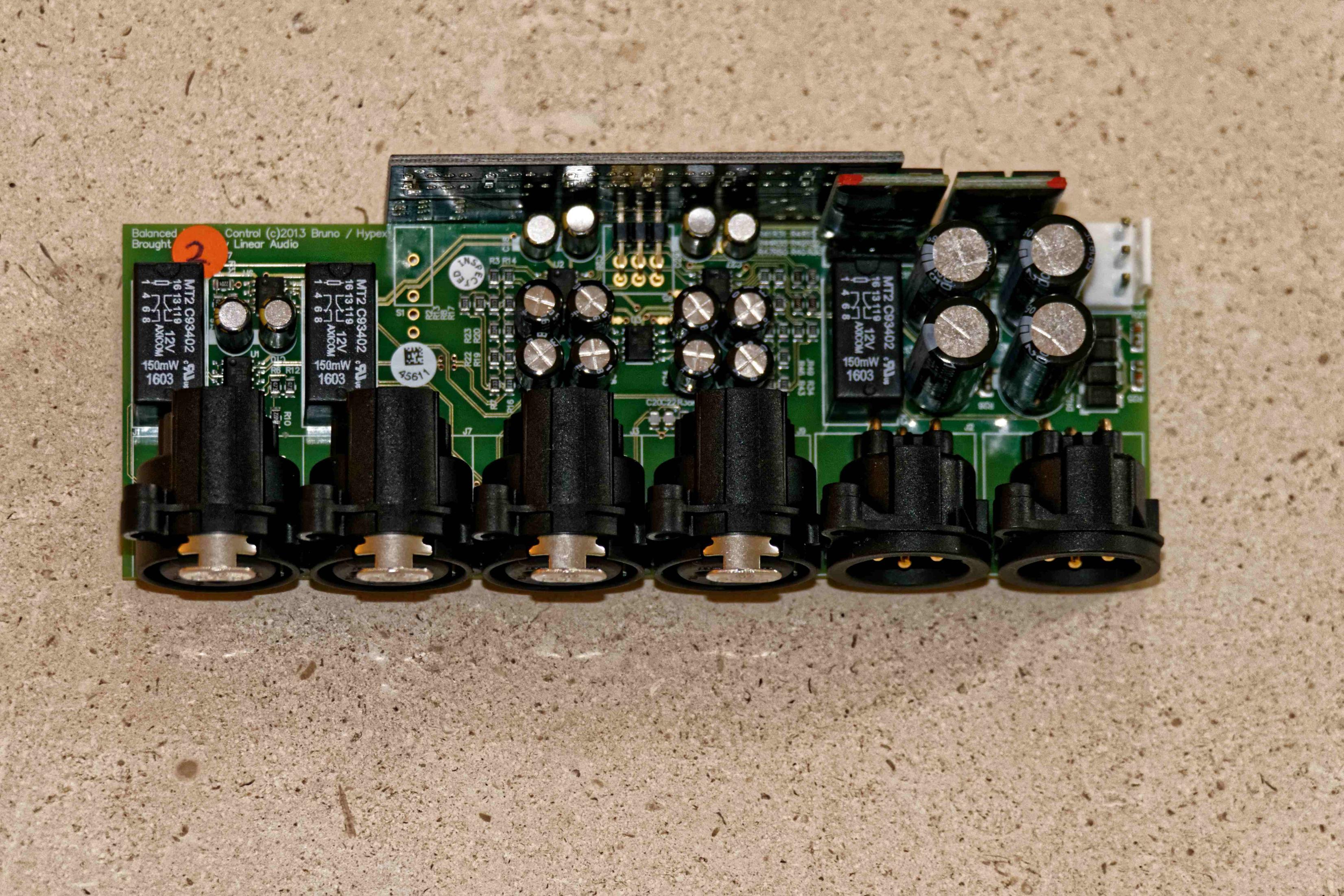

Refering to that suggestion of mounting the VoICB I tried exactly what you suggested, but with seemingly different results.
I doesn't work in my case because the 90° pinstrip header I got and which seems to be the only size (length) available is just to short (I couldn't find any longer ones on the internet looking at the database of several major suppliers).
In my situation using the method and part(s) you described the VoICB (almost ?) touches one of the Hypex regulators (right one - 2nd picture), especially if you realize, that the through-hole parts like the relays haven't even been installed yet, which should complicate the situation even further.
To illustrate it, I made several photos of the situation (attached).
Just wondering what you have done differently...
PS.: Any parts reference for your connector ?

Instead of mounting the Hypex regulator under 90 degrees on the BPBP, it can be mounted leaning quite a bit backwards, giving more than enough room for the VolCB.
I think you used a correct angled header, but longer versions are also available, the Samtec HTSW-103-25-G-D-RA, available from Farnell.

Unfortunately I dont have an account with Farnell and Mouser doesn't offer it. But I checked the German supplier Reichelt (www.reichelt.com) and they are offering something similar which I ordered right away including a matching femal header too.
Today I got the package and it fits. Two variants can be constructed this way:
- soldering it to both boards (BPBP, VoICB) using just the male header
- soldering it to the BPBP using the male header and soldering a female header to the other side (VoICB), making it removable this way and extending it by about 2.5 mm further out.
The part numbers are:
- male, 2 row, 3 pins each: MPE 088-2-006, price: ~0.17 EUR
- female, 2 row, for 3 pins each: MPE 094-2-006, price: ~0.24 EUR
The matching pin length is about 8.x mm. This provides enough clearance for the Hypex regulators and holds the VoICB firmly attached.

Attached you will find some photos about what I described above:

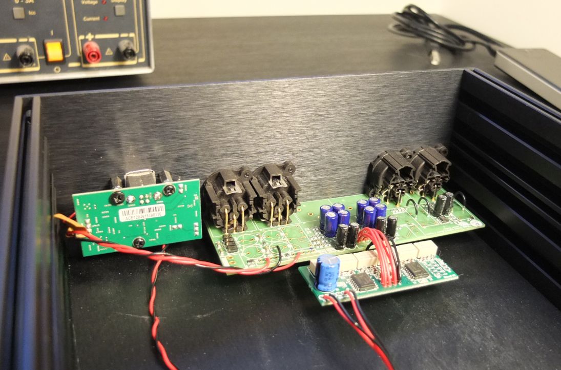

I "need" to add unbalanced RCA inputs and outputs for this to be compatible with my old design. What is your opinion on how to connect the unbalanced input?
You could replace your interconnects and leave the inputs all balanced.
RCA connector - balanced/twisted cable - XLR connector
This is what I'd be inclined to do
Yes, that is what I am doing. I will have 2 XLR inputs and XLR outputs fitted on the 15x10cm PCB and options for another input, XLR or RCA, and RCA outputs to be wired to panel-mounted connectors.
I needed to change my layout when it was almost ready but should be finished with it this weekend. 4 layers would be nice when having the microcontroller circuit as well but will fit it in 2. 4 layers become quite expensive after 10x10cm. Expect updates and performance measurements at the end of May. The first board will be the preamp in my PSU - DAC - PRE - AMP headphone setup.
