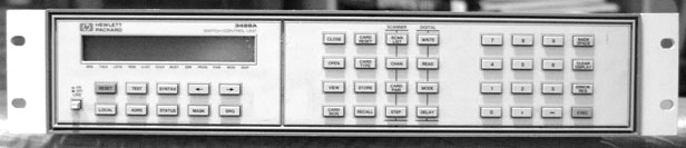

Why make when you can buy cheaper
and with a lot less effort. Below is an HP3488a switch -- these go for about $40 on the Bay with a card or two. (Originally they were about $3400). The 44470A relay card will switch 10 signals from up to 250 V, you can fit 4 cards in the switch. There is an analog card, a breadboard card, a video card, another relay card etc. It can be programmed over the GPIB/HPIB buss using a National Instruments card. You get a very high quality board, gold plated to the usual HP standard, excellent power supply, rack cabinet etc. They are inexpensive since they were used by companies like Cisco, Lucent and Nortel and a lot of this stuff is just disgorged onto the market. <p> Of course, the XYL factor may dictate that HPIB cables and PC's be kept out of the listening area, but this rarely stops DIY'rs. I daresay that you could probably fit an entire preamp within the space and provide all the controls with the 3488a (channel switching, volume, record, mute etc.)
