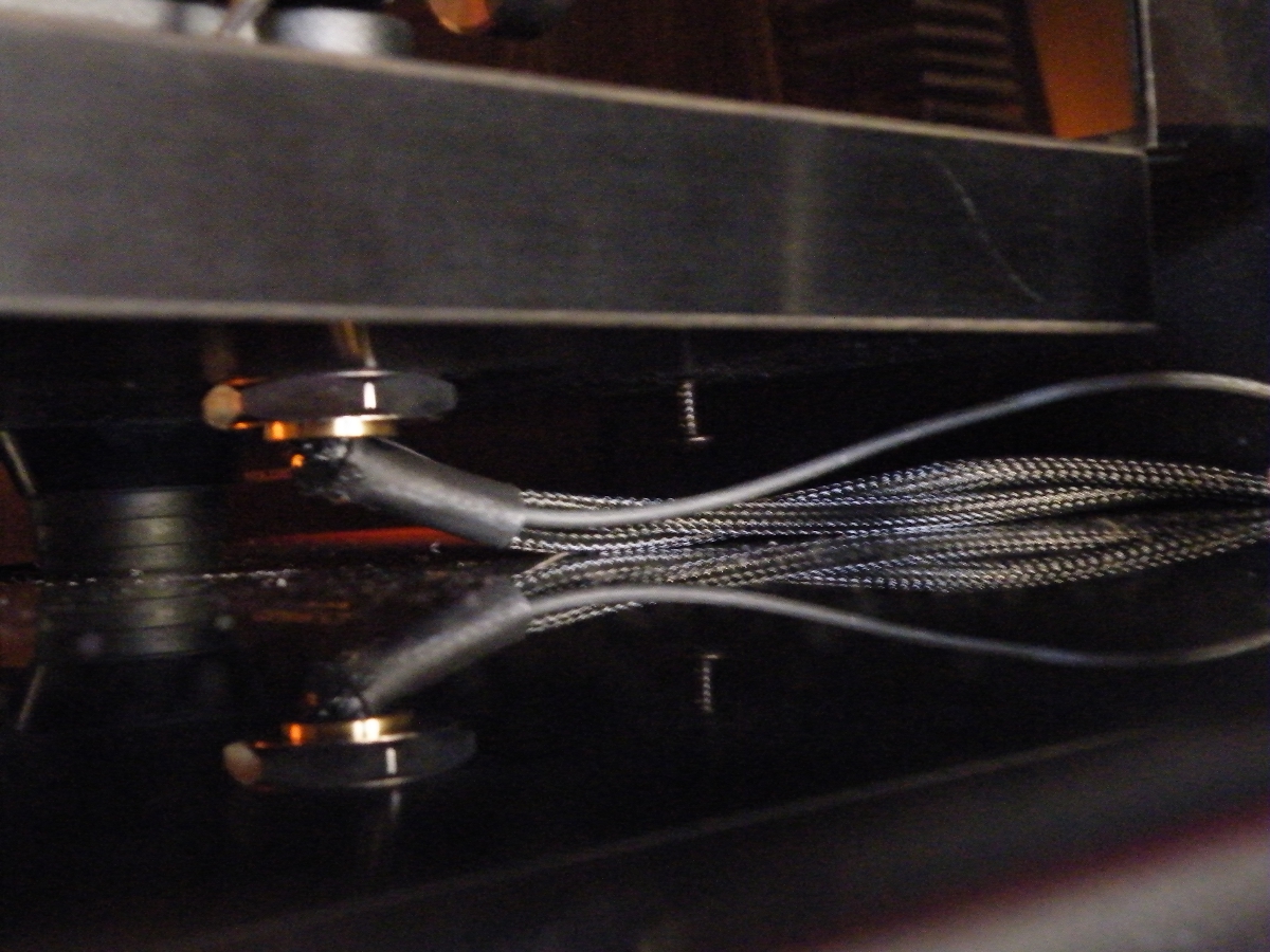

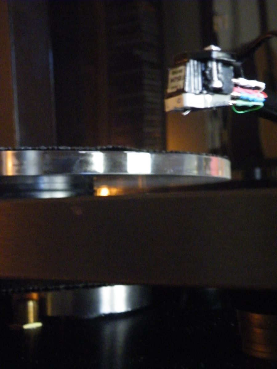

Hi, I originally posted this in another forum, but felt members here may benefit from this also, so I am re-posting some key elements in the processes I used.
I just rewired my RB300 tonearm, with Isokinetik silver plated wire (Cardas cartridge clips with Mundorf supreme silver lead free solder) : straight loom to the phono preamp..., and finished making a custom 3kg disc to mount the motor from the Rega Planar 3 on. I also dampened the tonearm with 7 expandable earplugs, and put 2 very thin slithers of earplug foam inbetween the spring coils in the weight adjustment part of the tonearm (they ring like a bell), while it was set at 3.5g (maximum-opens the spring up totally) and then set the weight via jewellers scales - leaving the setting at 3.5g.
I have NEVER heard a Rega sound soooooooooOOOOOOO GOOOOOD...!!!
Extra wide soundstage, depth, transparancy, black-silent background, detail, with a laid back clarity...yet so much PUNCH and tight bass....
...and its still in the initial hours of being 'burnt-in'....I cant tear myself away from it.....I also have a ruby bearing in it, and acrylic platter. In the lead base, which I made from a jar stainless lid, I drilled a hole, got a paper-mate biro pen, and took the spring out, cut it in half, and put it in the hole, and used the steel bearing I replaced with the ruby one, for the platter, and used it for a 'thrust bearing' as part of the lead base.....
...man, what a rewarding effort...., some tracks evoked pure emotion....WoW
... I still need to finalise a few minor points...ie: ext-cable clamp, 3 point mini-feet on base etc...,
... that is an 'ancient' Shure M75EJ Type II on there with a near-new Swiss Huco Hyper-elliptical .2 x .7 stylus...The Nagoaka MP-200 is looking like a good cartridge/stylus....for future consideration hmmm

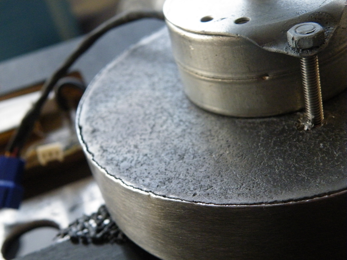

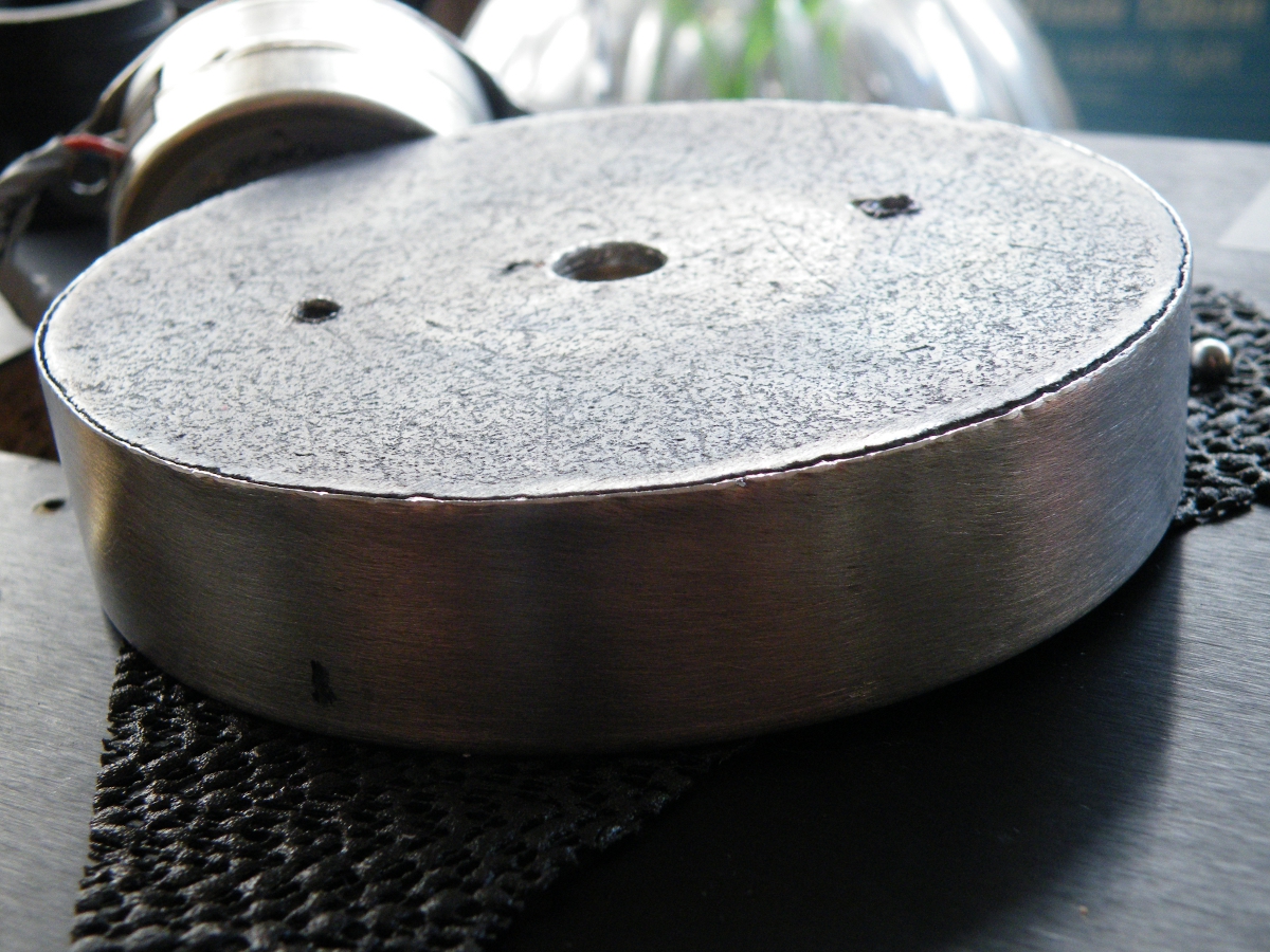

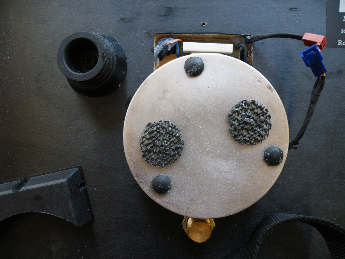

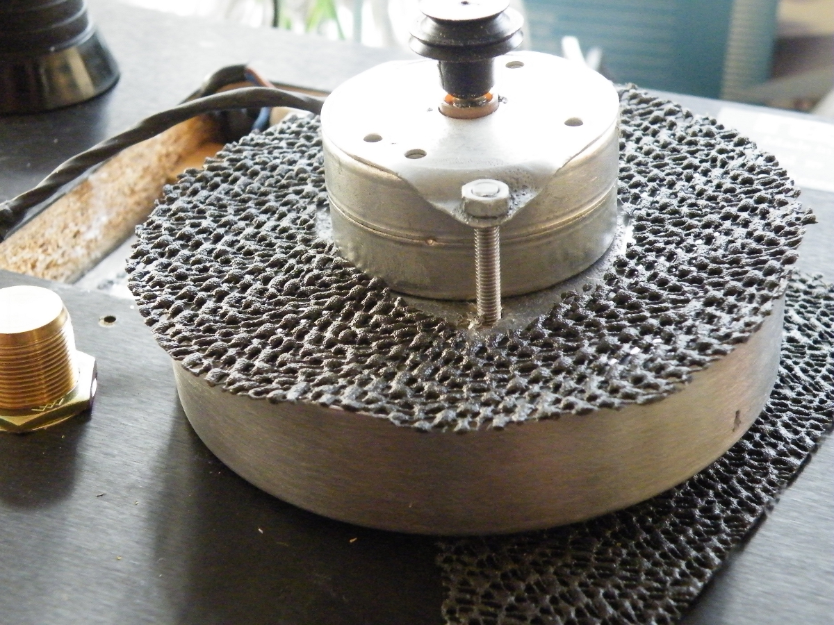

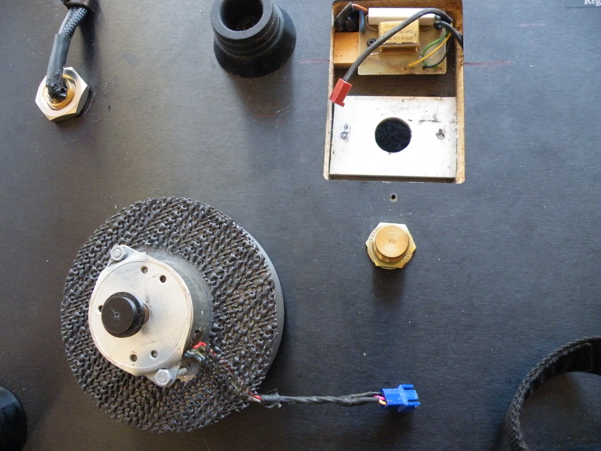

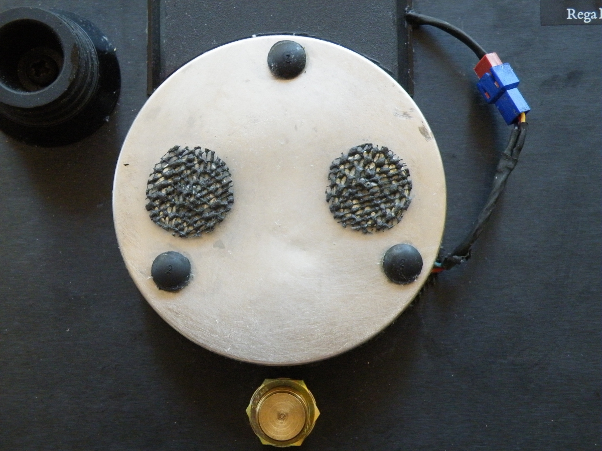

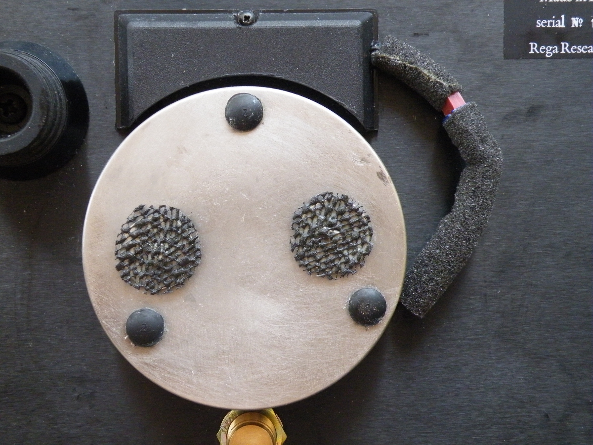

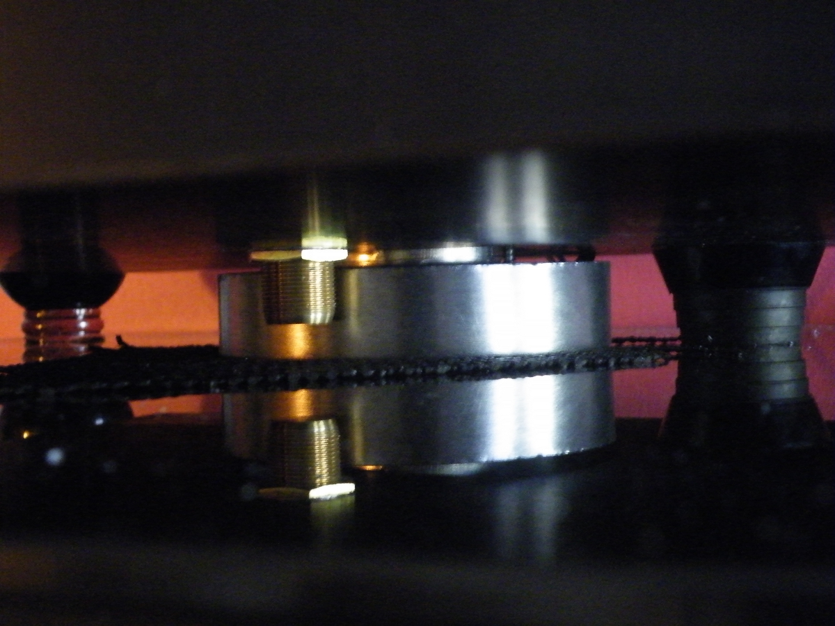

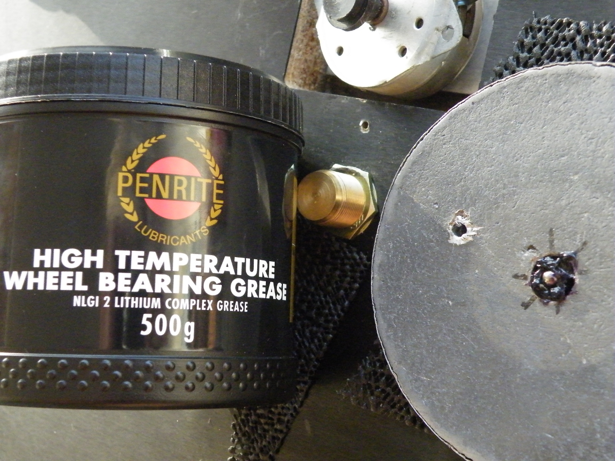

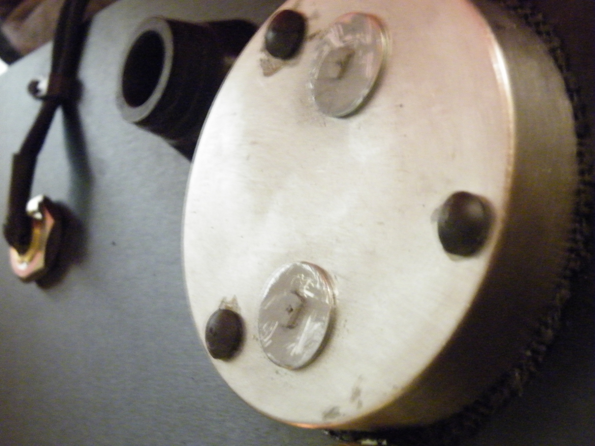

Motor Isolation

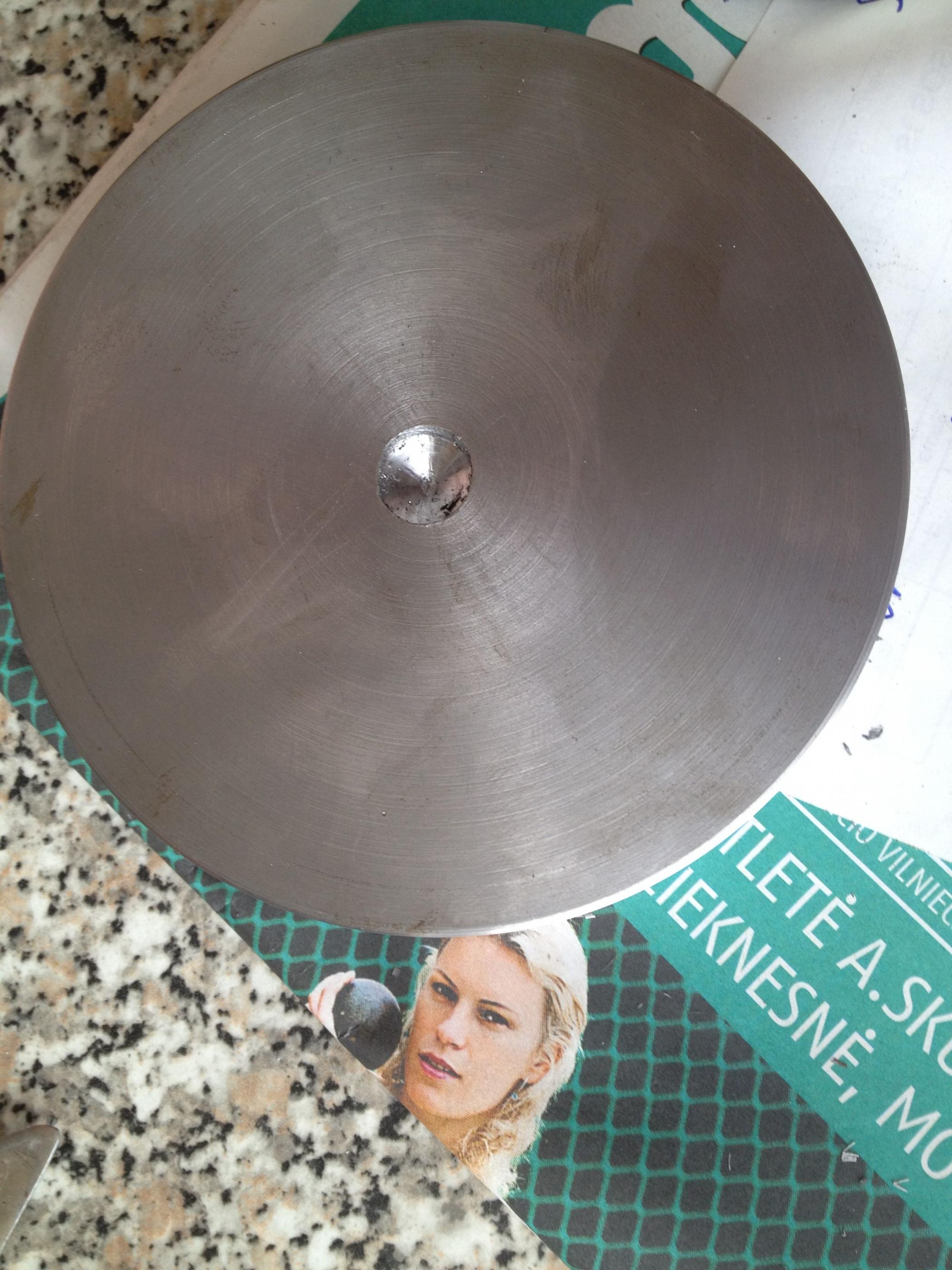

I isolated the motor completely from the plinth, by pouring about 3kg of molten lead into a stainless steel lid, and when cooled, flattened the surface, and bolted the AC motor on the lead base, incorporating a 'built in' thrust bearing situation in the base itself
The leaded base was an idea/thought I had at the time, which occurred when I purchased 2 x slate slabs for a custom Rega Planar 3 I am going to make. Most use the 2nd slab for the motor assembly, however, I don't like the complex look/weight of it all.
One 30mm slate is much more elegant and solid looking. I considered using a 'core drill' to drill out the part for the motor assembly, and have it mounted separately, on the cut-out slate part with a metal (brass?) base glued/attached underneath it.
...With the stock standard Rega Planar 3 I have (purchased from Paul at Classique Sounds Leicester UK (tel 0116 2835821) -- a friendly decent sort of chap), I decided to make the lead base modification...., and ...it works brilliant-ly....
..I do not believe, that much more improvement can be made with regards to motor vibration isolation, unless one went to negligible-effect extremes past that...., for the size of a medium size preserve jar lid, you can fill it with molten lead to near/about 3kg, and it looks great under the TT in brushed stainless steel....If doing a 'thrust bearing' mod, one must ensure that some tacky/sticky grease is in the hole/spring/bearing assembly part, before bolting or screwing the motor onto the base...
THIS IS BETTER THAN ANY TWEAKING WITH DOUBLE SIDED TAPE AND HANGING BANDS/WASHERS ETC...or whatever might be done 'in-situ' on the TT motor housing. Best results are total isolation with only belt connecting motor assembly to platter. You need to ensure that there is at least 2-3mm clearance between the top of the motor assembly and the underside of the plinth. When leveling the plinth, ensure that the motor assembly is equally leveled...and enjoy

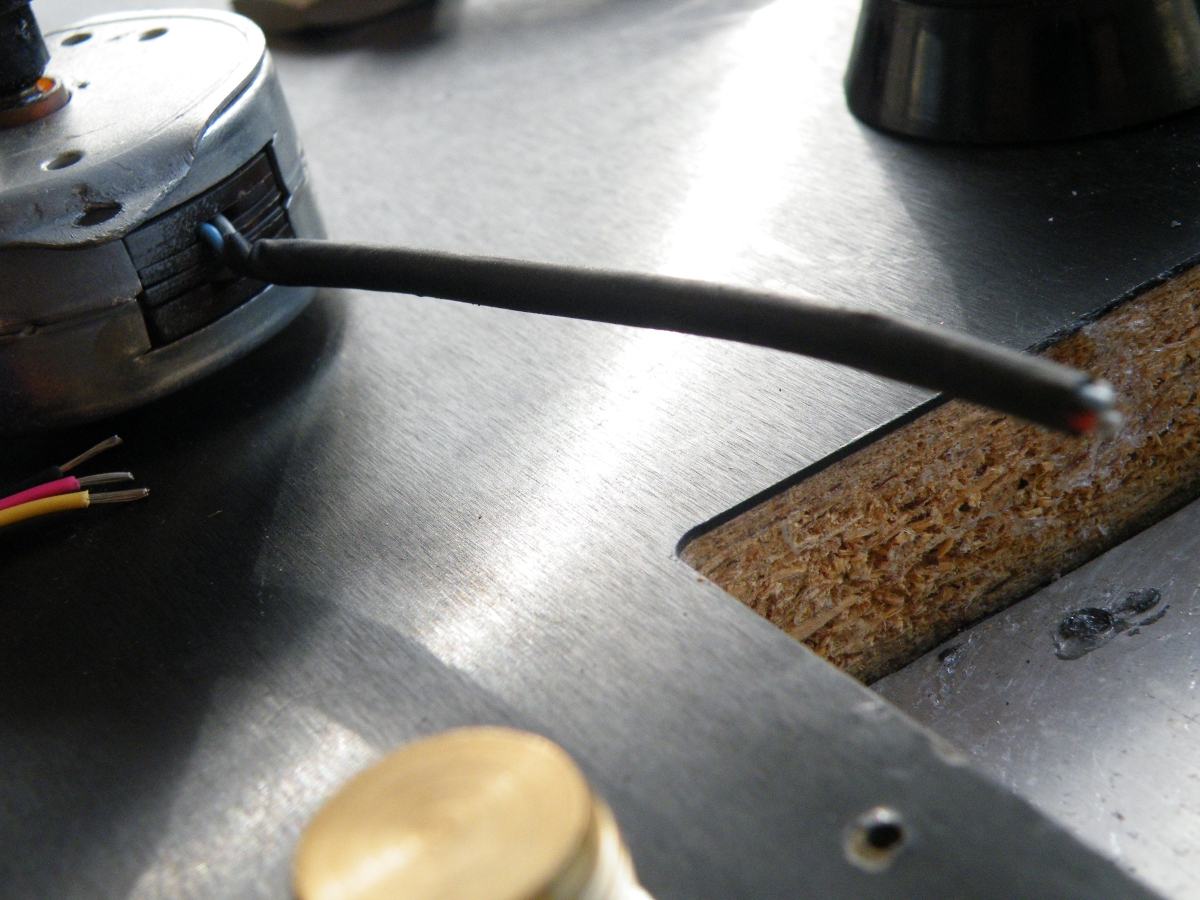

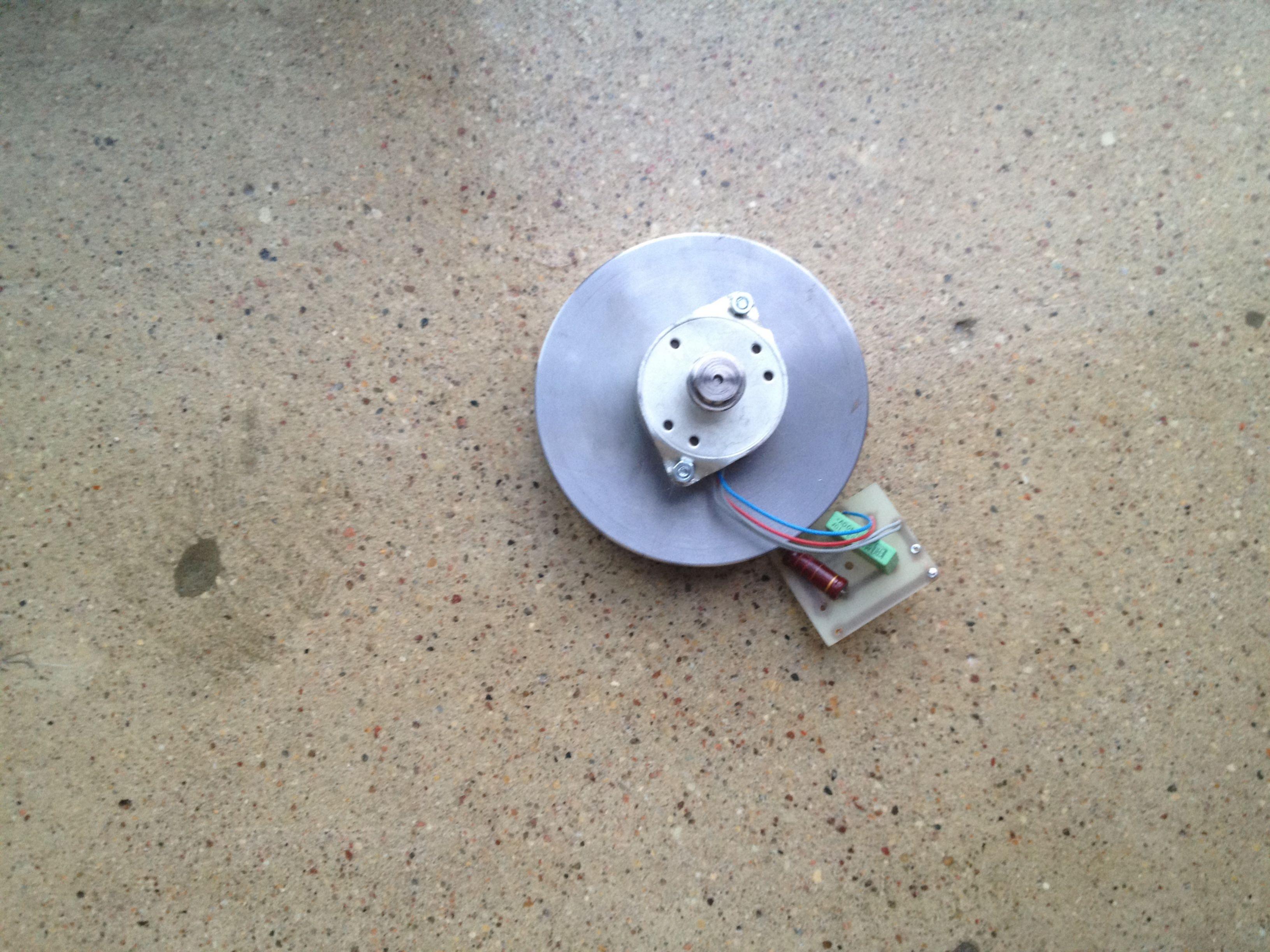

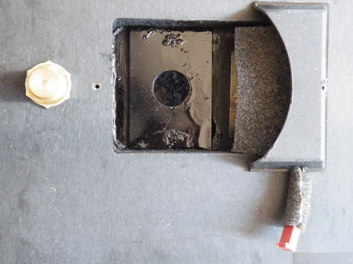

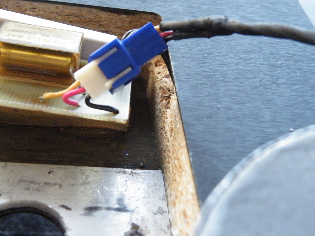

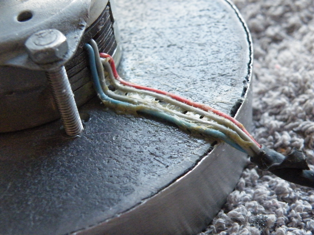

Final motor modification

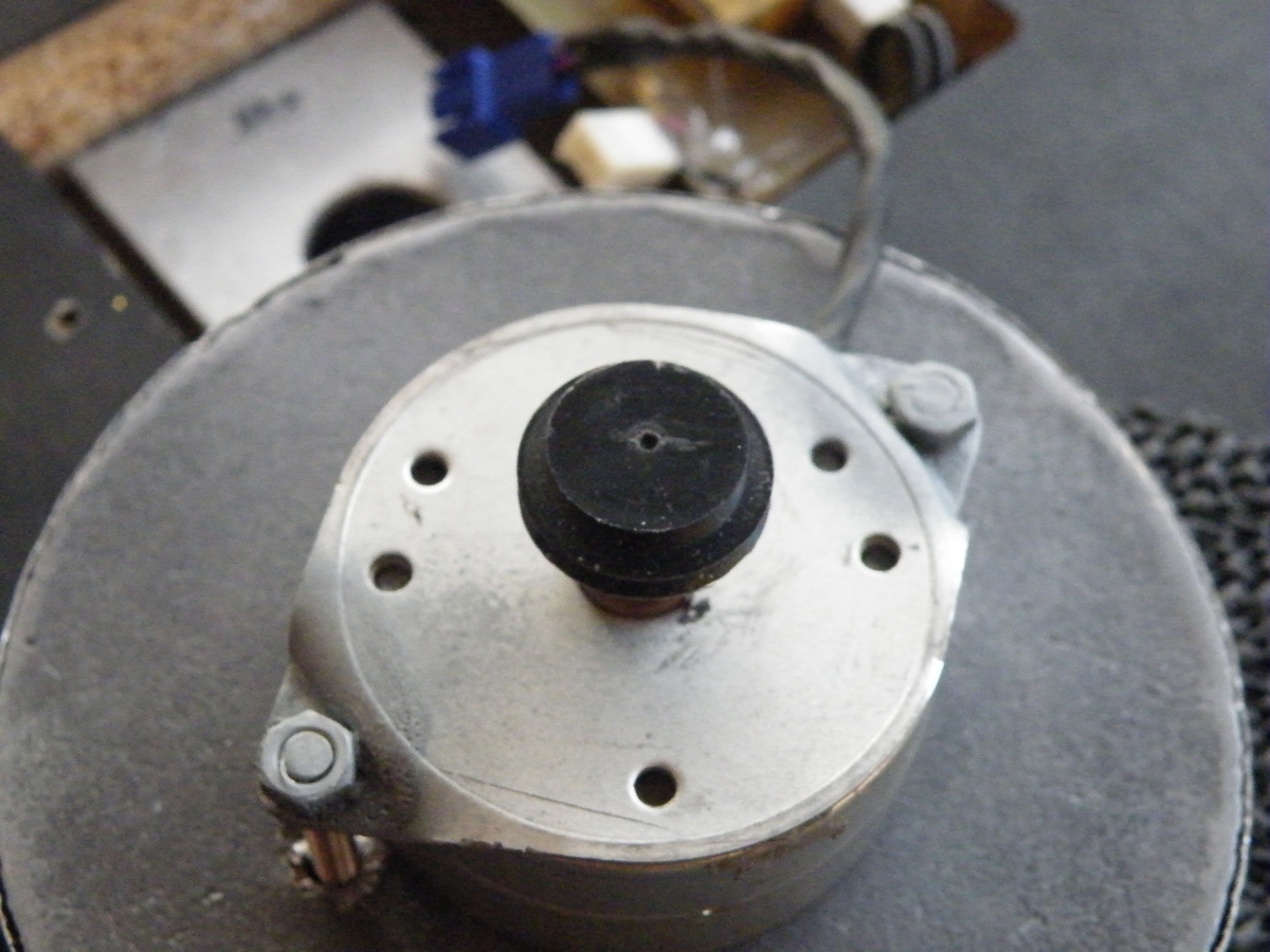

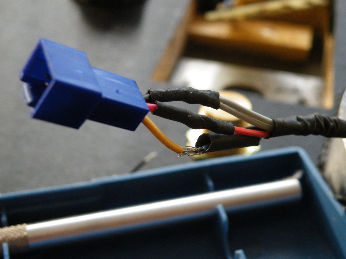

I took some of the shrink wrap off to spread the wires from the motor and flatten them glued to the lead base with contact cement. I then cut some Coles rubber mesh to suit the top, so that it does not scratch the plinth (while moving/adjusting the base etc), and just so that it has some aesthetic element to it...I also did the same with the 2 washers/ground bolt head on the bottom of the base...
I then soldered a longer wire and female plug (with shrink tube) to the circuit, ensuring that the circuit is also stuck on with silicone. Silicone is used for the wiring in the plinth cavity in varying places to ensure it will be vibration free.
I proceeded to cut the plastic cover to suit the motor base, and ensure there will be enough clearance so that it does not touch it. I sprayed the interior black, to be consistant with the plinth colour, and placed a piece of foam over the top of the circuit board.
The shaped plastic cover was stuck on with contact cement, and with one screw, and the part where the wire protrudes, was given a dab of silicone as well as that part of the wire; and foam covered as well (including motor wire). The connected wire is allowed to 'hang' slightly away from the plinth, but is foam covered 'just in case' a minor connection with the plinth/cover may occur : -- all to dampen, ensuring zero vibration.
Motor assembly is very easy to detach... and re-attach.... In addition, when the belt gets 'stretched'..., just move the motor back a couple of mm's...

...when I created my motor isolation base, I found it important when engineering the cavity in the center of it, for the thrust bearing (for spring/bearing), it was important to ensure the base surface was very flat, as I had to bolt down the Rega motor to it quite firmly, to minimize/avoid grease (possibly) finding its way through (This has not been an issue to date).
.., and for a stable coupling of the motor to the base, so that it would sink/transfer the vibrations/energy from the motor to the base...neutralizing them...(and also minimizing motor vibrations going to the belt)
...I upgraded the platter spindle bearing to ruby: the steel bearing I used for the thrust bearing, which was ideal for the intended purpose...
(In using a barbell weight, a seperate Rega motor thrust bearing would need to be fitted onto the motor and the thrust bearing would protrude into the hole in the weight.)

Also I've installed new platter drive belts x2 and DUAL belt pulley and thrust bearing from LPTurntables-Michael Lim. His thrust bearing DOES have a hex screw for adjustment too and is the cheapest thrust bearing around.
The bearing was dry when I got the table and the actual ball had corrosive growth on it so I repolished the ball and renewed the oil and yay!!
Some heatshrink tubing around the perimeter of the sub-platter, actually 2 layers, provided a slowing of platter speed as I dislike the slightly fast rotation on those earlier Regas.
Stock feet have a 3mm wedge of sorbothane under each foot which assisted noisefloor greatly.
2 days ago I rewired the arm with Cardas 33 from Cardas Cart' Clips to a terminal block which has Ultra-low capacitance interconnect leads to rhodium RCA plugs.
I used a Cartridge Vibration Absorbtion device from GoldenAge Audio in Australia which is carbonfibre sandwich material in a 3mm block mounting between cart and headshell, reducing stylus born vibrations transferring to tonearm and this works very well with results evident using the HFNRR test LP. So this has allowed me to use my Shure V15-III with Sas stylus on the medium-mass Rega arm..The V15-III with Sas is very high compliance and was giving resonance issues without the Cart Vibration Absorber thingy...To ensure correct cart VTA for the Shure I needed to install a 3.8mm serrated 3 point spacer from Michael Lim also- about AUD$25.00..This 3.8mm spacer also needed for taller carts such as Ortofons too as I had also tried a Ortofon Salsa MC cart... Then last Friday I received an Acrylic platter mat from JClovesmusic-ebay. Bought from him before. Couldn't see why full platters in acrylic cost so much. I have to say what a surprise after replacing the stock Rega felt with the "XTC" acrylic mat. Quite an improvement sonically and not very expensive at all. So it is all sounding very nice indeed so far..I am waiting on a ceramic ball bearing and lube oil from DuoPhonic UK-ebay to put paid to the bearing & lube operation; also from same supplier a sorbothane motor "shroud" for vibration reduction. After that I may just spring for an answer to the motor mount aspect-either the additional base idea or a heavy motor base like you have done. Trouble is heavy base from o/seas cost heavy postage too !! The additional base for motor mounting from UK about AUD$200.00 inc post or about $170.00 thru an Australian supplier..so bloody exxie... Cheers 4 now all.
I admit, I found original Planar 3 motor rubber suspension quite funky in the beginning. That didn't put me away from trying motor isolation base. It's similar to TigerScents. A heavy (steel, probably) 24mm x 110mm base round tablet was made in a local "garage" for the cost of 8 euros. Drilling and mounting I made myself. And it's the best cost upgrade ratio I've ever spent.
There's increase in clarity at every register. There's more staging, positioning and just simply more information. I highly recommend it for everybody who own Rega Planar TTs.
There's room for improvement. I didn't mount rubber "feets" on the base for decoupling. Not much space left with current Rega feet height. So it's simply base *** to shelf coupling. I didn't drew a core hole for spring and thrust bearing...

TIGERSCENT..So far I have replaced the motor mounting rubber "band" pending later change of motor mounting arrangement.
...its worth doing...
I found the acrylic platter is better sounding...I just cut out some rubber mesh that comes in rolls from Coles and it works beautifully...solid tight sound...very cost effective...
I used the ruby ball from them. It works well, the ceramic is apparantly an greater improvement...
...again, the motor-base is worth doing and the best upgrade option that makes a noticable difference... then consider rewiring the arm...all the other options are added tweaks that improve,....additionally..., but these 2 mods make the most dramatic noticable difference...

I came up with a novel idea. Use a rubber or silicone washer that is totally flat, such as found in plumbing etc, for a nice, snug and flat fit...., however anything similar will do with..., medium density...
Its an idea I came up with to de-couple and dampen the tonearm from resonance from the plinth/platter..., silicone at the right density would be ideal, but this 'K' valve was the best I could come up with at Bunnings this afternoon...
This is 'instead' of the metal washer/spacer that is usually used to raise the height of the tonearm...
'K' is the word !!
I put some Quick Grip contact on one side of the rubber washer VERY EVENLY and thinly; then on the underside of the base of the tonearm after the thread; and then carefully manouvered it along the base thread of the tonearm, and quickly threaded the wiring through the plinth, and pushed it flat and held for about 10 mins.
Then I cut the excess away first with small sharp curved scissors, around the base, and then with a sharp stanley knife. I then cut some gaffa tape and taped the stainless part of the base up, and proceeded with a dremel and small cylindrical sander implement, to even it out nice and round around the base. I then took the tape off and where it was a bit scuffed through some tape I sanded a bit with 240 grit sandpaper so it was all even with the same look.
I proceeded to wrap some silicone gas thread tape around the threaded base part, several times evenly, to further dampen any would-be resonance in that direction...
I then put some contact cement on the underside of the said 'K' washer ONLY, (not too thick as it spreads out past the edges) and pushed it onto the plinth into the hole. I ensured it was straight and then placed a pad on top of the tonearm, and then carefully balanced a 5kg weight on top and and leaving overnight...., to ensure it adheres 'flat' regarding tonearm alignment....
This should further de-couple the arm from the plinth and dampen any vibrations...
One can also add very thin and even silicone or rubber cut to size on top of the sub-platter for further dampening...
Its about 2mm higher, ....at the base of the tonearm, which should be about right, however adding a thin dampening mat on top of the sub-platter, this can be adjusted....
It works rather well, with such a s-i-m-p-l-e modification. There was clearly a distinct improvement in dynamic range, bass response, and clarity accross all registers...I was surprised by the difference...I am re-discovering all my records and they are an increased joy to listen to. Probably should mention that the volume & bass response seems to be much higher. I notice I need to turn it down by about 7 notches. ie: from -11 to -18
