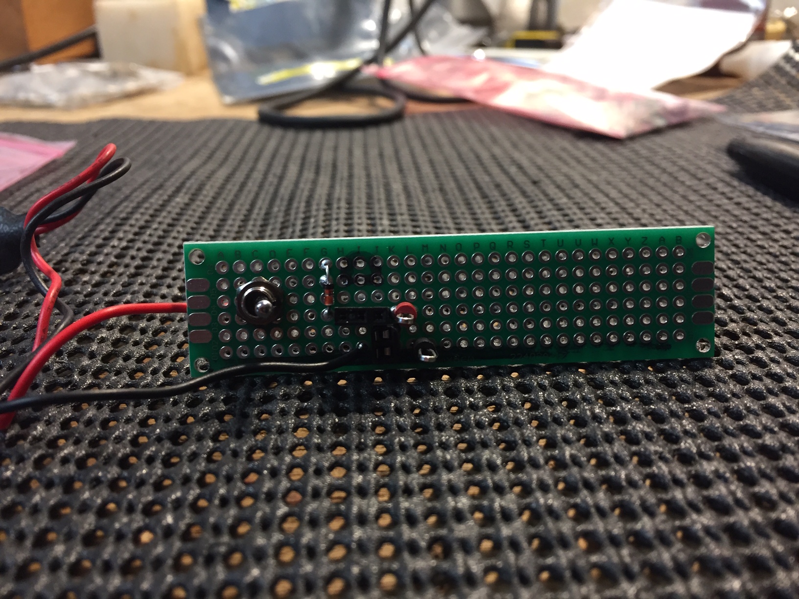

For those building a mini to power the BIII pro I would suggest building the LED test rig in the mini guide to see how the LED's behave with J2. The voltage does rise enough to the point where 2 yellow LED's would give me 5.02V. The green ones put me way over the max voltage for a BIII.

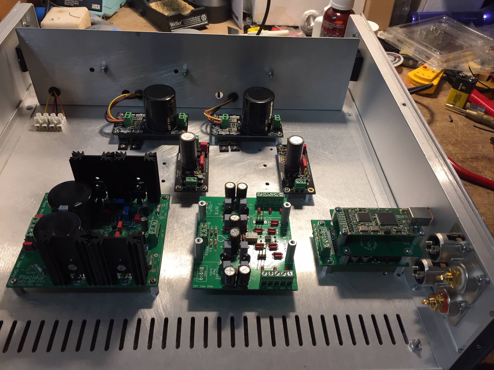

2 minis up and running. My advice is read and re-read the build guides until you understand them. Build the LED test rig. Most important, take your time.
The two yellow LED's puts out 5.12 Vdc on cold start up down to 5.06 Vdc warm (Chronos stack).
The one yellow and one red LED puts out 4.98 Vdc on cold start up down to 4.88 Vdc warm (BIII Pro).
Thanks to Salas and TB!
