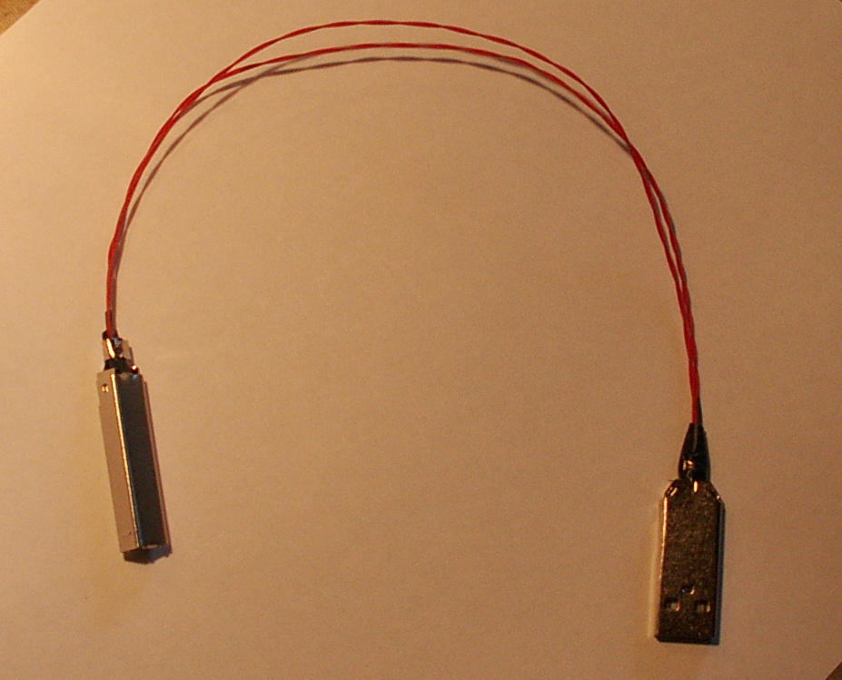

Even the USB cable has a significant effect.
Best DIY USB cable I've come across so far uses 30AWG Kynar wire-wrap wire - sonically as good IMHO as Cat5 solid core but, being flexible, less likely to damage connectors.
attachment.php
See pic - note that one of the pairs is D+/D-, the other is a doubled-up Gnd lead; there's no need for V+ with the WaveIO. (I didn't bother with a screen as the lead is so short. That, of course, minimises capacitance but I did it that way because, essentially, I'm lazy.)

Nice!
Where did you get the connectors?
If possible, even shorter is even better.
