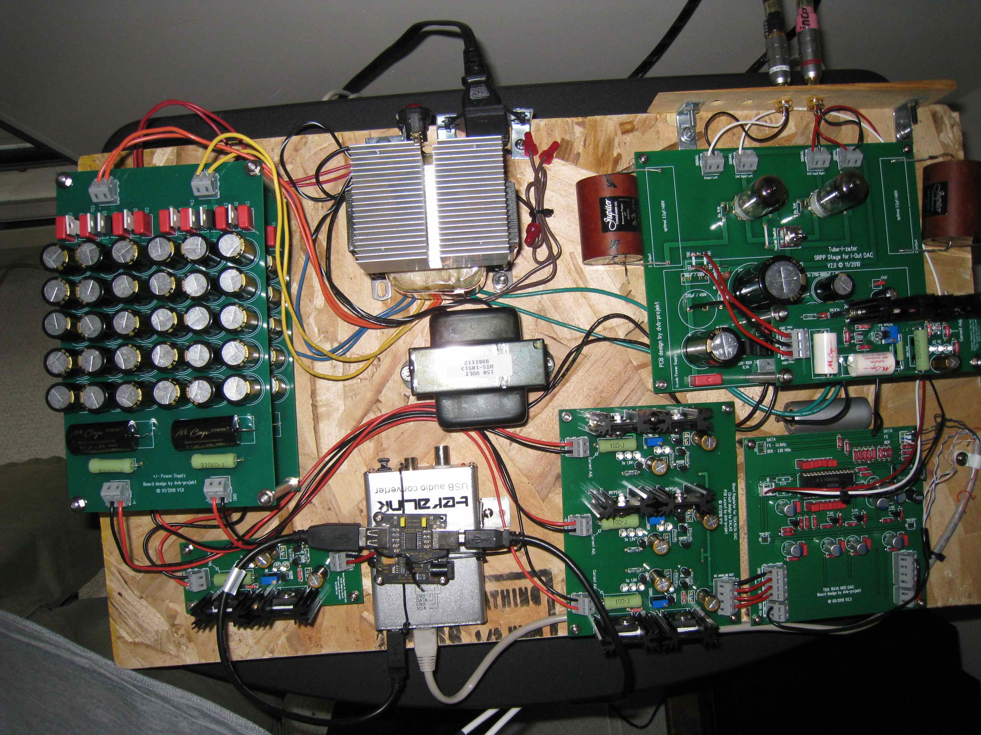

Finished!
Finally finished the build last night....
All voltages adjusted well and the sound is magnificent! I had forgotten how much I enjoyed the sound of the TDA1541A. The output caps had been used before, so I think break in should be in the 50-100 hr range.
The best way to describe the sound so far.....liquidity, warmth, plus the added bonus of instruments and voices placed individually in the soundstage. This IMO is difficult to achieve digitally without having the sound "jammed in your face".
Many thanks to Oliver and Salas. This is a winner!
