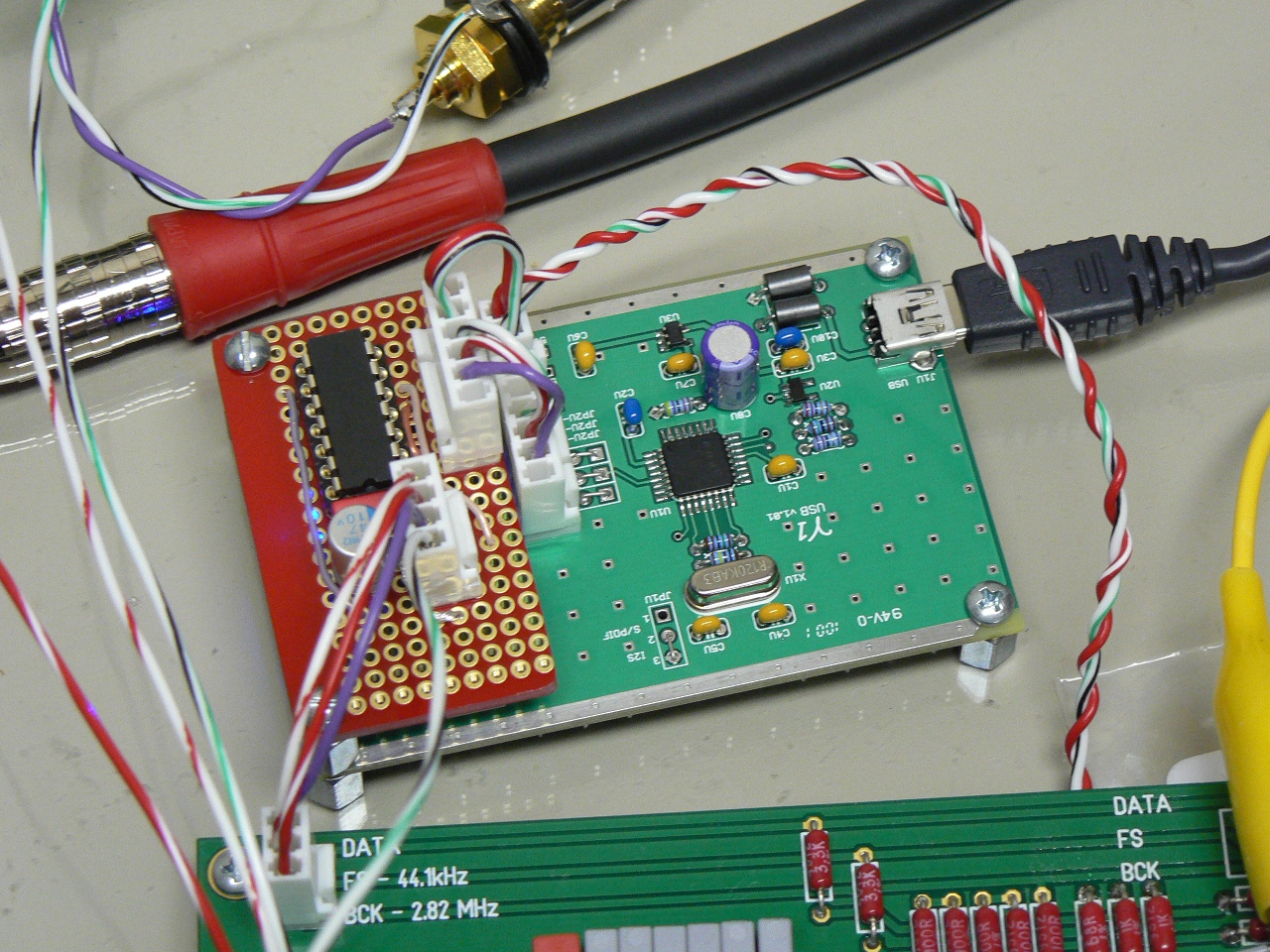

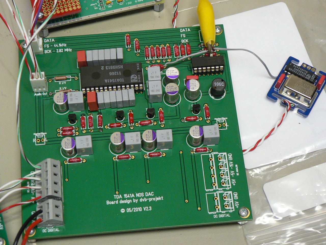

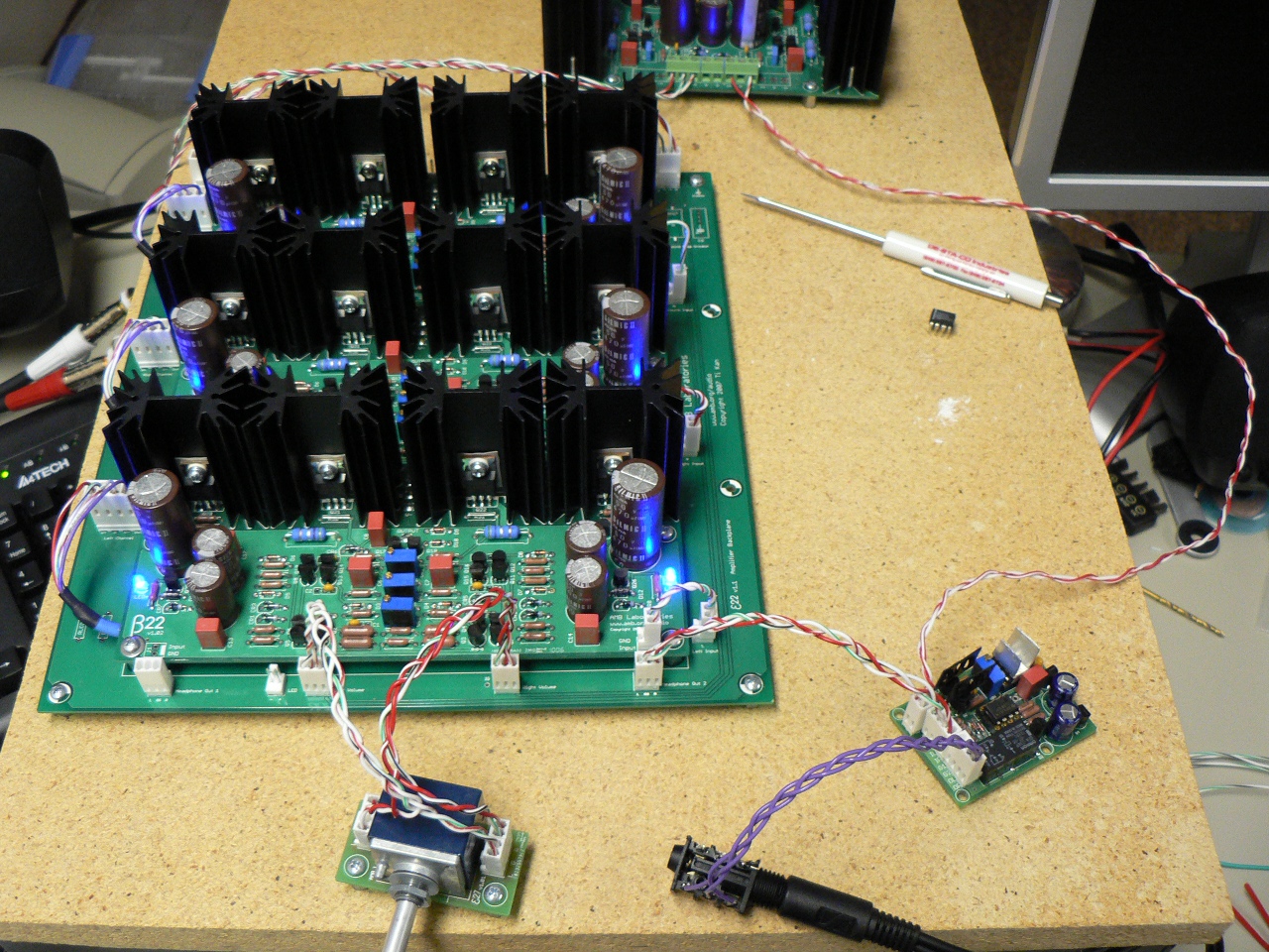

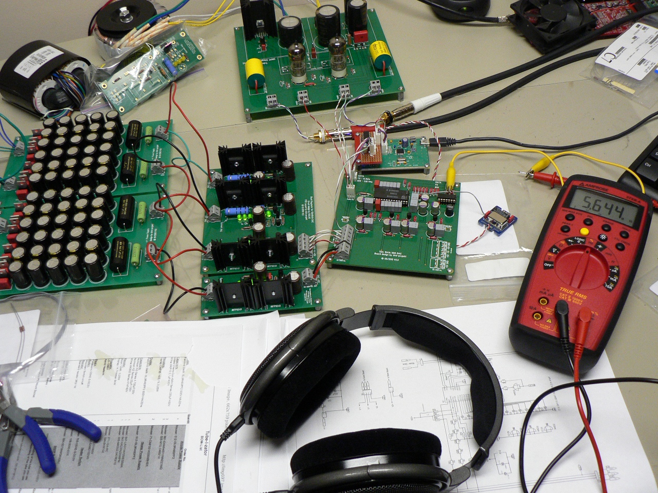

Hi, I got my working today, I'm struggling with DEM re-clocking, it takes few seconds to sync. I'm playing with different frequency, right now I'm using MCLK/2. Buffer for amb USB-to-I²S converter works well, thanks for that. Sound is very good, even with out SSHV. I'm going to build it in few days. For IV R I went with 56ohm and later 47ohm I will test more and then buy better quality R.
What can I say, sound is very good, I'm using this DAC with Beta22 headphone amp. Here few shots,

Having spent the festive break reading through the thread a few times I would like to make the following observations / suggests / questions.
1. If I build the boards (psu / salas shunts / dac) as per the diagrams and BOM then I should have a working DAC.
2. If the I2S source does not have a buffer then I need the new high-speed buffer board (at the moment I am sucessfully running I2s from a QA-550 into Buffalo 32S and from a juli@ into Buffalo II - since neither of these dacs seems to have a buffered input I assume there should not be a problem with the TDA1541A board!!).
3. It would be better to remove the TL431s and associated circuitry; in this case it would seem to be better to chop the board removing the TL431 section and wiring the Salas shunts as close as possible to the TDA1541A - a possible future version of the boards could have 3 parts for the DAC board - input psu connections board / TL431 board / DAC board? The Salas shunt boards could also have the outputs aligned to the DAC board allowing for even shorted connections?
4. Having a v2.3 board I do not have to lift any feet on the 74HC02.
5. Worry about the appropriate IV stage later!
If the above is correct then I will order all the bits (excluding TL431 bits) as per Ryelands excellent spreadsheet and get building.
Regards
Alan

Hi Alon,
to your questions:
You still need an output stage.
Unfortunately i don´t know the two I2S devices.
As i wrote before, if your I2S devices supply voltages equals 3.3V and don´t have a buffer IC on board,
you would need one, e.g. my Ultra High Speed Buffer Module.
The I2S attenuators from ecdesigns i am using on my DAC module, are designed for 5V TTL levels only.
So we need the buffer between the output of these 3.3V devices and the input of my DAC module
for a proper work, without canceling the advantages of the I2S attenuators.
The main advantage of my DAC project is the modular design.
For those who could not or don´t want use the HighEnd Salas Shunt Modules,
the additional TL431 are still on the DAC module for best voltage regulation.
I think Lucas had connected the Salas Shunt´s directly to the DAC Module. If he is ready with his soundcheck, i hope he post his experiences.
A new revision with a separate TL431 board is not planned.
Correct.
Best regards,
Oliver
