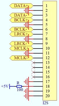

A quick question:
Have been running the r-2r with spdif input. Just received a good 3.3v ldo board and will try i2s.
My i2s out interface is a Gustard U12.
The case is that it has HDMI interface out.
The pinout is like this:
How do I connect this to the r-2r dac?
Thanks in advance.
BTW: I also have a hdmi screw terminal female type intended for the purpose of connecting to the dac.

Your I2S source uses differential output, most likely LVDS. So you would need a 4 channel LVDS receiver to convert the signals. Twisted Pear Teleporter module might do the trick if you don't want to roll your own, but first make sure that the I2S output indeed uses LVDS signaling.

You need one LVDS receiver.
The only one I found with same pinout is this I2S‚Æ�AI2S‚à‚Ç‚«‚Æ�A S/PDIF‚ɂ‚¢‚Ä
Another receivers with different pinout are. Perhaps would be possible to modify it.
Aune kit Module d'entre HDMI vers I2S - Audiophonics
ºÍ§Ó*µ响
K&K Audio | Digital Audio
Also you can use The Teleporter with modifications
Teleporter Digital Transfer Module
A good solution may be to replace the HDMI connector of Audiophonics receptor, for which you already have.
