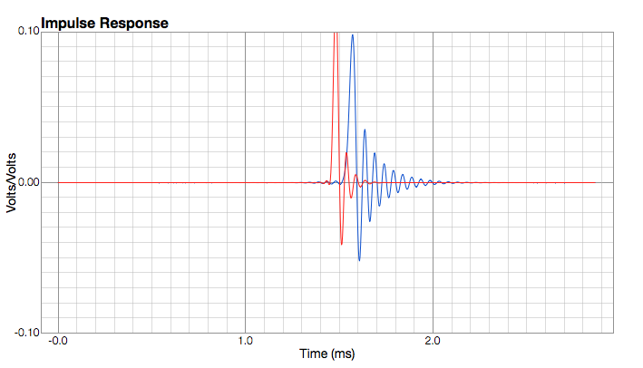

Yet another filter

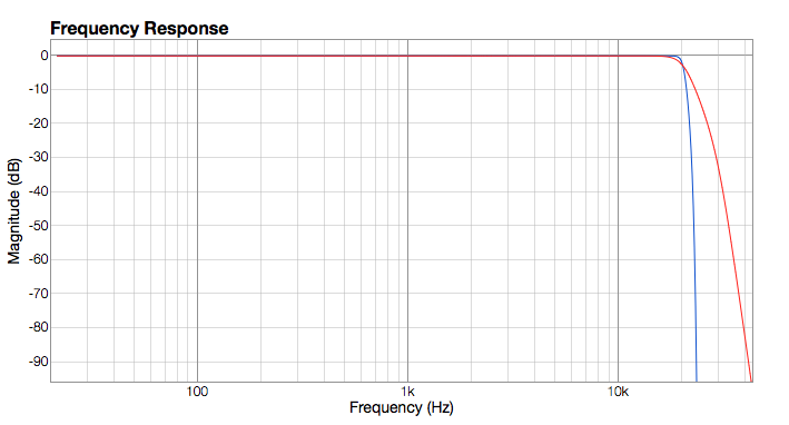

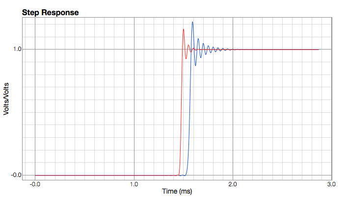

I've been having a play with creating something close to the Ayre MP Listening position filter described in their MP white paper.
I've used a similar method to POS in that the main filter is minimum-phase, but an additional linear-phase filter is used to control the cutoff slope.
As per the Ayre white paper this filter is -6dB at 22050hz, and -96dB at 44100hz. I'm sure this will give Søren the horrors, but I feel if it's good enough for Charles Hansen to include in a commercial product as the preferred setting it can't be all bad
I've included comparison with POS's filter (pos - blue, my "MixPhase1" filter - red).
Filter Response showing the slower roll-off, and earlier onset of filtering. It's about -1.2dB at 19kHz, so not as ruler flat as POS or stock filters.
IR showing 2, possibly 3 post-ringing cycles on the MP1. Not as good as the 1, possibly 2 cycles of the Ayre. Both POS's filter and my MP1 have a minimal amount of pre-ringing from the use of linear-phase filters.
Step response is similar story to the IR.

I'm fine, you still have good attenuation where it matters, remember that no music have content at high levels at high frequencies, so you don't need to be 100 db down at 22 Khz.... The trick is to find out how attenuation you really need....

Thanks Søren, glad it's within acceptable limits.
leehan sent me a link to a thread over at Computeraudiophile with some information about the Ayre MP curves. Mine is actually fair bit different to what Ayre has done. The "Listen" curve is -0.75db at 10K where as mine is 0dB at the same point. At 20K "Listen" is -3.2dB whereas mine is -2.3dB, so "MixPhase1" is less rolled off up to 20K.
I'll do another variation that matches the Listen filter more closely, but the current version is very listenable.
The curves were done in Fuzzmeasure Pro - FuzzMeasure Pro 3
I export from rePhase as a mono 32bit .wav for analysis.
The programs POS mentioned - REW and Holm Impulse look like they are similar.
