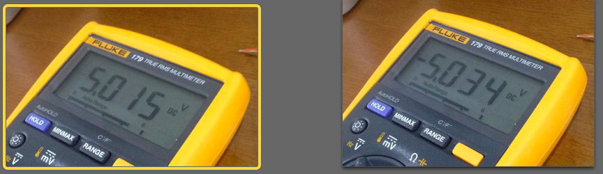

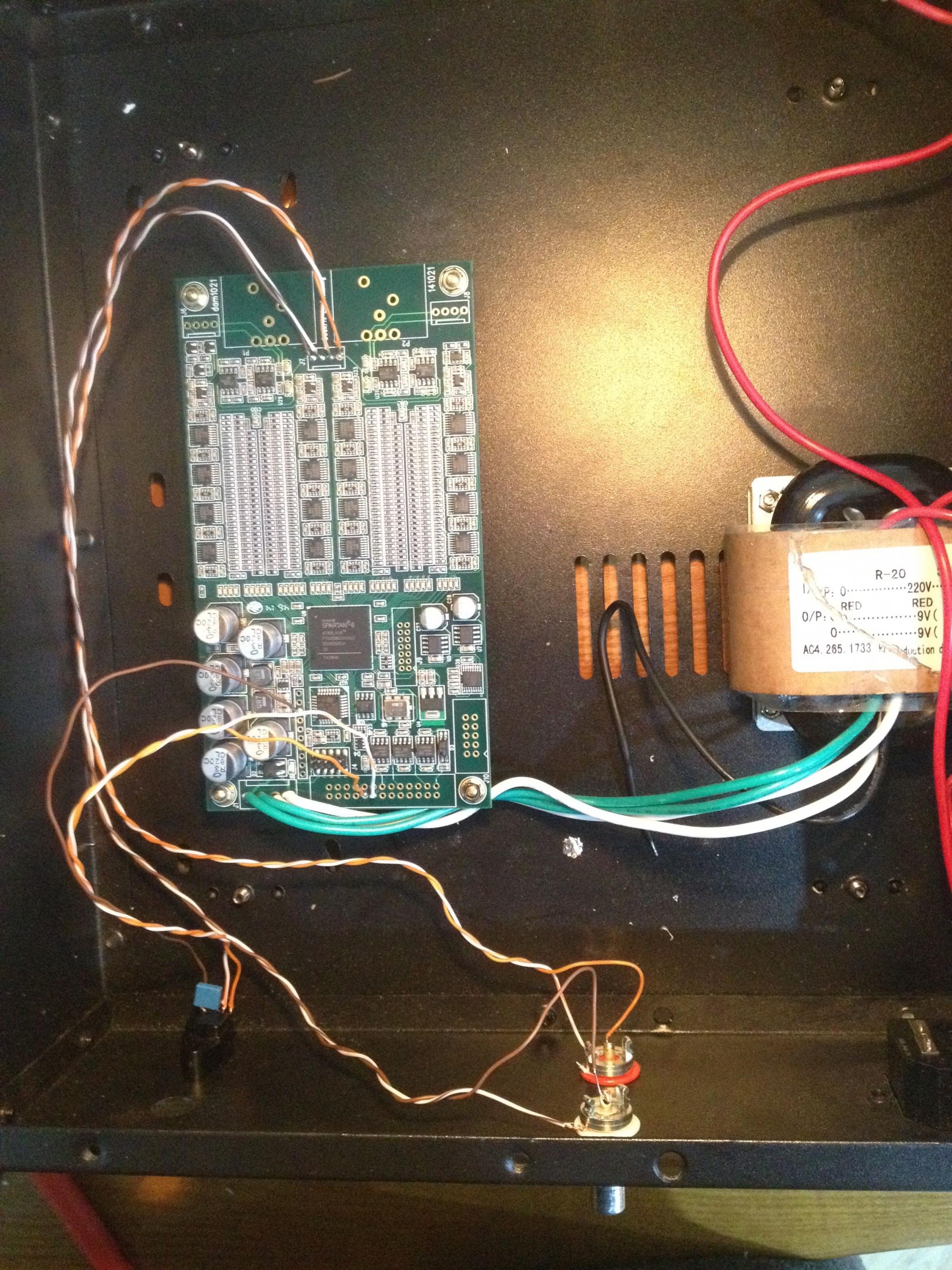

Finanly I got all the part and start to solder and get everthing together now.
I start with the most simple way: Toshlink from AirportExpress. But I can not get lock to the signal, the led keep blinking and there is no sound yet.
I suspected that the Voltage of 2 rail slightly different (5.015 and -5.034), is this could be a problem? I took several photos at the AC input and the DC supply to resistor rails.
Another thing could be problem is wrong wire to the toshlink receiver, could be?
Any help please?

Hi laptopav,
which type of AirportExpress do you use?
I had problems with the latest incarnation of the AE. The audio stream was so jittery that the WM8004 of the Subbu DAC wasn't able to lock on it. I have not tried this with the DAM DAC though.
Br
Jo
Really? I tried with the N version, 2012 I think.
Update: I just tried with AppleTV, different sample rate with several song but result still the same. And this AppleTV work fine with NAD DAC

Saw you directly pluged a 9V AC R-Core !!!! Dangerous... hope your main 220 AC has not too much fluctuation !

I think I found the problem, I using the optical receiver Toshiba TORX179 which is required Vcc around 5.0 VDC, so 3.3 VDC now is not enough...
Thought I already order two Toshiba TORX147L from eBay, but in the meanwhile can I take 5.0 VDC supply from dam1021 (J2) or I have to use external power supply or should I wait for eBay (will arrive next month :-()
Thanks.
Thanks.
Thanks.
You can take 5V from the dam1021, but as the input lines to the dam1021 are 3.3V only you need to divide down the output voltage from the toslink receiver. Looking at the datasheet it have a IOH current of 1 mA, so maybe it's some king of OC already ? Try loading the output down with a 2.2K resistor first....
