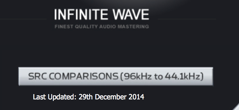

In the meantime I did some research about resamplers and filters:
Here's an interesting article at soundcheck site about resamplers and ringing artifacts.
One of the best resamplers is SoX, it's open source and also available as plugin for foobar.

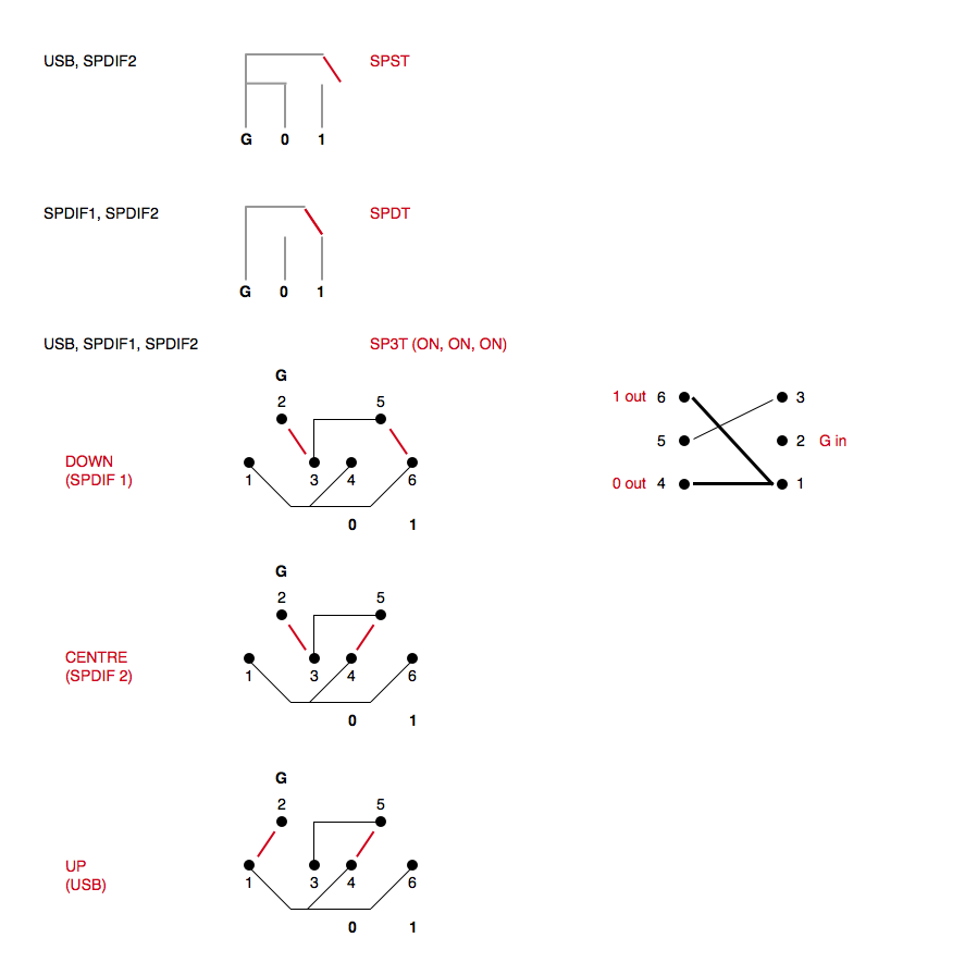

DIY your own binary coded dip switches.
It should be Code 12 BCD version then.
Looks like 4 position BCD switch isn't available anywhere. They are at least 10 positions. I'd hate dangling null positions on the switch. So here is how to DIY your own binary coded switch with readily available regular ones. Bonus is you get a big tough switch to mount on your chassis.
First one is what I'll use for switching between USB and Toslink. Requires a SPST.
Second one is an example to switch between Toslink and AES. Requires a SPDT.
Third one is for all USB, Toslink and AES inputs. Requires a SP3T (http://www.farnell.com/datasheets/1784503.pdf).
Blame any errors on the 4th glass of Ardbeg. See you next weekend. I'ts been a pleasure...

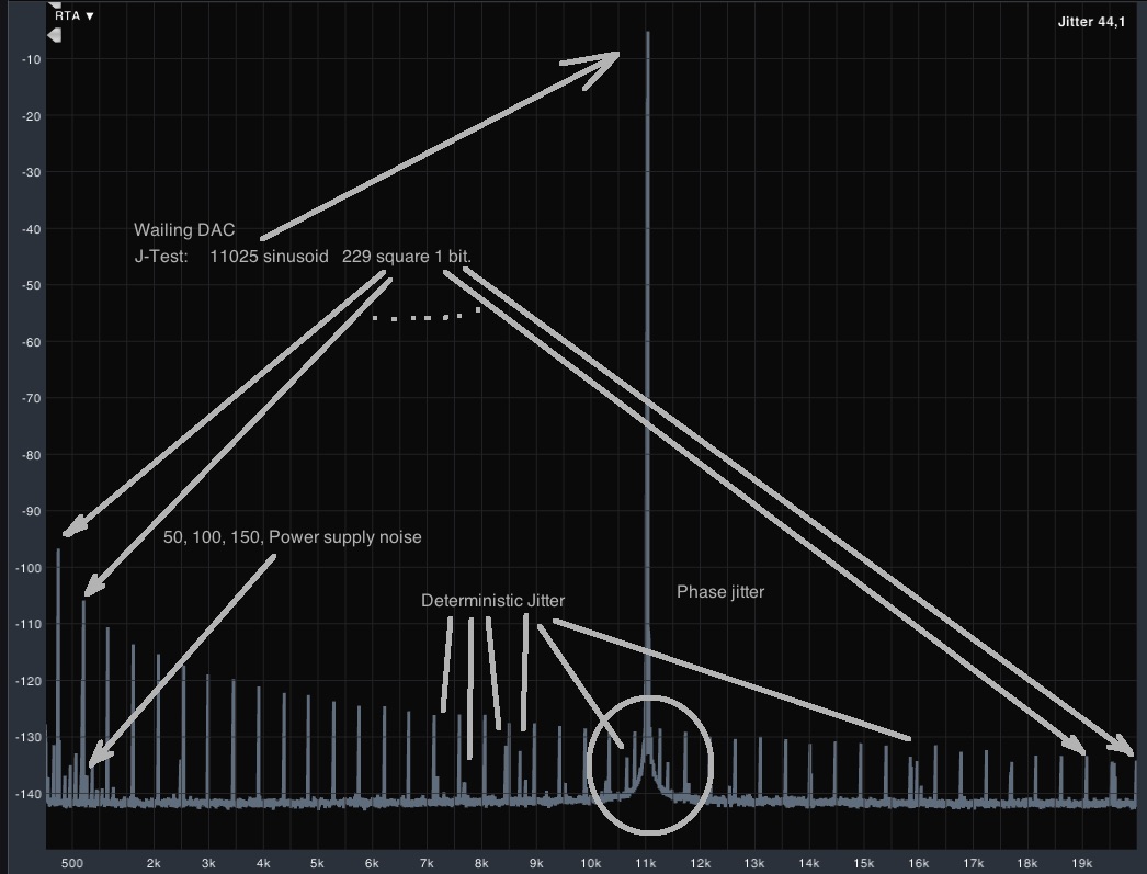

I will try to explain the Jitter meassure. Get to compare the best meassure I have: Weiliang DAC, Xmos, and 0.1 ppm clock. The ground is aleatory jitter (Dam1021 have 3 dB better ¡buffer work!)
Phase Jitter is the base width of 11 kHz tone. (Dam1021 is better).
The weiliang deterministic jitter appears in different DAC measures, is Jitter of measure equipment: Motu Ultralite MK3.
- The theoretical 229 Hz. square response is 229 Hz. and multiples. They are decreasing. In the Dam1021 the multiples deform from 10 Khz. to 22,05 Kz.
- Deterministic jitter appears in the middle of square signal: 342.5 Hz and multiples.
Both Dam1021 problems increase with frequency similar to sinc function, I think it is aliasing problem of digital filter.
That explains it sound better at higher sampling rates because filter aliasing problems appear Appear at higher frequencies less audible.
I agree. By using a higher fs, one rejects folding frequencies at higher freqs and this could be compensated easily with oversampling/upsampling or higher fs material. Besides, as i just wrote to Soren, the reconstruction filter is too high a frequency for fs<50kHz to help with the current filering scheme.
