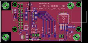

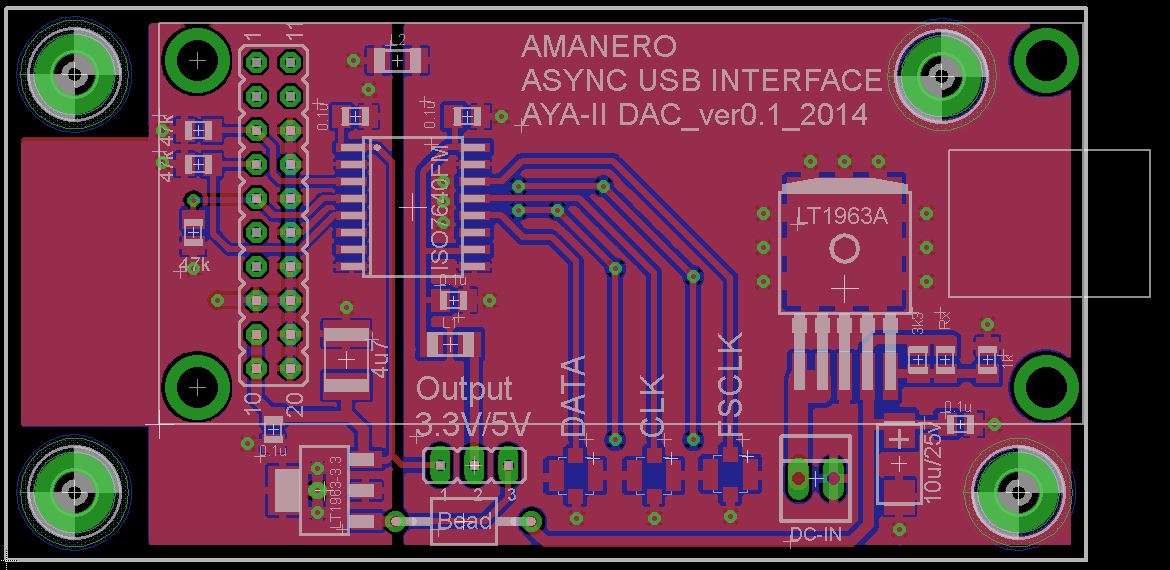

Hi emyeuoi, if you make an input and options PCB, maybe you could add my own version of the Amanero interface PCB which includes power supplies, insulator and U-FL connectors as well. See picture. I'm using Eagle PCB full release, but with such a small PCB you can certainly use the free version of Eagle. I can send you my design file and you can add it to the rest of you board. Just an idea. Let me know if interested.

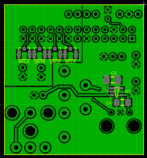

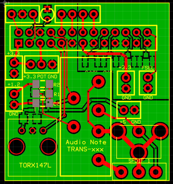

Hi All,
Thanks for your comments and suggestions so far.
Attached are the print screens of the interface board (top and bottom sides) that I would like to submit for your additional checks and comments.
I added the LDO 3,3 V for the Toslink connector in the bottom side of the board. The +5 V are to be supplied by the dedicate connector. Adding the dedicated LDO to the Toslink connector I think that the 47 uH is not more required and I remove it but I am not an expertise about the Toslink, so please correct me if I am wrong.
I move the U.FL connectors in the bottom side of the board to have the traces as short as possible and in same time to have the room to properly connect the U.FL cables.
I added the connector for the POT
I added the pads for the balanced input transformer and the relevant pads for the XLR connector. The connector is not in the board... sorry, too big.
I move the following in upper side of the board: the switch for the 2 SPDIF inputs, the LED and the inputs that I don't know for what they are required.
The board size now is 39 X 42 mm.
Any comment, correction, etc.. are welcome :).

I think it would be more flexible if the u.fl's were on the upper side of the board, and the other side of the 26-pin connector. if it's hard to get room for them, then move the 3,3V and FSEL connectors a bit lower down, and rotate them 90 degree, then place the MCKL u.fl above them.
this is at least what i think would be best - but we all think different :)
