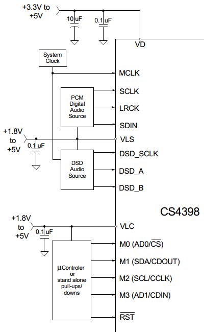

Hi Soekris,
I just got 9 pieces R2R DAC, thanks a lot!
I'd like to install the dac into my network player, replace the original dac. Does the R2R dac support I2S signal for CS4398?
I2S is I2S. You have three connections, plus 3.3V power and gnd.
SCLK -> BCLK
LRCK -> LRCLK
SDIN -> DAT
You'll have to workout where to pick up 3.3V and GND to power the isolators.
