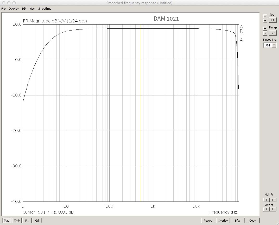

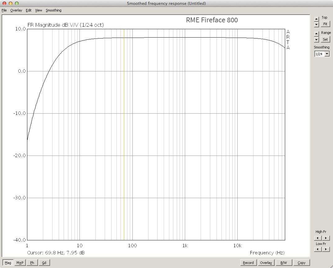

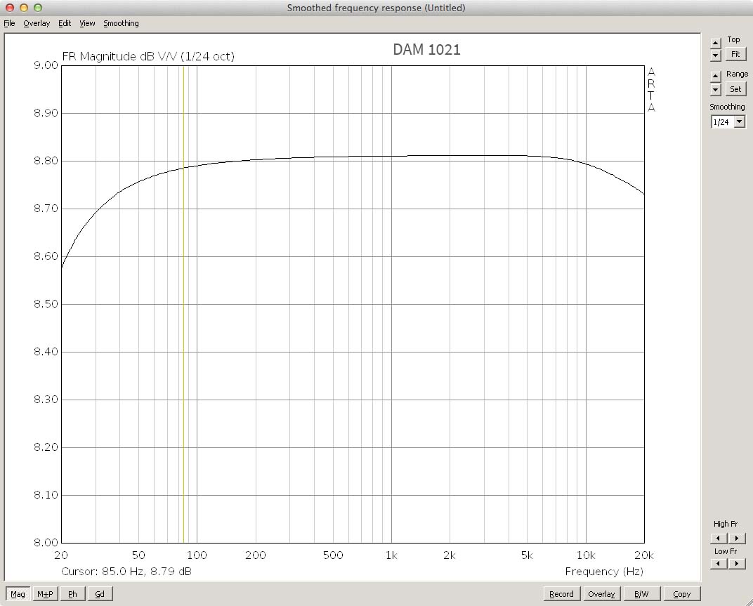

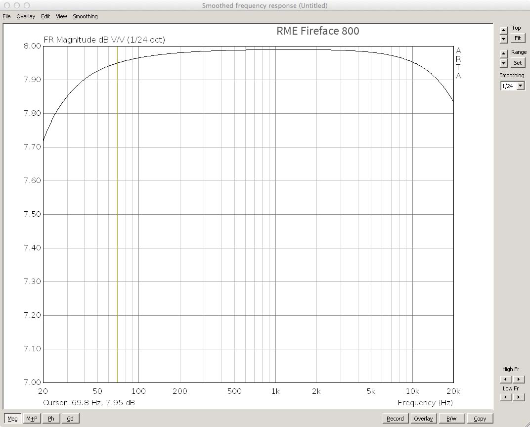

As suspectable the measures of the frequency responce of the DAM 1021 look very well. To compare I also posted the corresponding diagramms for the RME Fireface 800, with which I also measured.
The first diagramm shows the 20-20kHz range in detail and the next the 1-96kHz range.
The dam1021 is actually DC coupled without any low frequency cutoff, so the low frequency response is due to your measurement equipment....
I will probably add a digital lowpass filter in next release of the filter sets.

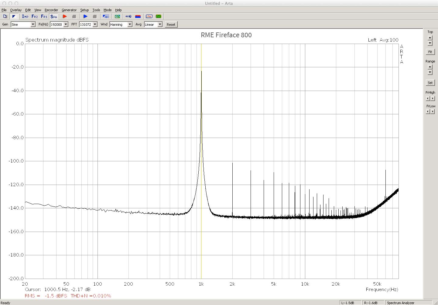

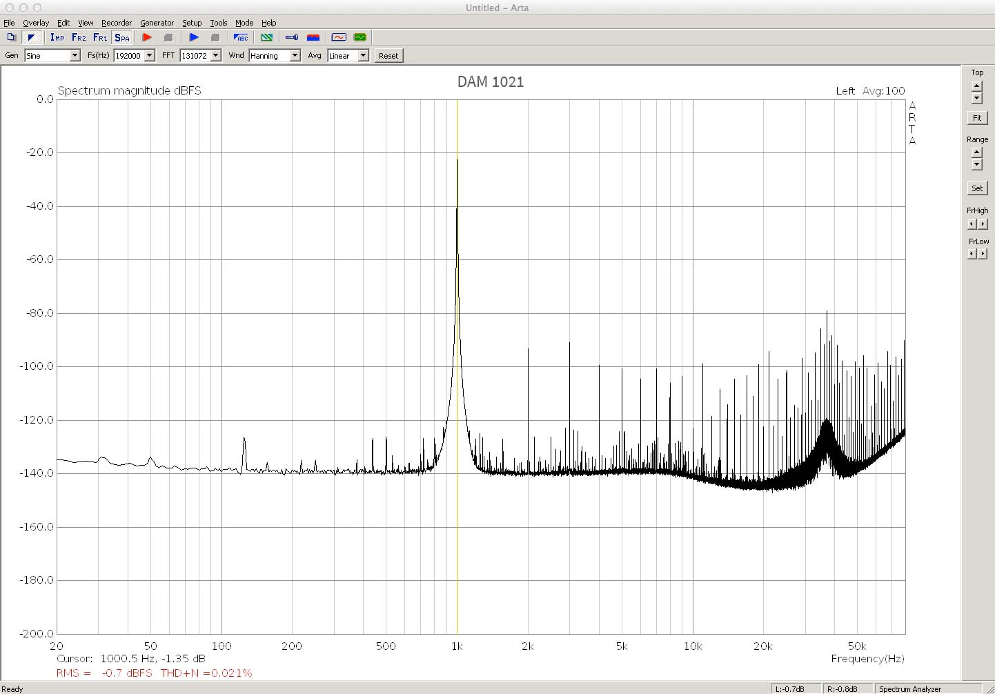

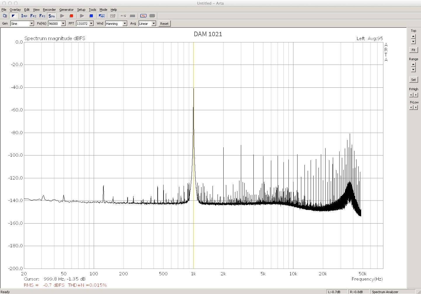

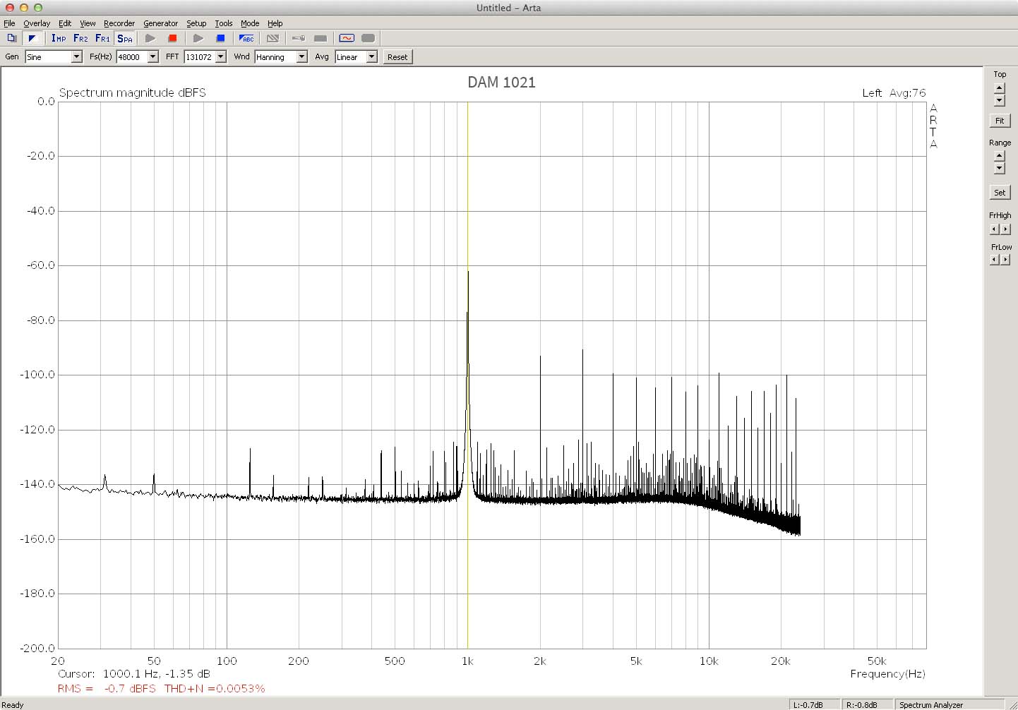

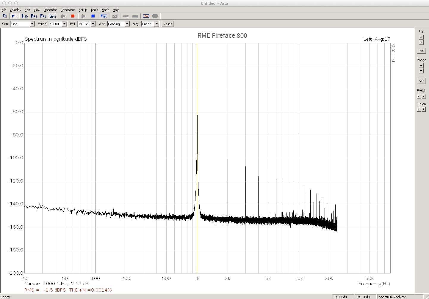

Here the frequency spectra at sample frequencies 48kHz, 96kHz, 192kHz.
There is no peak around 50Hz from the power line as there was in an other post. The DAM is powered with a trafo AC and is not shilded in a case.
Again the diagrams for the RME Fireface are added to compare.
Although the RME measurements look better I can't say I like its sound better. :D

Your measurement systems sampling freq should not be the same as the DUTs. Is it?
I am not sure.
When I changed the Fs seting of the ARTA software, the frequency of the Fireface (acording its own contol panel) kept uncanged at 192kHz.
The DAM 1021 got its digital signal from the digital out of the Fireface, so with the same rate as the Fireface runs.
I will later connect the DAM by USB and see if I can choose the sample rates independently.

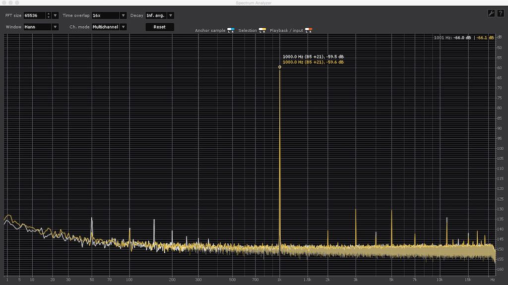

Attached is a -60dB frequency spectra at 44.1kHz.
Faber Acoustical Signal Suite -> TC Electronic Konnekt 8 SDPIF out -> DAM1021 -> Konnekt 8 (Mic inputs with pad engaged and set to minimum) -> Isotope RX. Sampling rates are both the same.
