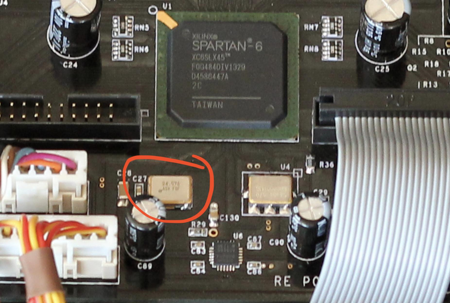

And look at this picture, U4 next to the Spartan-6 FPGA:
yes, I see it, you are right, and I think it uses for non-audio purposes(FPGA)
slightly left from the SIS570 you can see the 24M clock that uses for audio directly. probably from the downside of the board, you can find 22M also.

I think you are right, the DAC switches are fed by a pair of fixed oscillators at 22 and 24 MHz.
Moreover Nicolae of Rockna has bought a pair of crystals from me and he told me that he is interested on a gear to measure the phase noise.
Therefore I think that the Si570 is used for other functions, at least I hope so.
@TNT
There is not a question of sub-conscience, several Ian's FIFO users have experimented changing the oscillators and the Si570 was early abandoned because it performs worse than the Crystek (that's a poor oscillator)
@TNT

The problem is not loading the shift registers, for this job the phase noise (or the jitter if you prefer) does not matter.
Indeed, you can even load the registers quickly and then stop the bit clock (the best way to avoid interference).
The timing problem is related to the latch clock, the precise moment when the DAC switches change.
This clock is the most crucial in a R2R DAC (1704 aside), because even the slightest phase (or time) error during switching affects the quality of the digital to analog conversion.
You can try yourself, get a DAC with fixed oscillators (or a asynchronous FIFO) and then compare a few oscillators with different close in phase noise.
You will be very surprised with the result.
Most likely Rockna use fixed clocks where the DAC is the source, like USB input, and the programmable Si570 oscillator where the DAC need to track the source, like SPDIF....
