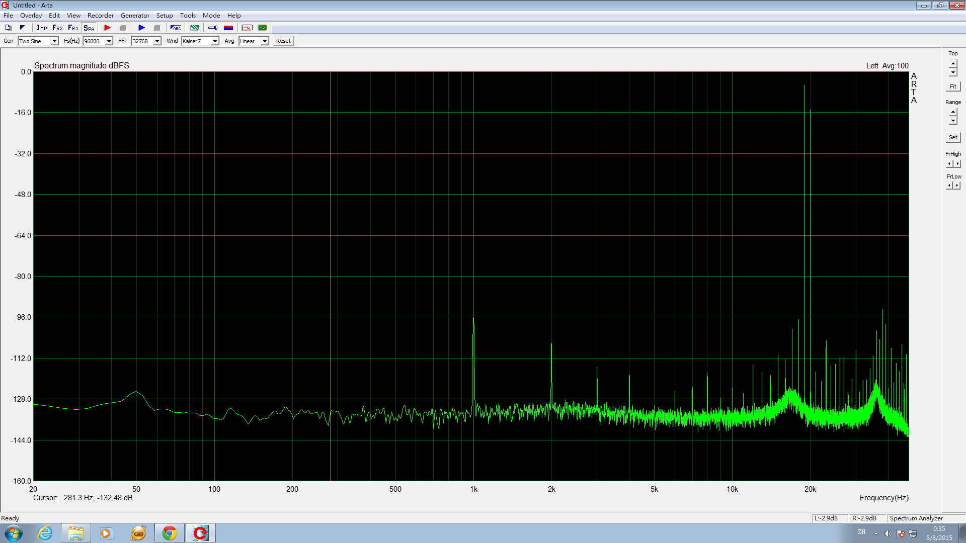

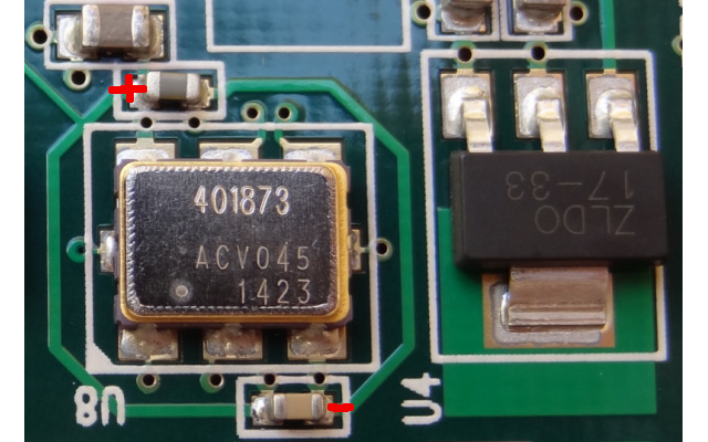

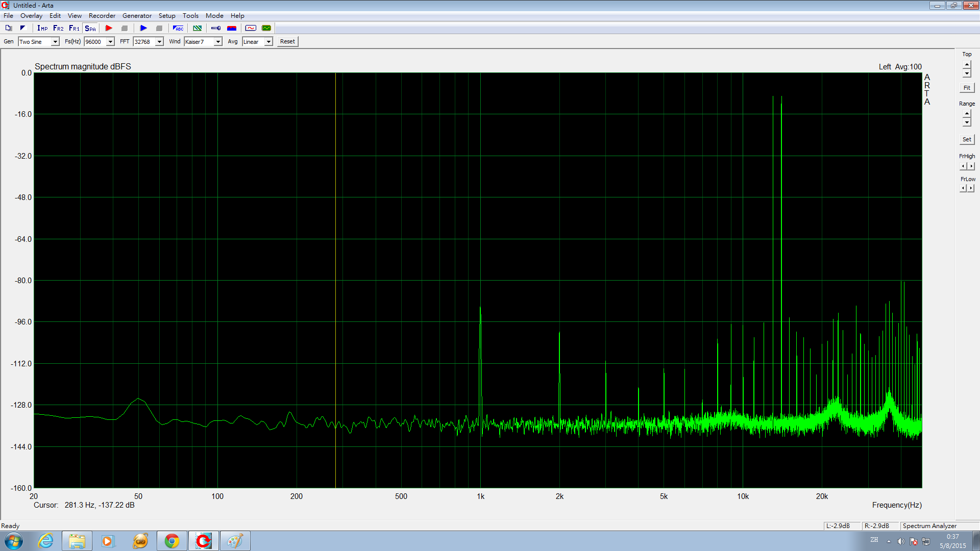

Indeed it would be very interesting to measure the clock power feed. I soldered an OSCON 330uF/6.3V from Vdd to GND near the oscillator and hear a more black background, more precision and more details.
Actual system: DAM1021 0,05%, DIYINHK TPS7A4700 power, 4 OSCON 330uF/6.3V capacitors 4V reference, 1 OSCON 330uF/6.3V capacitor oscillator supply
Solder points are marked with + and -.

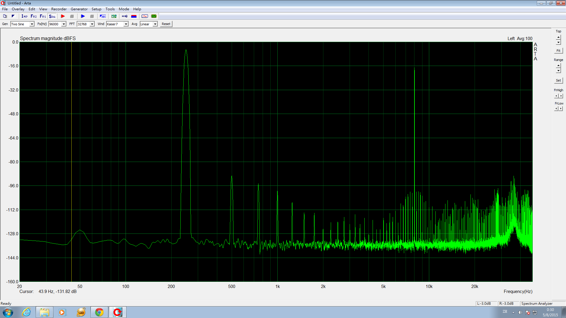

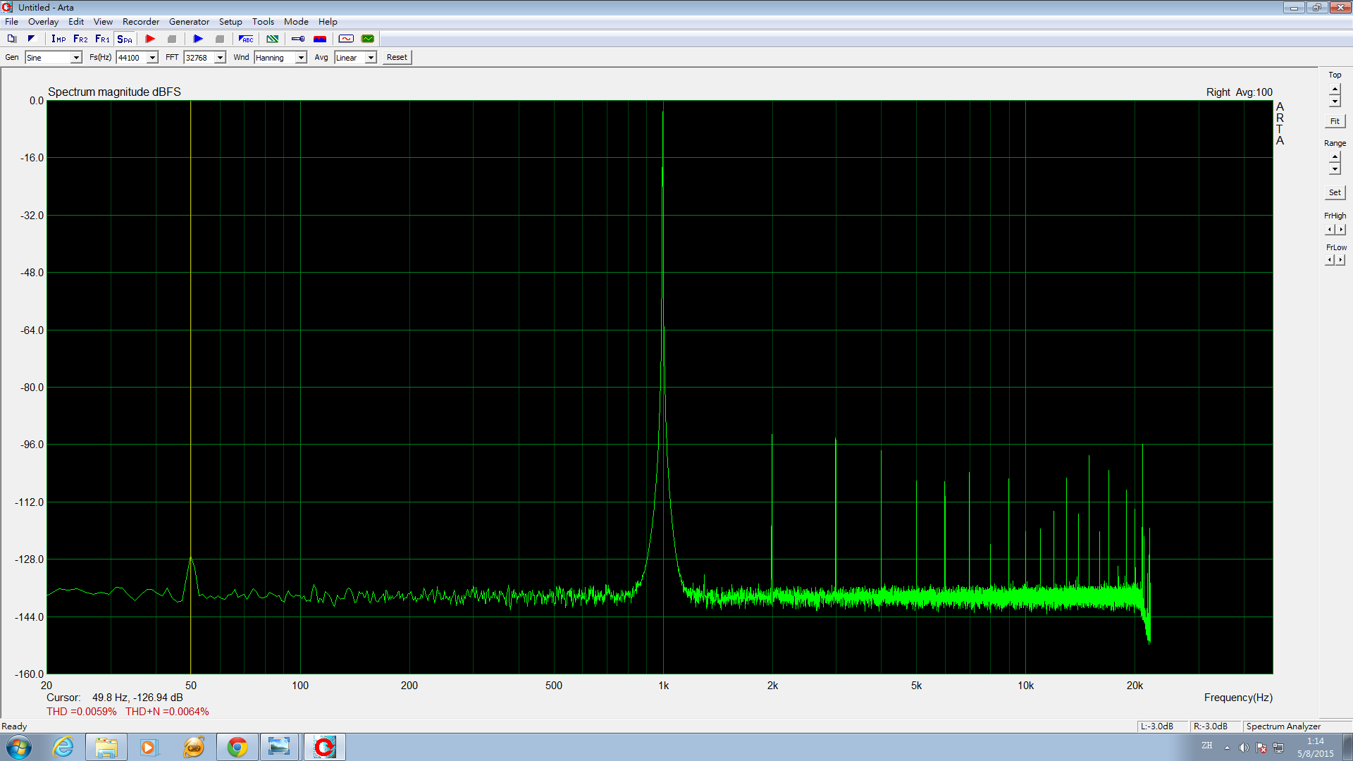

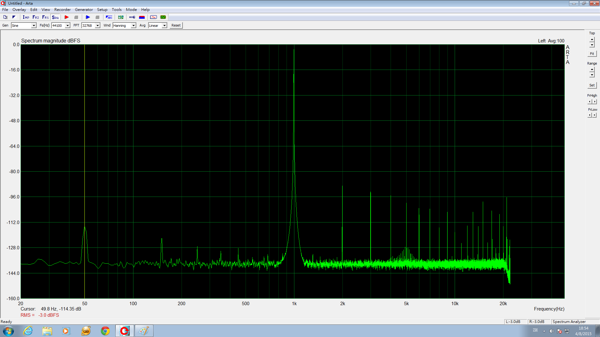

Some measurement before my Vref Mod
Some measurements before my mod.
1. Please note that there are small peaks at odd multiples of 50Hz, say 150Hz and 250Hz.
After swapping a pair of wires from transformer to the negative regulator, the 150 and 250 peaks were gone. The 50Hz peak decreased by about 12db.
2. The artifacts around 5kHz were also gone.
3. Distortion & Noise figures are not bad. (see the bottom left corner of the second figure)
4. Any experts can explain?
5. I don't know whether the IMD is serious or not.
Measurement were made with RME AIO soundcard with ARTA.
