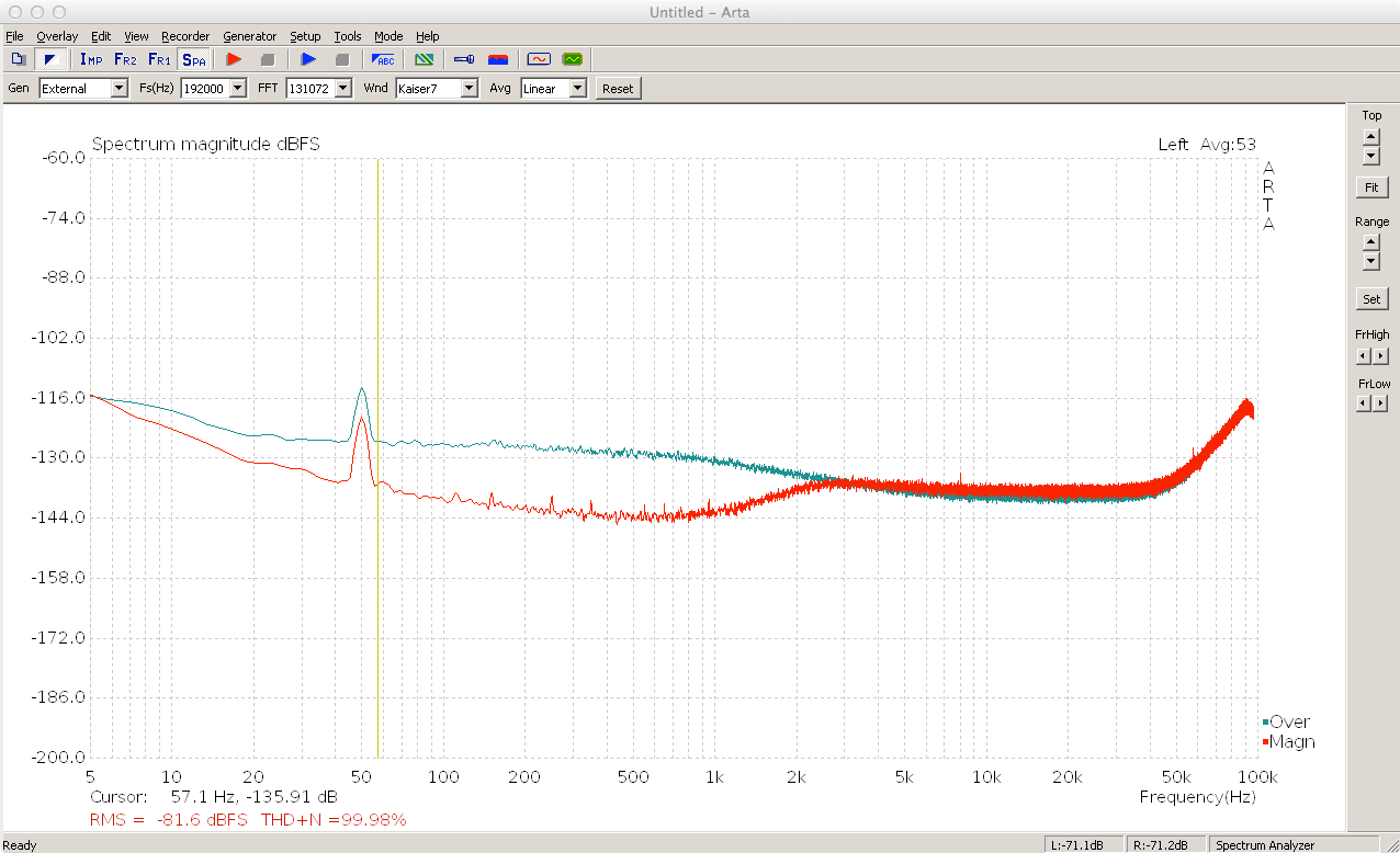

zfe: thanks for the excellent graphs. Seems stock+1000 and Factory Mod + 1000 is not much different. You get a slight bump with the stock +1000 but lower noise in the lower frequencies...
The main difference is the 1000Hz component itself, which is nearly 20 dB higher with the factory mod. The remaining is looking more alike.

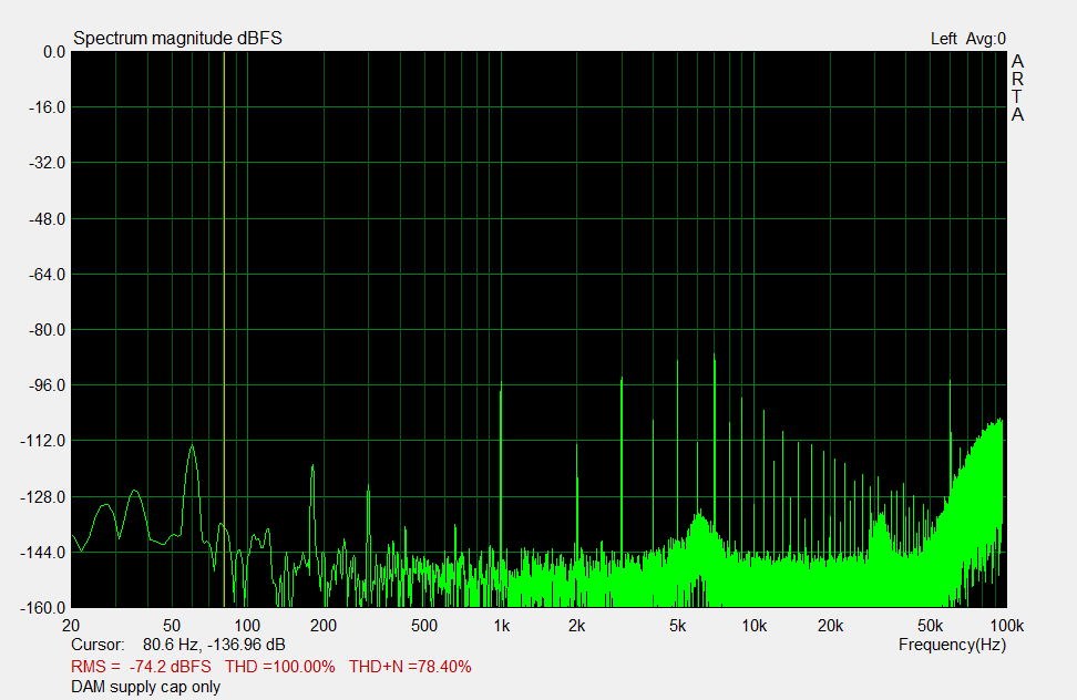

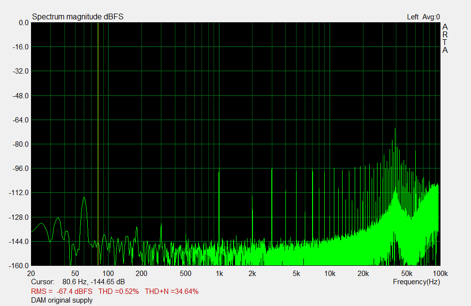

Some power line pollution. I'll try later if it gets lower if I supply the DAM with a regulated supply.why there is a strong peak of 50Hz?
It could be grounding issue.

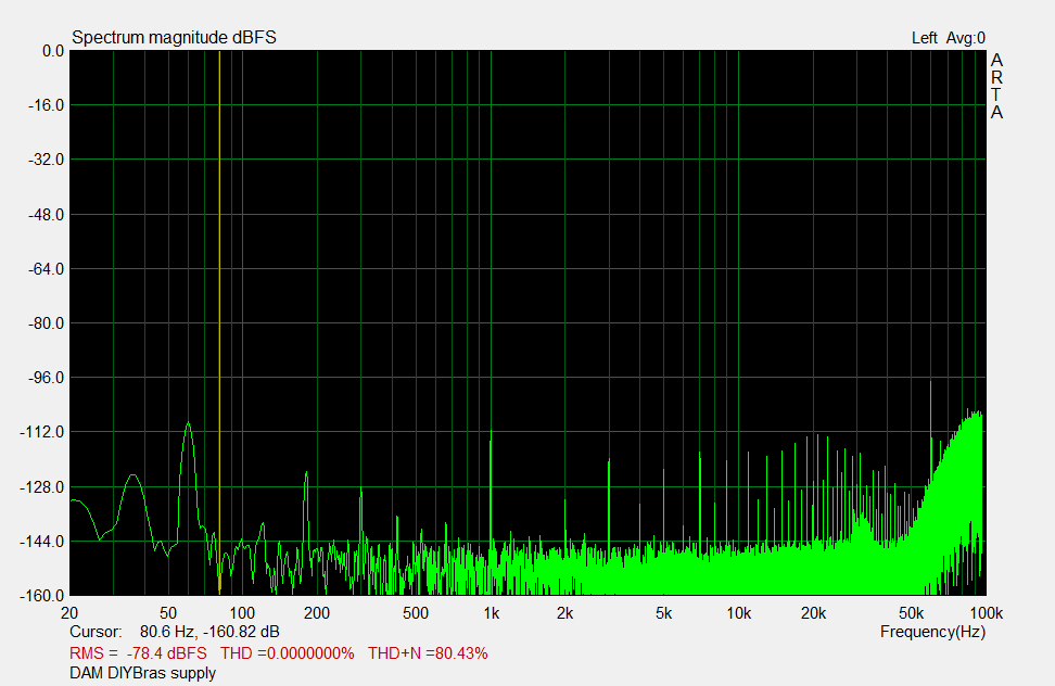

Because of that I was delaying my publication. My measurements are too poor, so I managed to improve my measurements, using best cables and battery in DAM (to avoid capacitive coupling the line/main source, now getting the DAM connected only to the PC). So I'll publish some results in the coming posts, starting with the "noise floor":It could be grounding issue.
The figures has title explaining, but I have to add: the decoupling in "DIYBras" and "only caps" tests are with 470µF x 16V Nichicon FP for each rail. The original are "raw", without cap or mods, of course. The 4V are BIG cap coupled directly to audio board (with R-Zener to protect against surges).
Note some low level 60Hz, like the 50Hz with zfe graphs; is very difficult to totally eliminate it.
The signal applied in DAm was 1kHz sinewave with 192kHz sample rate input.

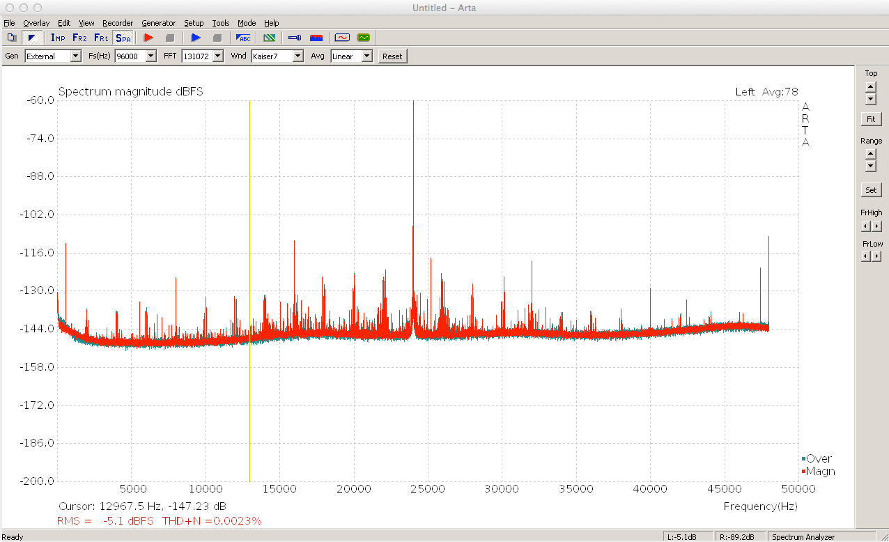

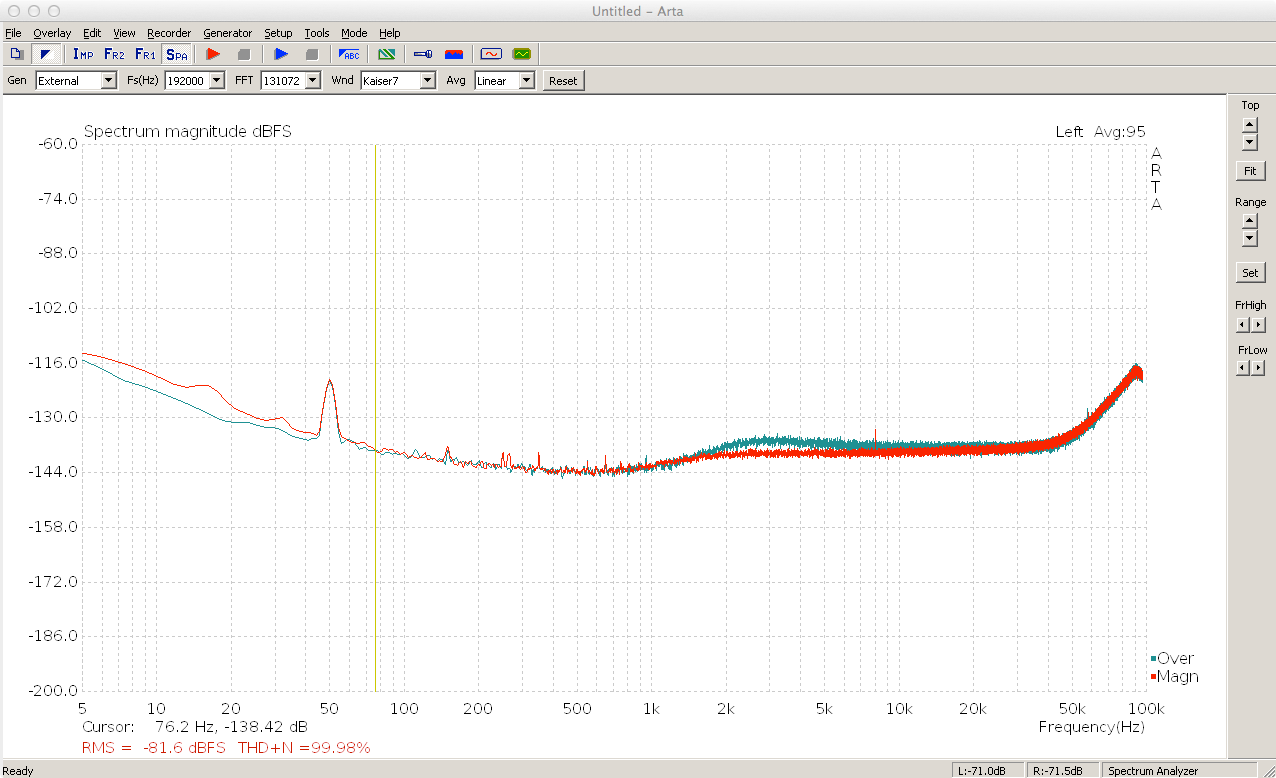

A warning concerning my sound card measurements: My Fireface 800 seems to have a "jitter problem". Signals ~120 dB below the main peak can result from this, and are not necessarily from the source. So this affects mainly audio-out measurements of full level test tones.
Details: I got not as clean graphs as Paul after modification and looked for the reason.
Here e.g. a 24kHz -1 dB test signal
The symmetric pattern around the min peak is typical for jitter. Following Julian Dunn [1] this would result from about 50ps jitter modulated by a 2kHz (next to square) wave.
This jitter could either be caused by the DAC or the ADC. The DAM should not have that much jitter (and I tested with an other DAC where I get a similar picture), so it is from the ADC.
[1] Julian Dunn: Audio Precision Application Note 5, Measurement Techniques for Digital Audio page 21-22
http://www.ap.com/download/file/17

After some major hesitation I removed the 0.1 Ohm resistors again (whose installing costed me some gray hair)
Again white noise playing.
a) stock +2700uF (red) over factory mod +1000uF (green)
Now the bump of the "stock" version is gone and it is more or less always better.
b) increasing the additional capacity gives only slight improvements
stock +6800uF (red) over stock +2700uF (green).
The caps are electrolytic 16V Panasonic FM. I did not see much difference in the plots for different type electrolytics of the same capacity. The polymers have not yet arrived.
