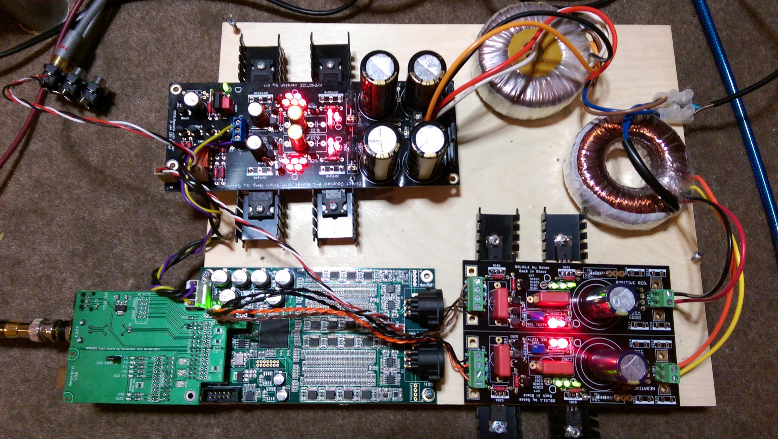

I have, within the last few weeks, finally finished my nige2000 based supply for my computer transport and the difference is quite staggering. nige2000 is on to something. Ignore it if you wish but it is an elegantly simple way to get great performance by using those batteries as ultimate PS caps.
I have yet to install this into my SOEKRIS - did not realize until after I ordered 9 volts regulators and then discovered, with the removal of the 5 volts regs, that I need to use 5 volts regs to float the input batteries.. These are on the way and then I can do exactly what I outlined.

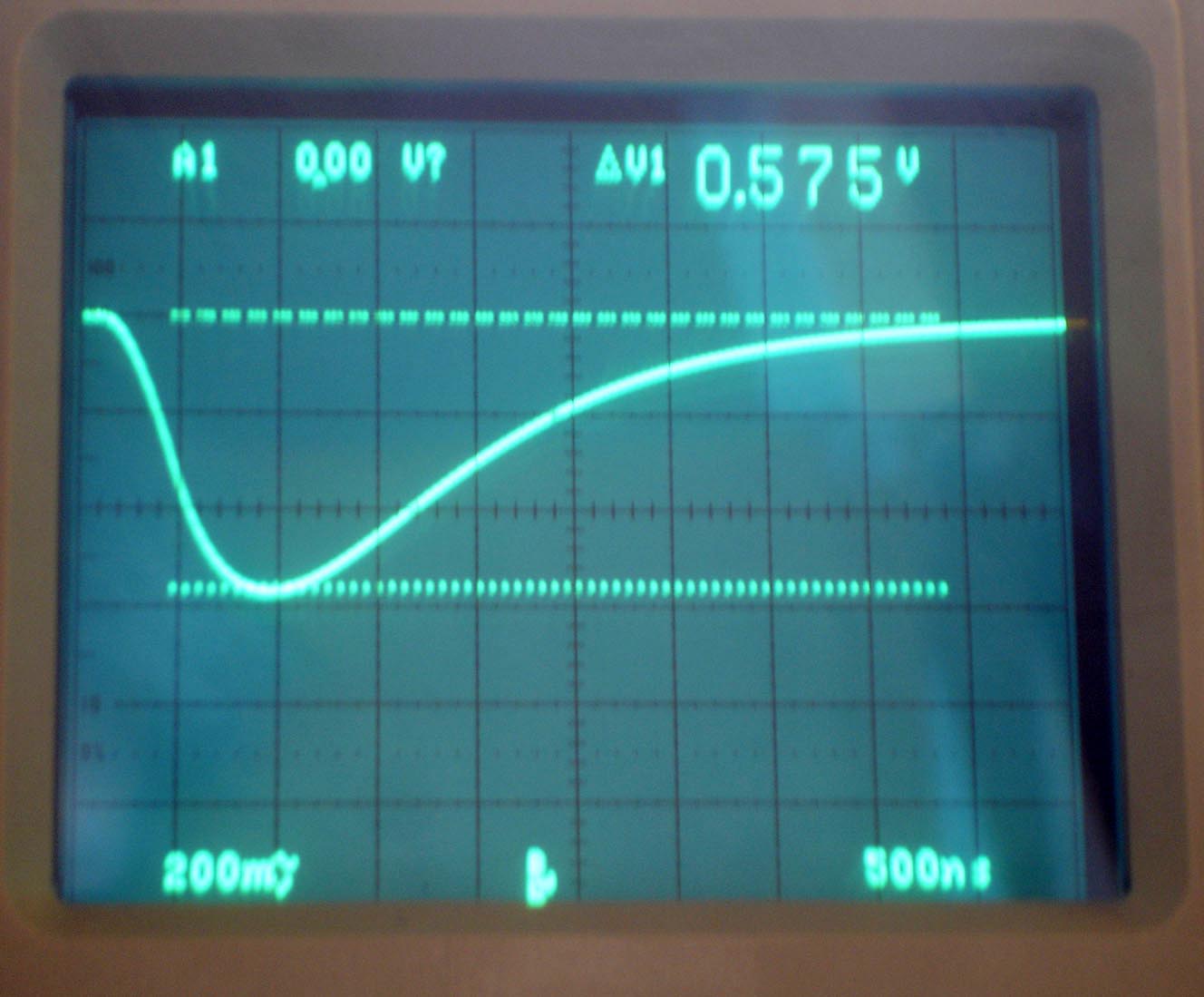

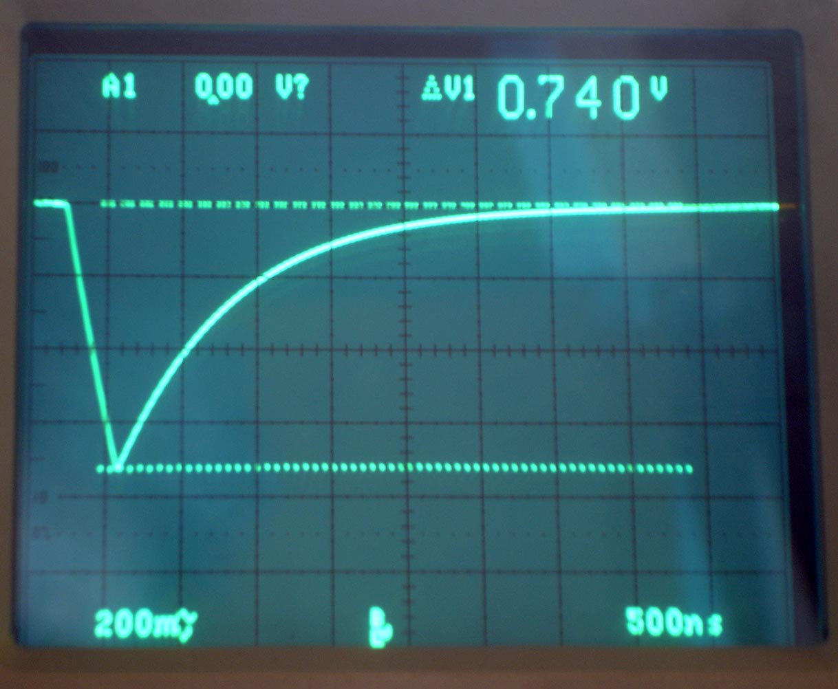

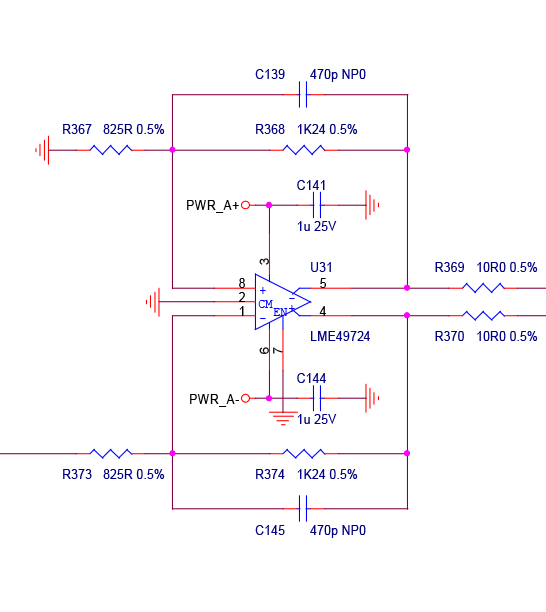

Looking at the schematics, I now think that the difference of the a 1/(64*44100)s pulse at the SE resp balanced output:
is not mainly due to the op amps, but due to the capacitor in the feedback loop of the LME49724
(detail taken from here)
The output buffers are not the secret sauce, so here they are....
View attachment 488435 View attachment 488436
Hey Zfe, what is your actual test there? Running a step function through to see the output stage's ability to handle falling edge/rising edge?
And if I'm interpreting the graphs and your conclusion - there's a bit of a slope (roundness) instead of clean rising/falling edges indicating some sort of capacitance charge effect?
It is a FS,-FS,FS,... signal with FIR1,FIR2 set to bypass, so you expect (if there were no further components after the DAC ladder) a 1/(64*44100)s rectangular pulse (followed by 63/(64*44100)s 0V).Hey Zfe, what is your actual test there? Running a step function through to see the output stage's ability to handle falling edge/rising edge?
The first picture is from the SE output. You charge/discharge the 1200pF capacitor of the analog filter, you measure exactly what the textbook predicts.
The second picture is measured after the op amps + to gnd.
