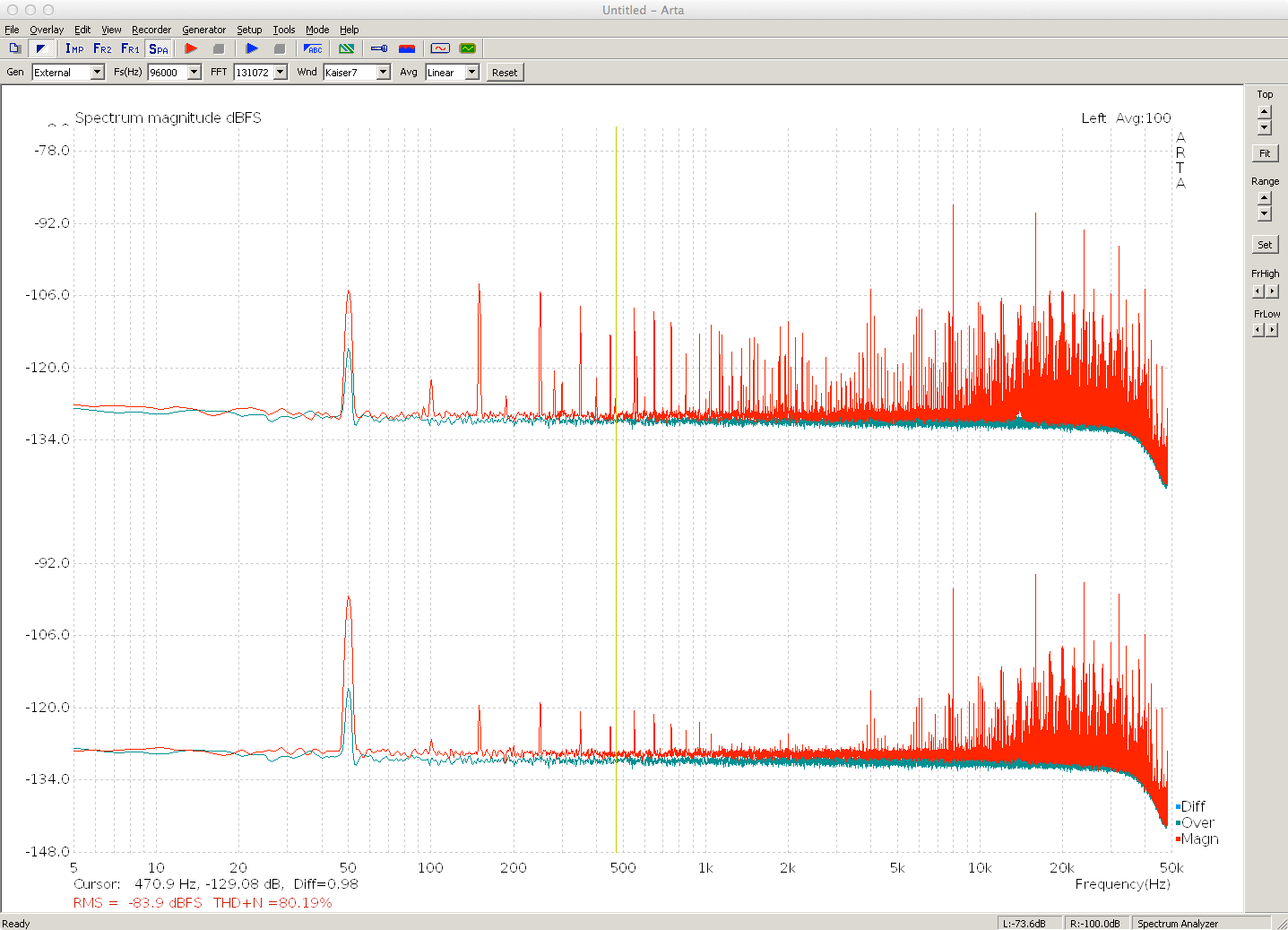

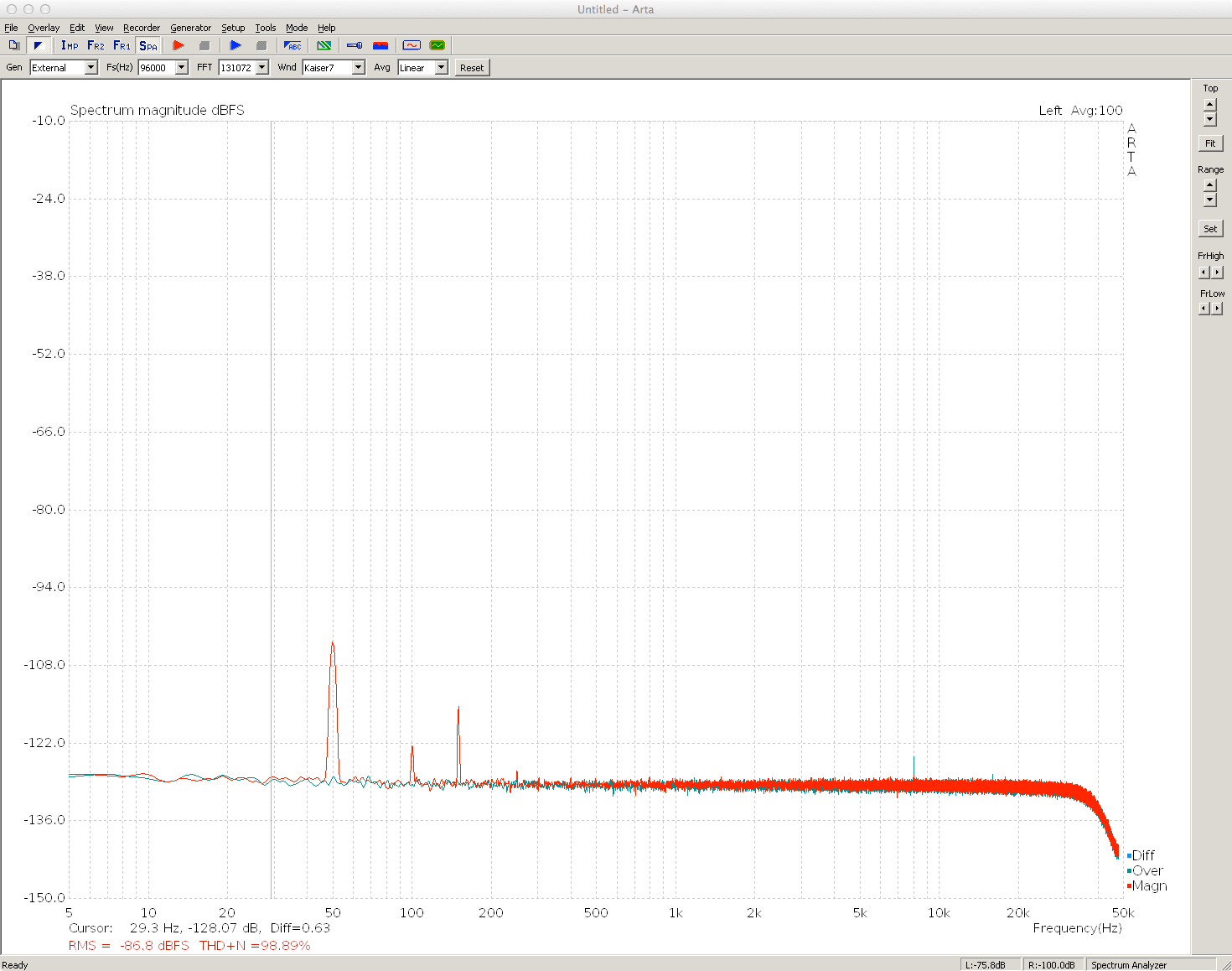

I did a few more measurements ... some new insight on the peak around 39kHz.
I supplied a balanced mono signal 1kHz, 24bit, fs=384kHz, from the raw output (by inverting the signal on one channel) to a balanced input of a Fireface 800.
The main change in the setup, compared to my last measurements, is that I now used a screened balanced cable directly connected to the raw output header, instead of using two chinch cables from the SE out in an chinch-stereo-TRS-adapter. I also connected, with an separate wire, the Fireface and DAM chassis, which removes the 50 Hz spike from the Fireface noise floor, which was visible otherwise when the DAM was powered on (even when not connected).
As result, the noise floor of the RME, with input shorted, is nearly identical to the measurement with the DAM, connected, with no signal played, except of a small 50Hz spike and harmonics.
The first picture is a overlay of the noise floor (green) and the DAM with no signal (red) with 27dB analog gain at the input of the ADC. The second the same in the old setup ;)
Using other gain or the fixed gain inputs of the Fireface results also in identical noise floors except the 50 Hz spike.

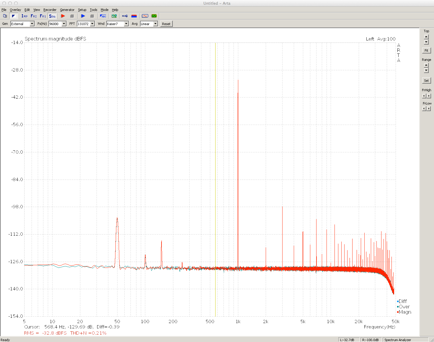

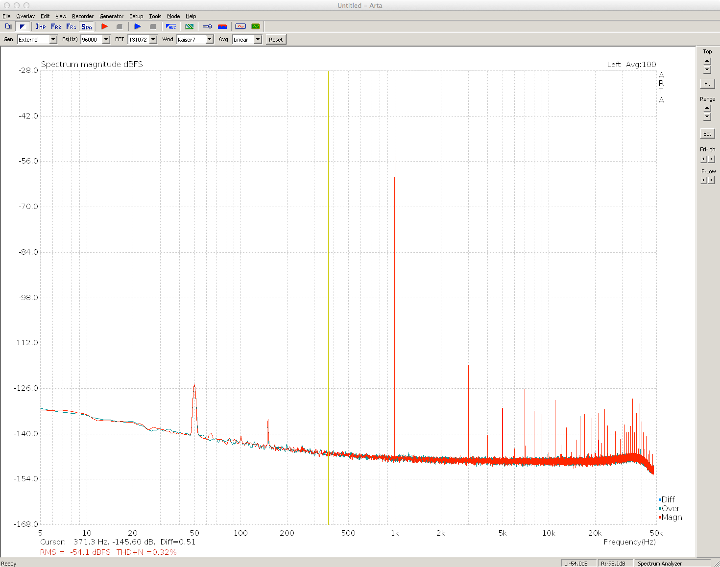

Next a -60 dB signal over the no-sigal floor ... only harmonics of the 1kHz appear, :)
First picture with 27bB analog gain. Second, same input, gain adjusted, such the 60db spike is at 60dB. Third with the fixed gain inputs.

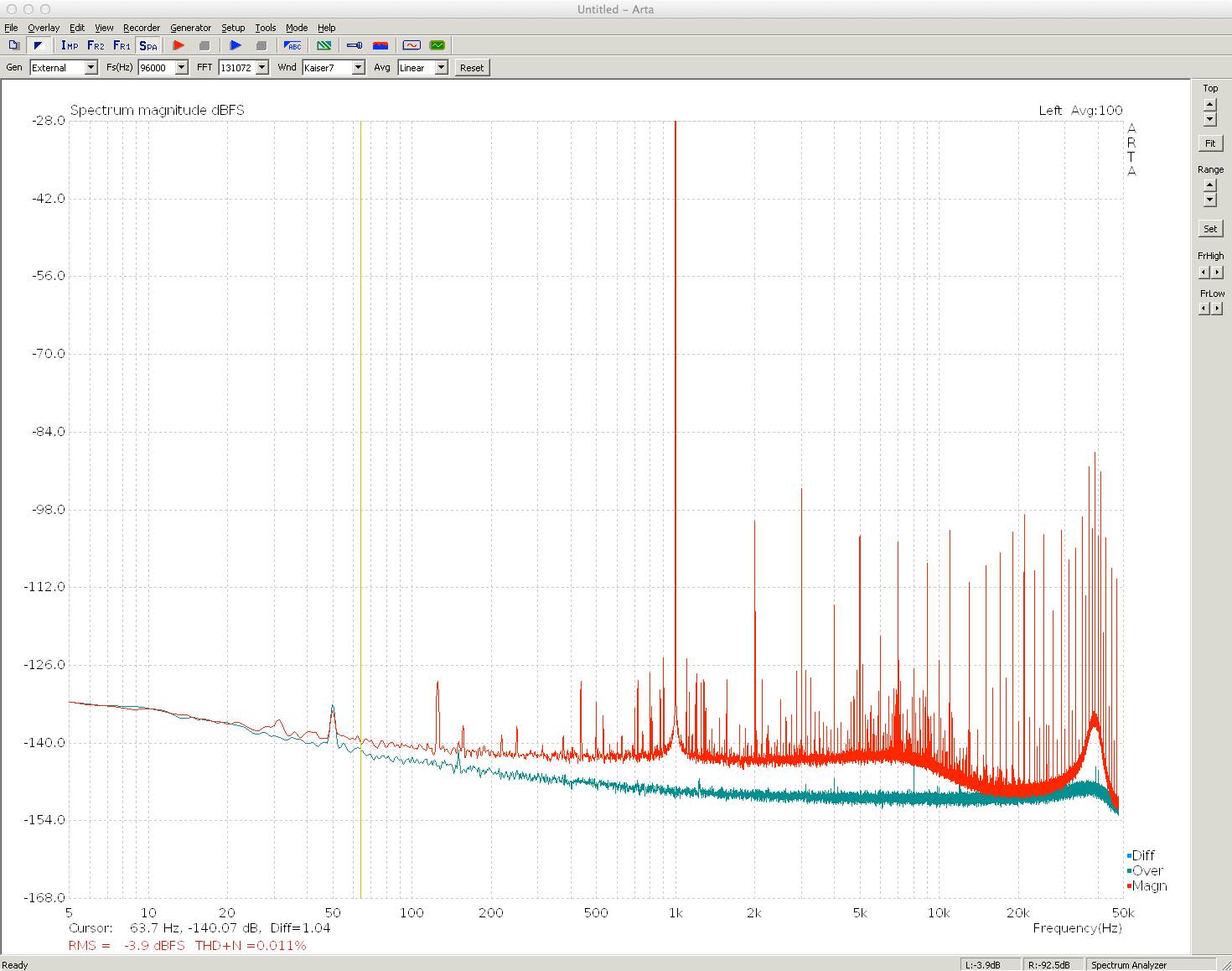

Next a -1 dB signal on the fixed inputs over the corresponding noise floor.

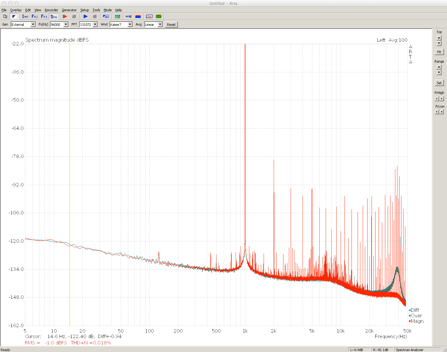

This was with a dithered signal (green in the next picture), with an undithered signal (red) the peak at 39kHz is gone (no idea why). This does not change with different FIR2 filters.
P.S.
Notice that for the -1dB signal, the dithering reduces the even harmonics:
....... dithered, undithered
2nd: -97dB ......... -77dB
3rd:. -91dB ......... -91 dB
(you need to add 3dB to the graph readings, the -1dB peak is displayed at -4dB).
Dithering removes the quantization induced part of the harmonics, so something like that was to be expected. I only did not notice it before as I mainly measured lower level signals before, e.g for the -60dB signal dithering makes no noticeable difference.

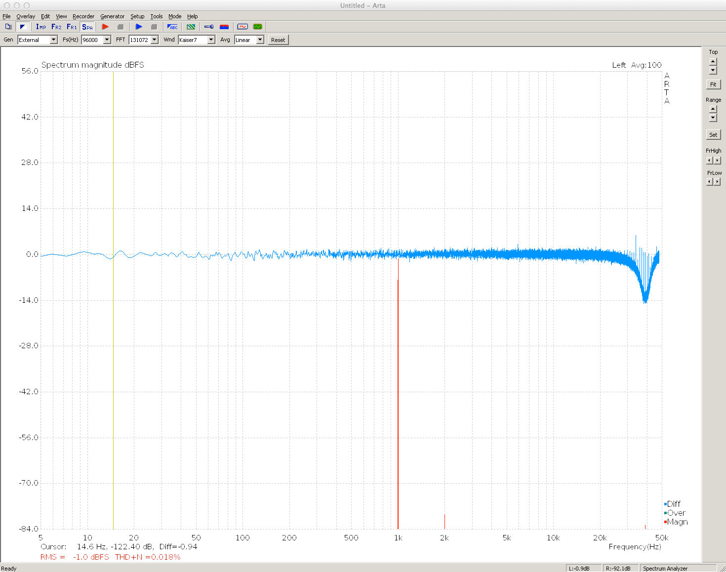

P.S.
Notice that for the -1dB signal, the dithering reduces the even harmonics:...
I made an error here, by looking at graphs from different measurements (the dithered over noise is from the fixed inputs and the dither non-dither overlay is from the variable inputs).
Lokking at the difference of dithered and non-dithered (from the same input) shows that the differnce is essentially only that 39 kHz peaked hump - no change in the harmonics.
May you provide 2 individual plots one with dither and undither. While the graphs are over painted...:D
For my understanding, all gain alternation requires a proper dither otherwise artifacts will be present..
