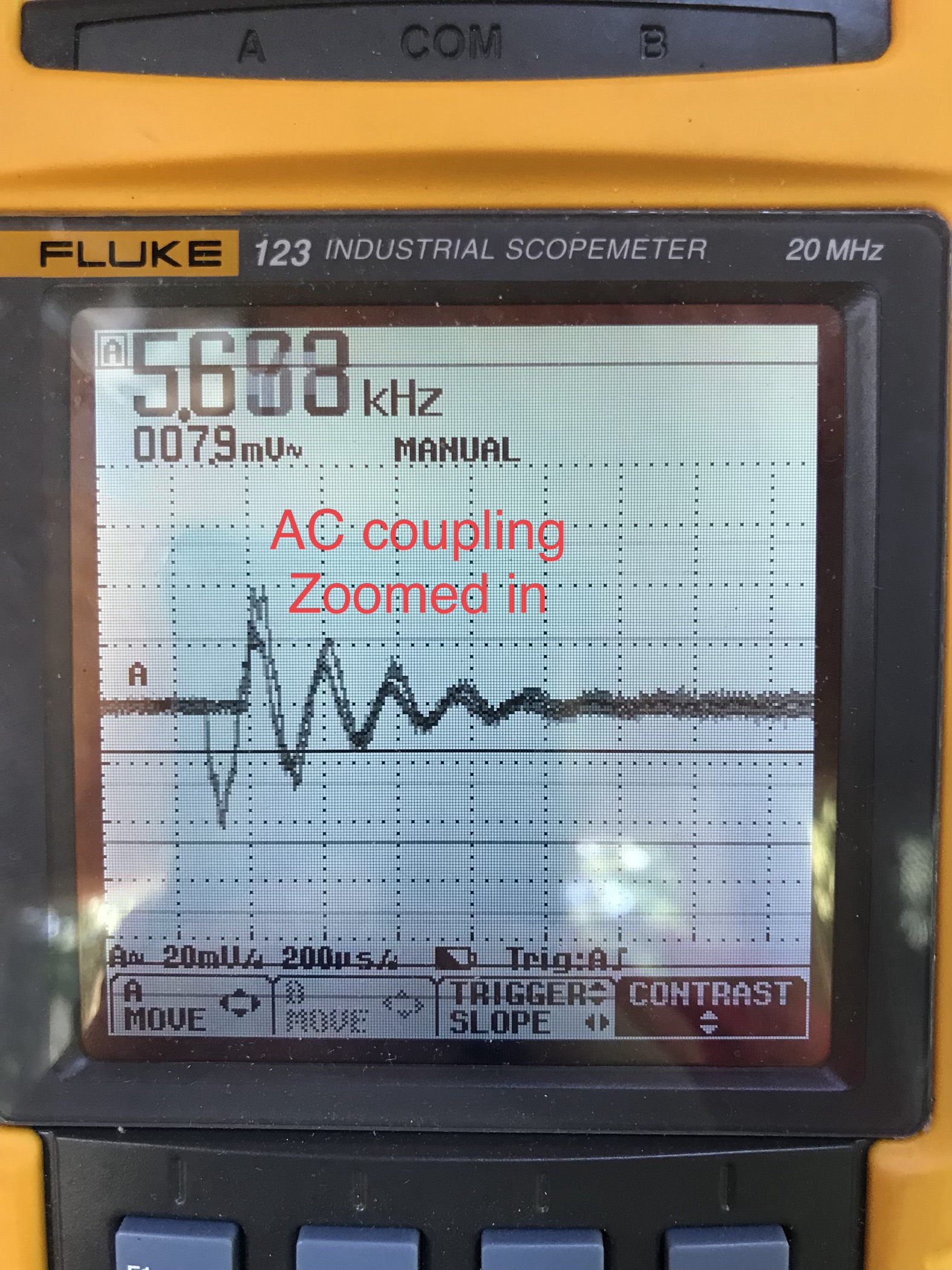

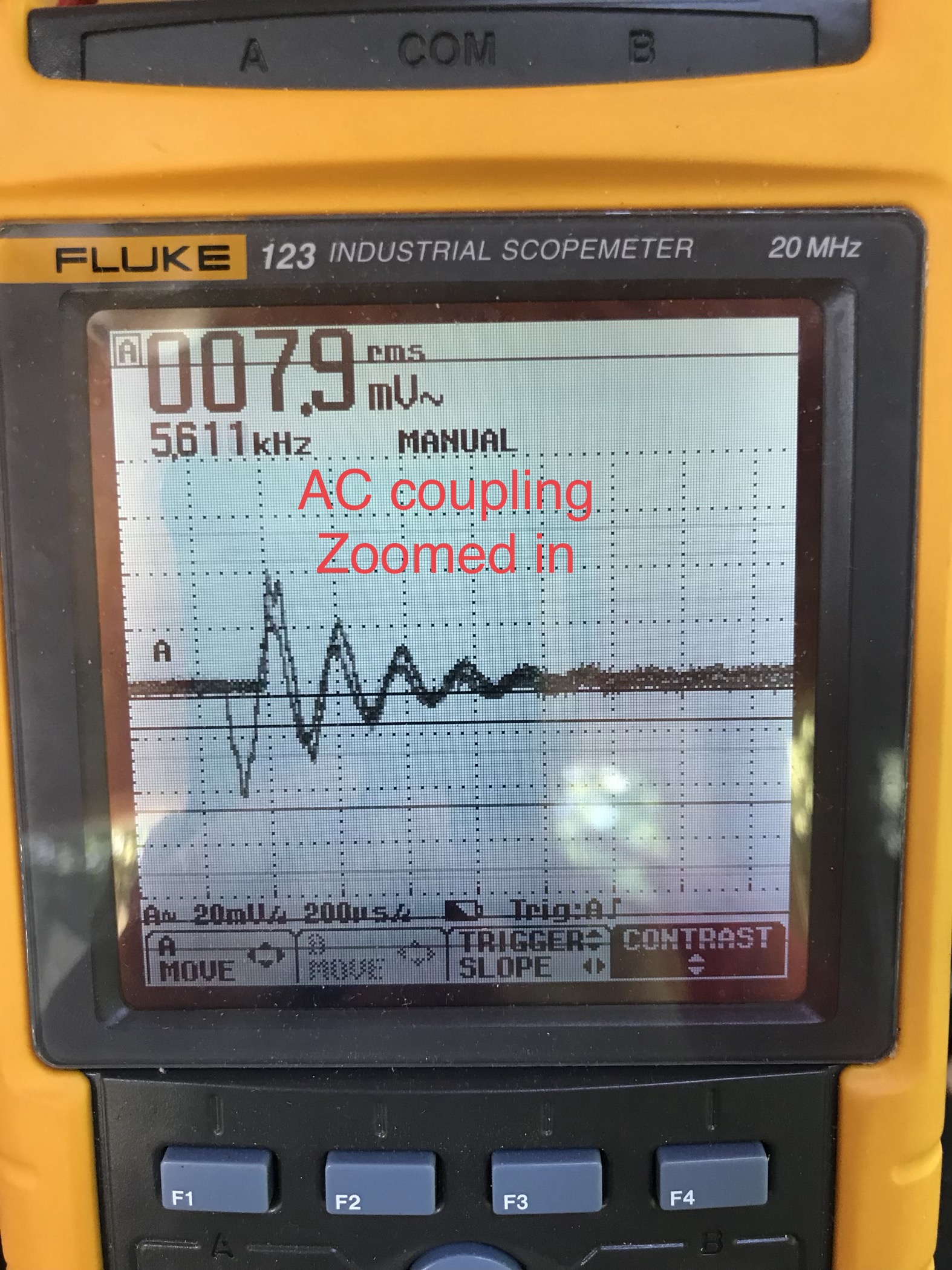

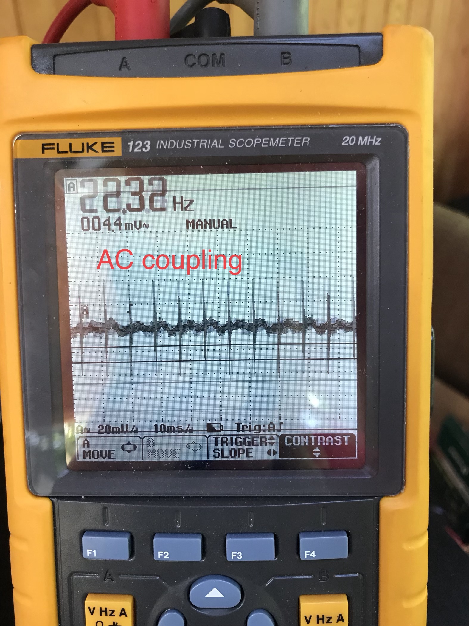

Here are some readings taken at the 4R tap when warmed up, with a 4R dummy load and the input grounded.
The dark horizontal likes are dead pixels. My scope needs a new screen.

What I do not understand is how to describe the traces other than 'ringing'. Is it 20 -22 Hz or 5.6kHz ringing?
I guess there is something oscillating and sorry to go this way again, but most likely is the NFB loop. (The only time I have seen a trace remotely like that was when someone forgot to connect the output transformer output ground to ground, but did connect the loop to the first stage...)

Now we may be starting to get somewhere in determining what the problem is.
Those 5 kHz dampened oscillations are happening at about an 8ms rate (120Hz full wave ripple rate).
Because it happens With negative feedback,
And because it Also happens Without negative feedback,
It appears that you have some kind of marginal instability.
The ripple rate appears to be triggering that instability.
Perhaps a fast rise transient current in the B+ circuits.
The instability could be caused by:
A ground loop.
Wiring dress.
A plate wire coming near an earlier stage grid wire
A 'push' plate lead coming near a 'pull' grid wire.
What B+ rectifier diodes are you using?
What is their peak reverse voltage rating?
What is the B+ secondary voltage rating?
What is the resistor value that is across each diode?
What is the capacitor capacitance and voltage rating that is across each diode.
I do not like rectifier diodes in a series string.
I do not like RC networks across each diode in a series string.
I bet you are getting some nasty transients from that power supply because of that.
And fast rise transients can cause problems, through ground loops, and current loops, and launching out into the chassis. Combine those transients with a marginal stability, and you might be getting what you got.
