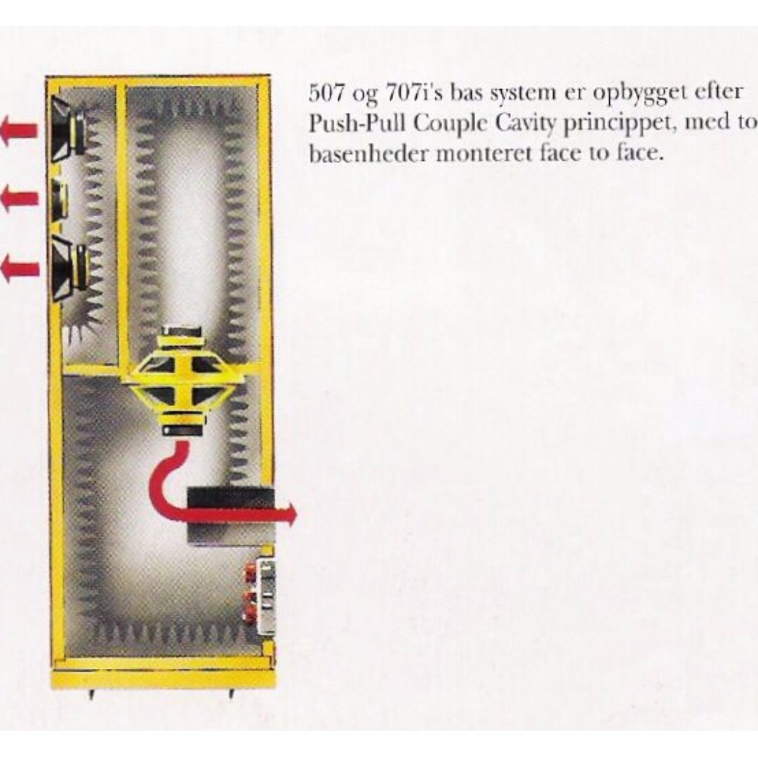

Not sure where we are up to with this now. I was reading a review of the Jamo which describes it has having a single tweeter, two 4.5" mid units handling 150Hz to 3kHz and then two internal 6.5" bass units in push pull. So five drive units all together.

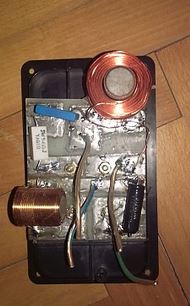

I think you should concentrate on fixing the fault rather than wondering about swapping all the caps.
In your diagram, C1, C2 and C3 are effectively shorting the amplifier input, so that isn't correct. The tweeter part looks feasible.
Jamo 507 Floor standing speakers review, test, price
Are we talking about the last drawing? I added a coil between C1 and C2//C3 that I missed the previous time (the post right above yours). The wrong schematic is the post before that.
I agree we should be replacing C4 first, before I potentially complicate the problem.
I don't have a pair of suitably sized cap at the moment to replace, I do have a bunch of single caps. So I crocodile clipped a 2.7uF across C4 to increase the total capacitance, the volume of both sides playing pink noise are now much closer to equal. When I unclipped the extra capacitor the volume decreased again. So I'm guessing that solder blobbed cap does have reduced capacitance.

Being bi-wireable and seperable, this second-order CRL tweeter circuit is very easy to test on tweeter output alone even without basic tools and testing gear. Of course, a fault in the bass or mid section could have tonal effects, but we have eliminated those, I hope.
Let's move on to basic techniques here. You'll make your life easier by buying 250V MKP, which are much smaller than exotic types. Even so, they aren't tiny. That is a 250V 6.8uF MKP by the corner of the speaker below.
Modern lead-free (and flux-free) solder is tricky stuff. Clean surfaces help. You must tin your 40W iron the first time it warms up to avoid oxidising the tip. You must work fast (< 5 seconds) in getting the old one out and some long-nosed pliers will help.
Now clean up the PCB holes where the new 6.8uF cap is going. A solder-sucker can help too. Trim the wires so about 4mm is proud and solder decisively and fast. It takes practice really.
Coils and resistors are very tough with heat, capacitors aren't. If it's not working after 5 seconds, stop applying heat and have another go when it has cooled down again.

I got a new multimeter. I never had a multimeter with capacitance measurement, or a Fluke for that matter. Yay for affordable Chinese manufacturing. So just for academic curiosity...
Capacitor from the good speaker.
Capacitor from the bad speaker.
If I had this the debate on the source of problem wouldn't be necessary. Now everyone is Sherlock Holmes.
HaHa, I must be psychic! That isn't 6.8uF! It's explaining exactly the lack of tweeter output.
650778d1513081782-recap-img_0269-jpg
Clarity is everything!
It's the purest guess, but if that solder blob has melted its way into the foil laminates, the capacitor must be suspect. I'd replace it.
FWIW, you should measure about 0.3 ohm across the tweeter coils.
We got there in the end. No problem too big or small here. Just for interest, I'd dig that solder out and see if things look better. :cool:
To my surprise, the solder didn't really enter the surface. So makes no difference to the capacitance measurement.
