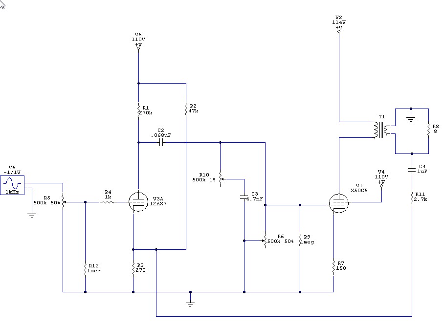

The input filter was most likely to compensate the frequency responce of the phono head so it wouldnt be needed here. The balance pot is fine if you add a 1meg resistor from the 50C5's grids to ground to ensure they have a ground connection should the pot go open.
Now looking at the voltages, the 50C5's are well within what would be expected,but, something is off with the 12AX7. If I read correctly your getting .6 volts at the cathode and 3.6 and 4 volts at the grids which is definitly not correct. If you have another 12AX7 try swapping them to see if things change dramatically, if not, then there may be an issue with grounding at the volume pot.

Correction... the 6.6v cathode is teh 50C5,,,,, teh 12AX7 Cathode is .63, both pins 3 & 8.....the plate of teh 50C5's is 114.5v ,, after i replaced teh filter resistor and installed a big cap..
Well neg. voltage on the grid is better than pos. as far as the tube's health is concerned,however, there should not be any change in voltage as the pot is rotated. Try removing the volume pot and using a fixed resistor divider, say two 220k, one from grid to ground and one from grid to input if your source doesnt have a volume control, otherwise just the one from grid to ground with input directly to grid if your source has a volume control. Also check to make sure your source has no dc at it's output as well.
If by source you mean tape deck/cd player,,, I just read the output jacks on the tape deck, and get -1to-4VDC, fluctuating... I may have a meter issue, its a DMM with a new battery,, but maybe I should try to get another one and confirm teh readings...
With teh filter mods, I find I can go higher in volume before distortion , so I'm moving in teh right direction...
Also, I noticed two 68K resistors that haven't been changed, (real hard to read on teh schem),,, They go from teh grid to teh volume wipers,,, seems like they are right where we're working...I don't have any 68K on hand, but, I have 100K or 56K, If you think either of those will work...If not, Ill pick some up....

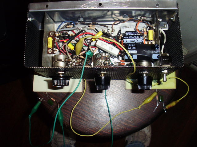

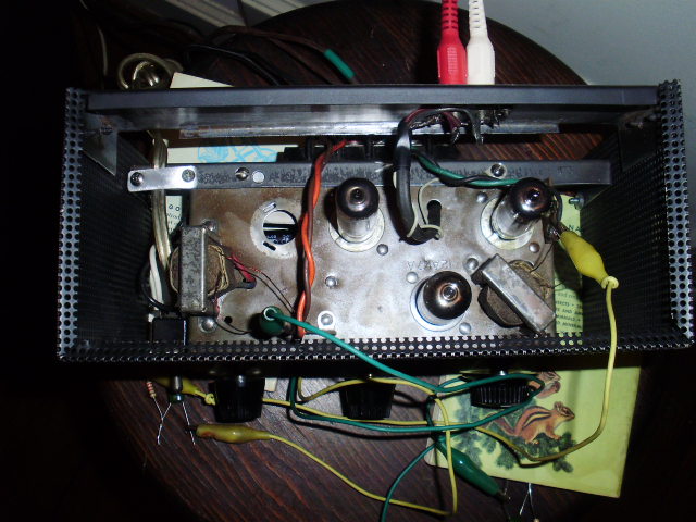

Had some time this afternoon, I replaced teh 68K's, removed teh bypass caps and put the 1M bleeders on teh grids...
I have teh bypass loop clipped in,,, started with teh values on teh schematic, and have 2uF/2.2K running now,,, these sound pretty good, smooth transition between highs and lows...and, as you expected the distortion is nil... The grids read about 0v, and teh outputs 113.5-114v,,, so, it seems its pretty close to specs, even with all teh mods...
Heres a pic of the latest version,,, not much more room!!!

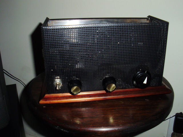

Distortion is nil... that is nice to know you got this amp to where it ought to be.
And excellent job on following all the instructions that the tube amp experts here threw at you without too much guidance (I wouldn't have been able to tackle something like this over such a short span of time without many MS Paint hand drawn pictures and a step by step). These guys here are probably some of the best on the internet.
Three questions for you... are you going to leave this as is at this point? Now, only if it is easily accessed, what does the tube side of this 50 year old amp look like? And since you are bit by the tube bug, what is the next project going to be?
