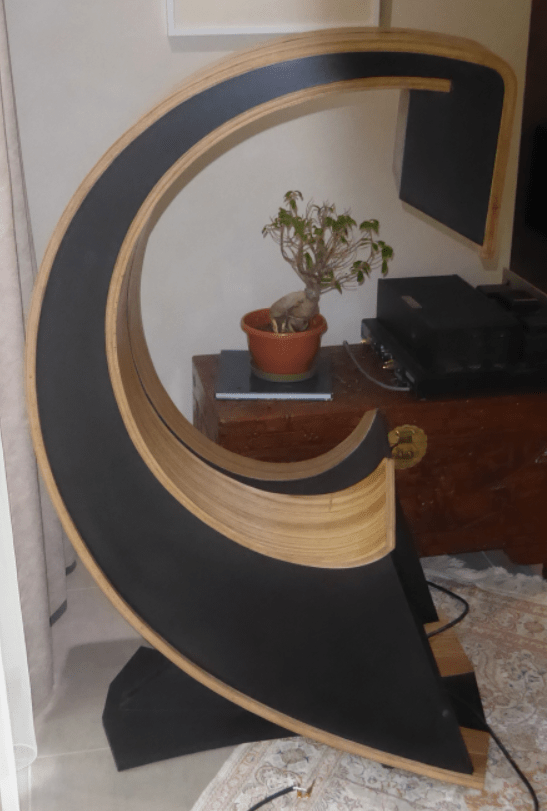

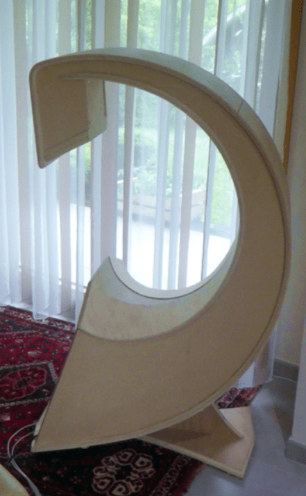

Yes, it is possible - here are my personal design and experimentations :
Here's the most compact : the Micro-Ripole...
I'd say that the problem for me was to find a "serious" super-compact subwoofer module, and I find none with a valuable LPF really adjustable in FC and Slope...
The one that I used had unefficient LPF that completely ruined the performance of my small 2x5" and 2x7" Omega Ripoles :
This is a pity, because while connected to the "serious" ATOHM S250 sub module that I use on my Omega Ripole 2x12", the 5" and 7" models worked amazingly...
Below my 2x12 version, able to reach 15Hz (low resonant frequency measured). I usually set the LPF module at 40Hz / 12dB/Oct. or 24dB/Oct. , just to operate under the natural lowcut of the loudspeakers associated with. For example, with my Magnepan SMGb, 40Hz / 12dB/Oct. is fine, just for providing that deep, floating infra-bass extension that notably exist in Space Ambient EM...
The 2x5" showed an extension to 25Hz (FS), which is a performance for such a compact subwoofer :
That said, even with a competent sub module + performant LPF, don't expect to reproduce HT earthquakes with such a small unit !
The infra-bass extension in compact size has a price to pay, and concerning the Ripole principle, it's reduced efficiency (usually 6 to 10dB/W/m under the nominal efficiency of the speaker), and that's the main reason why the Ripoles are often built with 12", 15" or 18" speakers, in order to combine super low extension with power handling and efficiency...

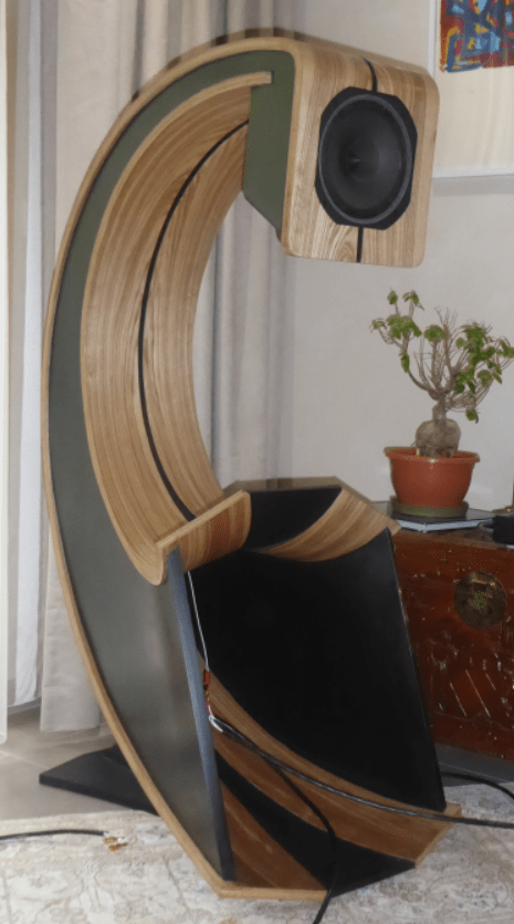

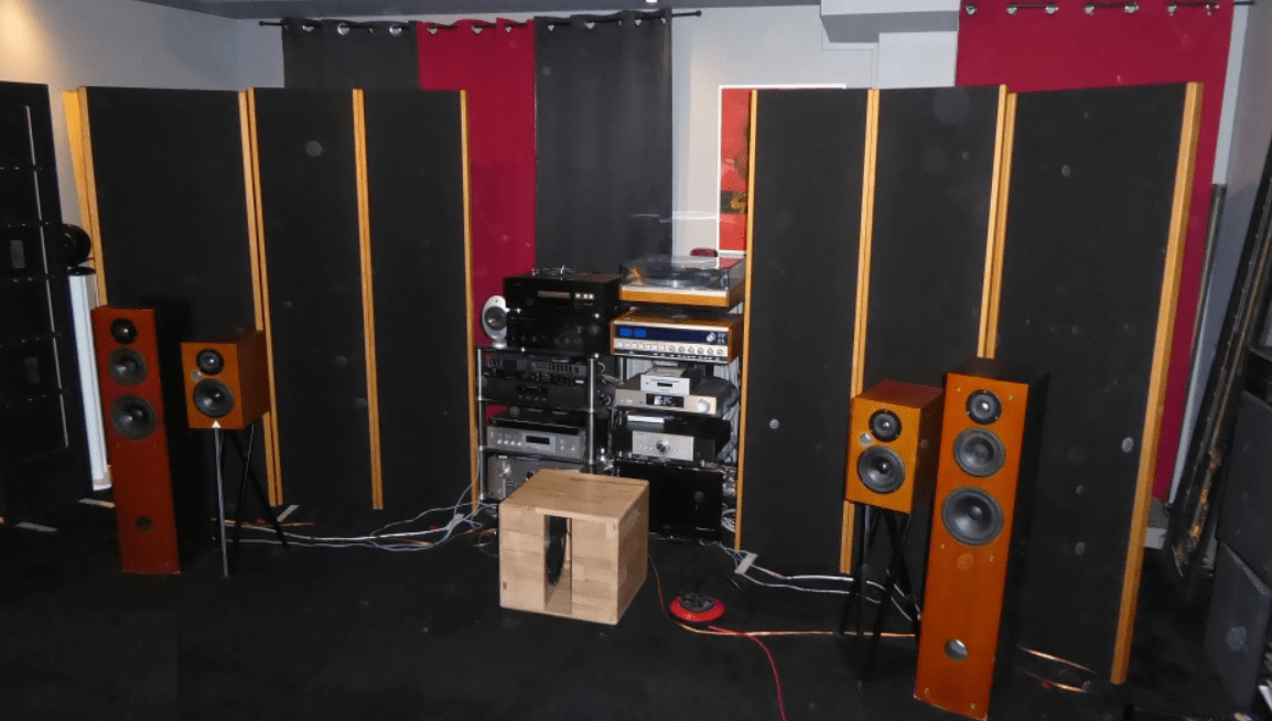

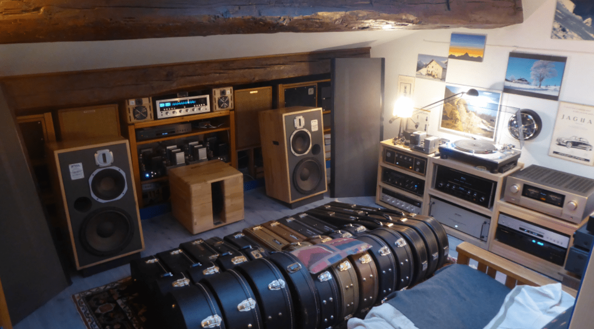

Below, you can see my Omega Ripole 2x12" centered between the speakers :
I first borrowed to my Audio friends some Bass-Reflex and ASW subwoofers from different brands : Klipsch, Celestion, Magnat... To have an idea about what to hear. All of them worked OK, adding bass level as expected, but it was not so deep and infra-bass extended without having to endure some boomy-boxy sound... Which was not so pleasant to my ears. I had the impression that it was the price to pay...
Then after reading the litterature on the Ripole subject, from Axel Ridtahler (the father of the Ripole principle) and several web pages, notably this one :
http://jazzman-esl-page.blogspot.com/2011/01/ripole-subs-are-underway.html
I decided to venture in, and the result was my Omega Ripole 2x12", a personal variant of the Ripole principle, in order to integrate the subwoofer module in the cabinet. Immediately, the results were convincing - I knew where to wait, as I had several subs for tests...
The most obvious - not to say amazing for the size of the unit - compared to the other subs I tested, is that impression of deep, floating infra-bass, without that boxy-boomy sound masking the low-end range, plus a fast transient response (attack / decay) and clarity allowing to hear the note's sound imprint, level and separation.
According to Mr Ridtahler, the coverage pattern of the Ripole is some kind of assymetric 8 : the larger lobe being at the front, with a spread angle at circa 90° (+/-45° from axis), the smaller being at the back, just to balance the directivity of the front.
This present the advantage - still according to Axel Ridtahler - of absence of room excitation on the lateral sides (180°, +/-90° from axis) by reduction of the bass amplitude in these areas, an useful point for placing turntables and electronics, which will be "substracted" from the infra-bass influence.
I think this answers to your first question concerning the tone of a Ripole...

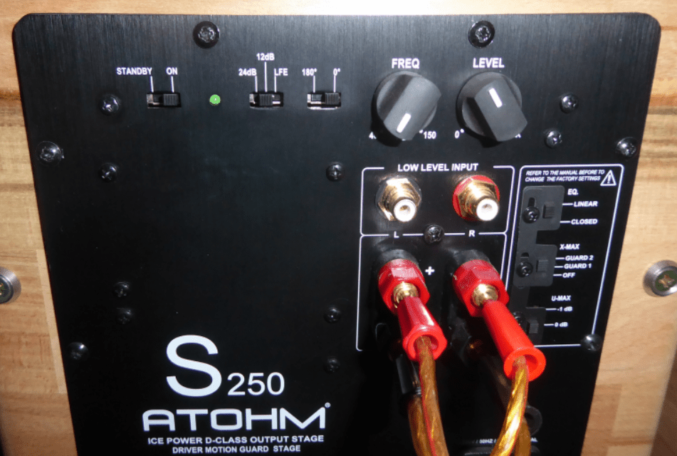

About the level and setup of the subwoofer module :
Consider that usually, a Ripole shows an efficiency at circa 6 to 10dB under the nominal efficiency of the speaker. It depends on the number of speakers (one, two, or several), and on the size of the front and back openings.
With only one speaker, small cabinet and small openings, you have a lower infra-bass extension, but indeed closer to a -10dB attenuation. Conversely, with two speakers and matching openings, you are circa a -6dB attenuation. This will be compensated by the gain control and available power of the subwoofer module - assuming it has a convenient performance LPF, of course.
For example, here is the setup I use on my Omega Ripole 2x12" with my Magnepan SMGb driven by my McIntosh MC7100 :
But this compensation has a limit : the power handling of the speaker(s) and - most of all - the Xmax and Xdamage. The Beyma 12BR70 that I use in my Omega Ripole 2x12" offer a 94dB/W/m, a Xmax at +/-8mm, and a FS at 28Hz and 29Hz respectively (measured), with a QTS at 0.5.
With such arrangement, and in a 400x400x440mm format, I reach a 15Hz low extension, with circa 88dB/W/m, which is way enough for me : at 20WRMS in the 0-40Hz range delivered by the module to the spakers, the sub already reach 101dB/W/m... But OK : for Home Theater of huge systems, this may be not enough !

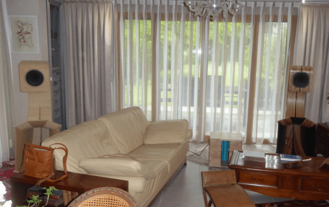

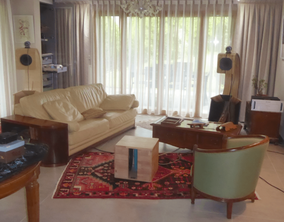

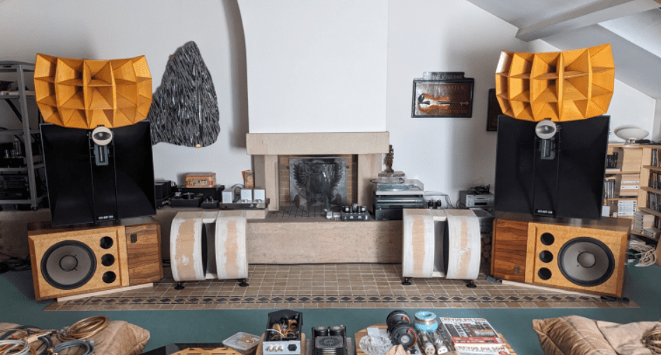

Today, I went at one of my Audio friend's house to experiment my Omega Ripole with his DIY horns, to see if the Ripole could do his job of bringing the infra-bass complement...
We tested two positions :
N°1 - In the plan of the two horns, unfortunately not centered, due to furniture position :
N°2 - Then more advanced in the room :
As pointed by @planet10 : more critical to marry with horns... At least, more difficult to place than with a pair of Magnepan speakers (SMGb, MG2.5, MG3.5, etc...), which are dipole speakers.
The better position was the N°2, advanced close to the center of the room, to achieve that floating infra-bass tone filling gently the room. We even had the impression that the extra-bass was provided by the horns themselves, possibly due to the position of the Ripole, its radiation pattern, and the size / geometry of the room...
My friend find that it was an interesting addition to his horns for the image and the ambience, but a 2x15" version would be a safer plus, due to the large size of the room.
Verdict : yes, it works with horns, but it is more touchy to set up than with dipole speakers (Electrostatics, Magneplanars, Open Baffle).

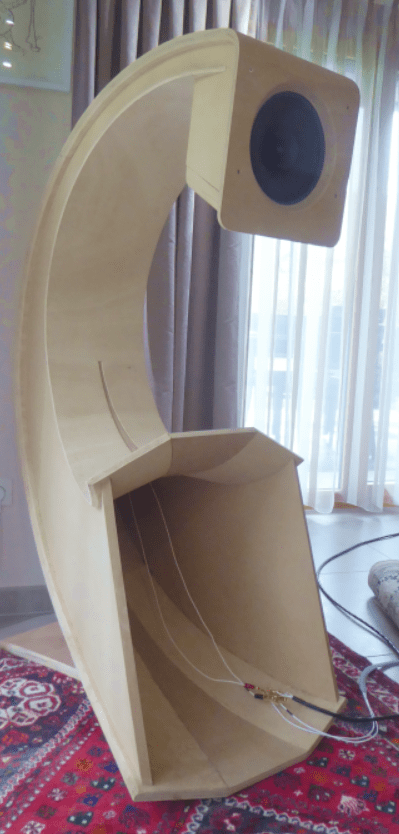

Wow, those horns are beautiful! As a cabinetmaker myself, I can appreciate the considerable skill that goes into such joinery. Well done!
Your impression that the added bass seemed to come from the horns themselves is proof of a successful integration. Perhaps some phase delay might've rectified the placement problem? What crossover/slope was used?
