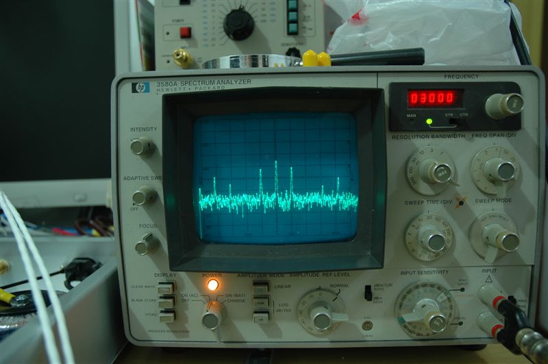

I scan my 3 chips on hand KY / Japan K / Taiwan K and they all looks the same! Sound wise the Taiwan K is definitely not as good as the other two.
I use a Digital Signal Generator, not a CD player + test disc. The model is Leader 1507A. It has 1khz at 0db, -20, -40, -60, -80 dbfs.
I scan from 2.5k to 3.5khz frequency and the harmonics of all 3 chips look very similar. Here is one picture.
Centre freq = 3khz;
Span from 2.5 to 3.5kHz;
Sensitivity = -70db (0db line on top)
Vertical = 10db/div

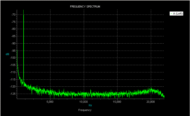

So, I tried to repeat the tests of Bernhard.
Sidenote: I don't know how Bernhard tested his chips, my results are quite different..
I have here a pair of original PCM63P- K-s in my Tent Dac, bought many years ago, for sure before the craze started.
And a Rotel RCD990 cd player, with Standard! PCM63P-s inside. Though as You will see, I'm quite sure that those were non-K but factory selected pairs - they measure better than my K-s! Would not be a miracle, as that player was Rotel's flagship model at the time.
Finally, a pair of PCM58P -s, for comparison, from an Onkyo DX5700 (another flagship model).
So, I'm looking forward to the Y grade test of B_D! I'm quite sure that the difference should show up.
Soundwise: the Tentdac is best, the Onkyo is second (just a little bit) and the Rotel, which measures best, is the far away third place..
So much about the importance of low level linearity..
Ciao, George

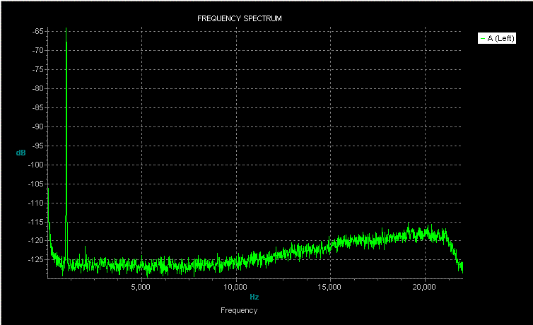

Here is the test of the Tent dac, -60dB NoiseShaped 1kHz signal, straight into the soundcard.

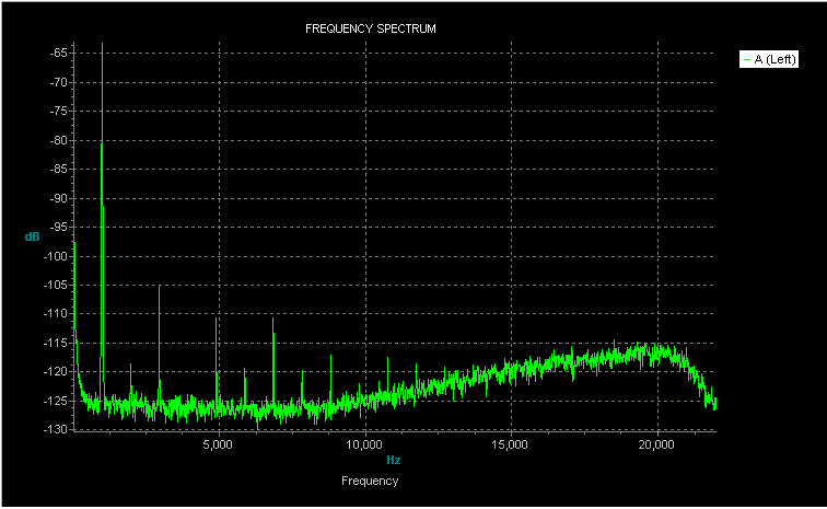

Doh, pardon me, Bernhard, after having had a better look, I think we are saying the same - Your only Kgrade chip shown seems to be the same like mines - harmonics below the -120dB level. Though the K2-s measured by You were worse - maybe fakes also?
And if the measurement of Spencer is right, then his Y grade looks much more ugly..
I have a pair of "real" no-grade PCM63P-s, too. will measure them as well.

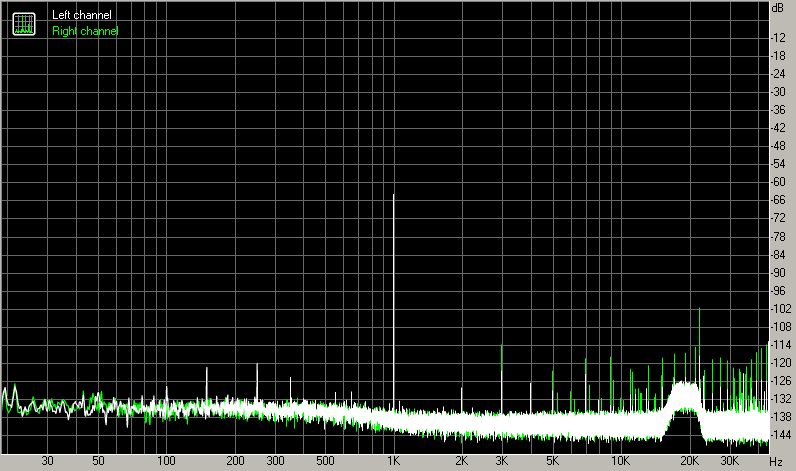

OK this is my effort at capturing the Y's
RMAA is showing levels 4dB lower than what the audio editor on the Mac was indicating, so add 4dB to the scale reading for more sane results.
991hz test tone, MBIT+ dithering on CDR -> TEAC T1 -> 4 x "Y" D1V3 -> HDP2 88Khz/24bit -> RMAA "analyze file"

Paul, if your “Y”s (as well as my own ones) are counterfeits (very probably), then it is quite a outstanding plagiarism achievement... By the way, your Left Channel measurements 991Hz to 20KHz doesn’t look worth then the excellent Tent DAC scoped picture, includes the 3K and 6-7K areas. Moreover, if I am not wrong, the measurements here are much depended & corresponding to the implementation in the D1V3, CD transport, etc (or do I understand this wrong?).

I agree the left channel looks very good. But then the right channel looks to be 10dB worse on the third harmonic with lots of junk in the higher ranges. I really need to swap the chips channel for channel to confirm this isn't a fault with the D1V3. Ideally I need to test each chip individually in a single channel. I'm going on holidays for two weeks on Friday and doubt I'll have time to do this before I leave.
It's clearly possibly to make an almost identical optical copy of the wafer, so in theory the chips could perform to a similar level as a BB production run. But if the difference between channels I'm seeing hold true then that tends to confirm that these chips are completely unselected and you could get anything from a chip that fails to meet basic P grade specs to something that out performs a K grade chip. Problem is unless they are tested to separate the junk from the gold you'll be paying a premium price for a lucky dip.
It could be a nice opportunity - selling diyers hand matched DAC chips ;)
The testing is dependent on supporting components and method to a certain extent, so I'm not sure if you can directly compare between tests carried out by different individuals. There do seem to be general trends however.
