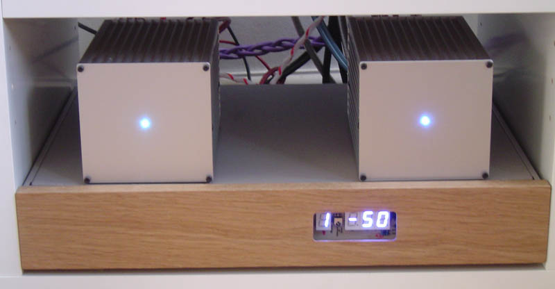

Hi just a quick note to say that i finally finished my preamp based on Carlos and Rudis work with the AD815.
Seeing as after initial testing i thought that the design was a keeper i spent a bit of time sorting out the casework and remote control setup.
It uses a remote control resistor ladder design and has also 4 remote controlled inputs all using relays. Great bit of kit from diyclub.biz.
I am loving it, here is the near finished unit (needs some smoked glass for the led window).
It sounds stunning and even the missues seems to approve, cant get better than that. My LM3886 chip amps are on top, to be honest i found they sounded better with them than the AMP3.
Needs more experiments however for the time being i am very happy.
(Did make the preamp modular though so different preamp moudles can be slotted in ;)
Thanks for all the help guys Rudi in particular with your excellent pcb layouts.
Phil

Hi Phil, top job mate:)
Is your only vol control via remote? Does that kit allow a pot or encoder to work also?
I'm guessing thats the v03 soshin kit. I wish there was more info on their website; seems interesting.
I got my 815 pre working a week or so back. Initially had dc problems; turned out I had a duff opa2134 in the servo:mad:
Spent ages trying to debug and tried the opamp last. Wotta plonker, should have done that first- thats what sockets are for!
Sounds great, and the servo takes care of all my dodgy sources:D
Hey float,
Yeah thats the one, I alos bough a 3310 to stick in one for the father in law, easy good enough for him.
I have tried diyclub stuff before, the documentation is usually nonexistant and the after sales something of a joke, the postage cost huge apart from that the lite audio board semm generally of a very high standard. The whole units work very well and looks pretty slick.
There is a option to put input and voulme button on the front but i quite like it ultra minimal like it is to be honest.
Yeah its a good sounding setup very happy, wethere I leave it be or keep tweaking cant tell at the moment. I awas thinking of doing a AWSR version but i need to get hold of some first or maybe a dual reg version. We'll see i love the setup but i like making the sutff more,
phil
The amp chassis came from conrad in europe. Couldnt find then on the english site but i ordered from germany. They were about 16 euros a peices, i have used then a lot for preamp, psu, they also do a half height that i have built an AMP3 and rehoused/tweak a SI in.
Lovely cases, thought the normal screw make then look cheap, i just ordered some hex bolts and they look much better.
The pre-amp chassis is a old network switch box gutted and with a piece of american oak as a face plate which my Dad cut and routered out the hole for me. Used a bit of Linseed oil to bring out the colour in the wood.
