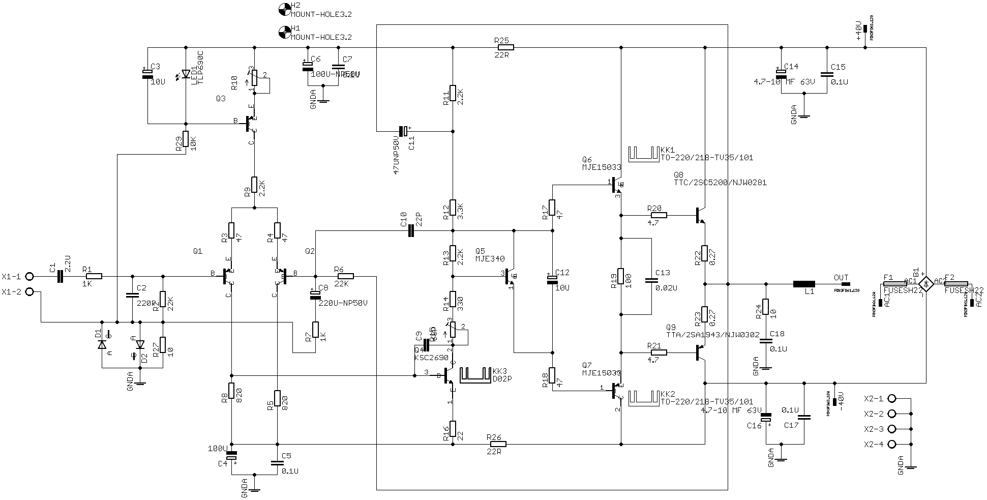

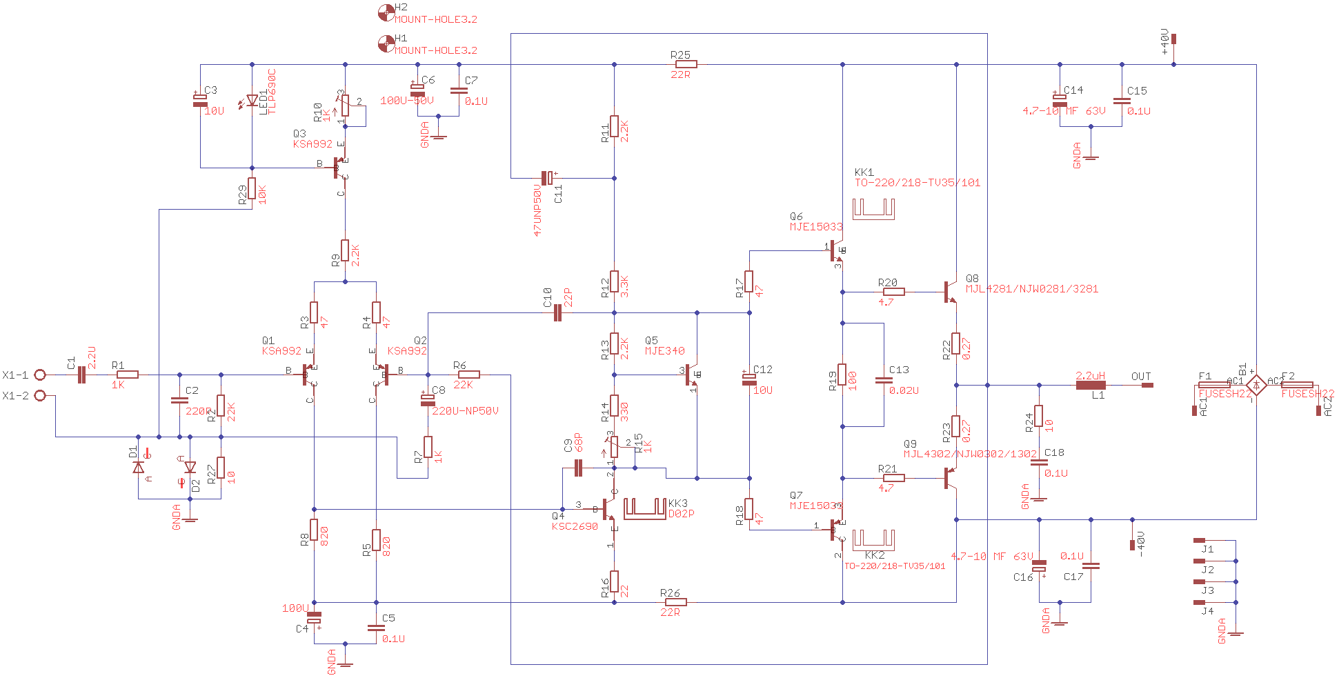

Hi All,
here is the layout I have come up with as a first pass. It follows exactly the layout by OS, but some modifications.
Changes:
1. Zobel ground was not connected in original (latest) layout by OS.
2. C12 was missing from the layout
3. i/p filter cap drawn separately.
4. incorporated ground lifting diodes at i/p
5. C13 drawn separately for convenience (mine)
The top layer(purple) traces can be wires /jumpers for single side PCB. min trace clearance >24 mils.
The layout can be further optimized/ miniaturized a bit, but I thought comments from people, especially the designer, OS would help in saving some labor:D. Hope he hasn't unsubscribed from this thread and can post some comments.

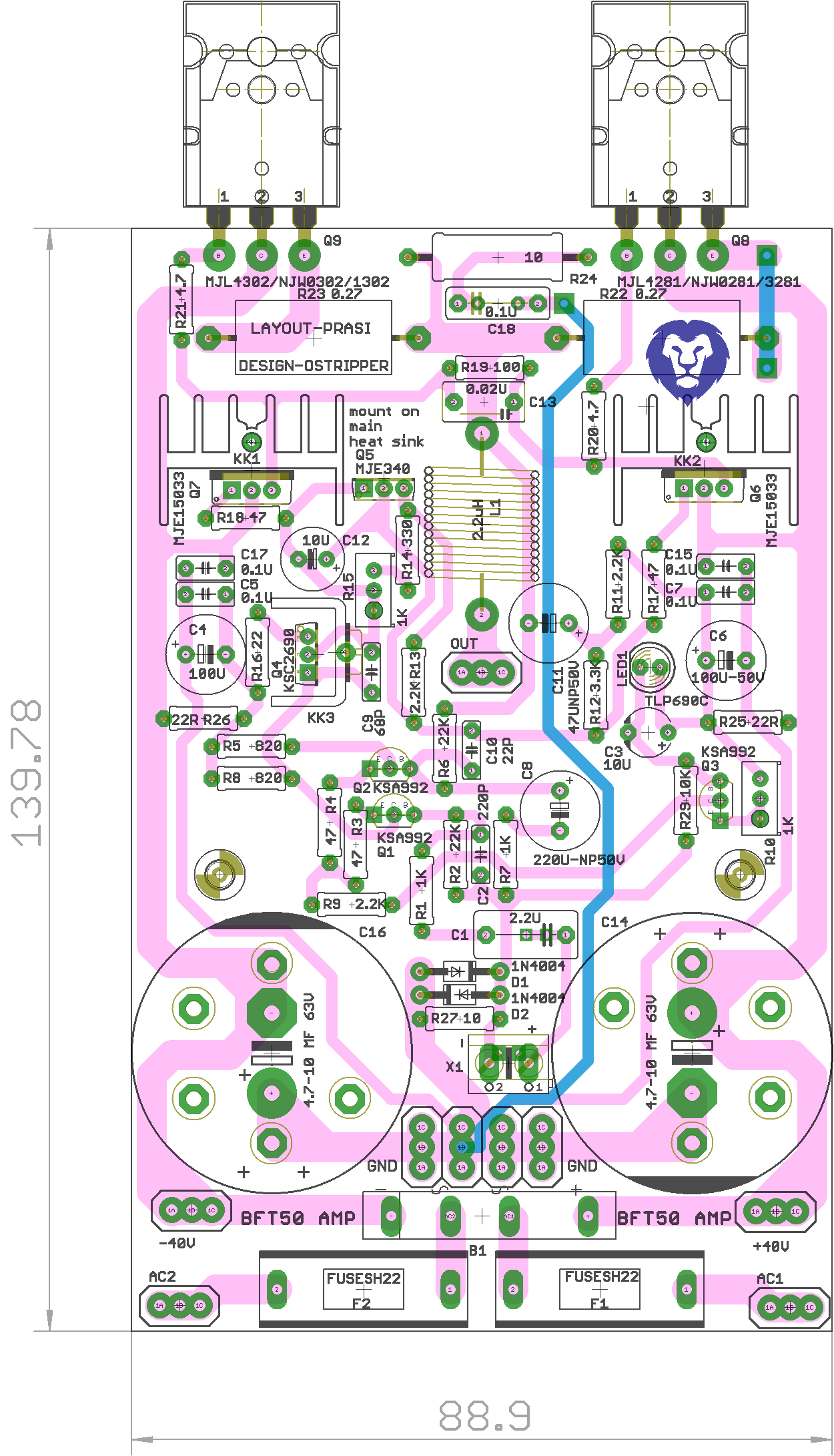

Here is what I could come up with quickly. Layout is totally based Ostripper's original layout, but slight modifications where I found convenient (to remove jumpers, etc).

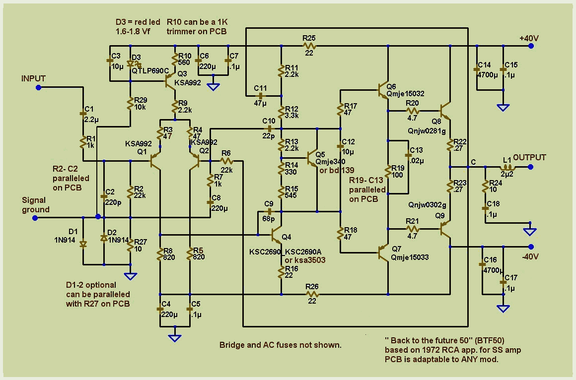

Hi Prasi,
I suspect both the circuitry and the PCB layout are lacking a junction from Q4's collector to Q5's emitter, don't they?

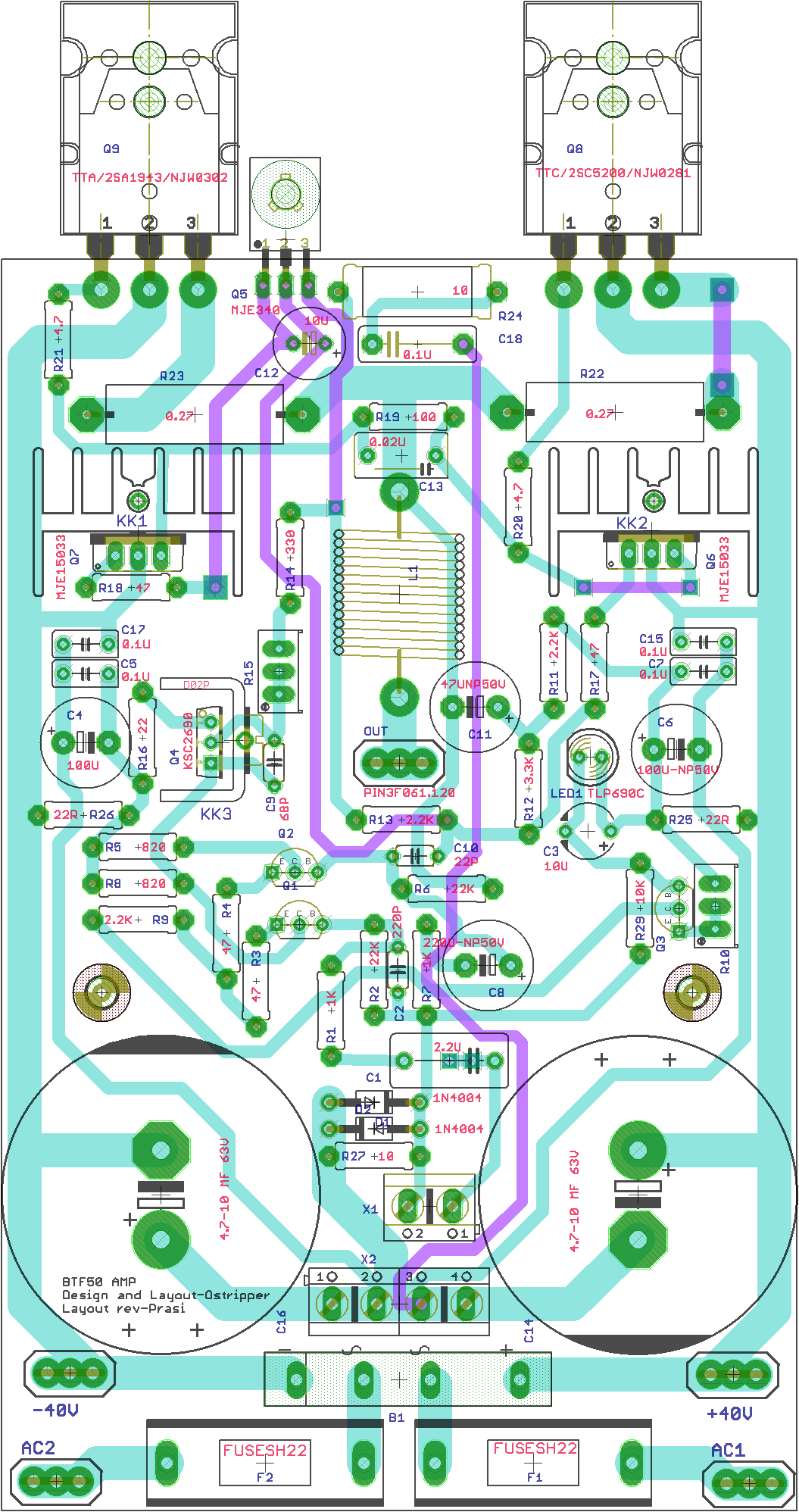

Hi Kay, I can only say this, what eyes you got!!! amazing.... Here is the revised artwork.
I am not sure of the answer to your question on 2N4348, may be someone else can answer.

Hi Prasi
R29 should return to main ground not signal ground.
Those drivers are very robust and suited to the task. The only time I have experienced cross-conduction was when using the speed up cap (C13). Personally I would get rid of it. You should be able to eliminate those output base stoppers if the layout is good. Provided the drivers are well heatsinked, you might increase the standing current further to 30mA (R19 = 47R).

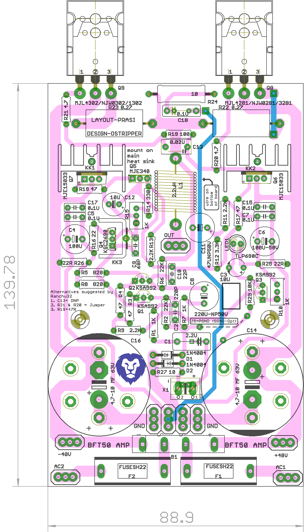

Hi Kay,
Posting herewith pdf for etching. All views from component side. Please tell me if you need anything different.
Also if you indeed build and test it, please share your impressions here.

Hi Christian,
Thank you for taking a look at this. I have incorporated your suggestions as options that one can try and see for himself.
Regarding return of R29, Ostripper had its return to the SGND in one the schematics i found on his website (attached). So I have kept the option of returning it to PGND as default or to SGND as option.
what about dividing R19 into two separate resistors about half the value each and referring their junction to the junction of R22 and R23?
