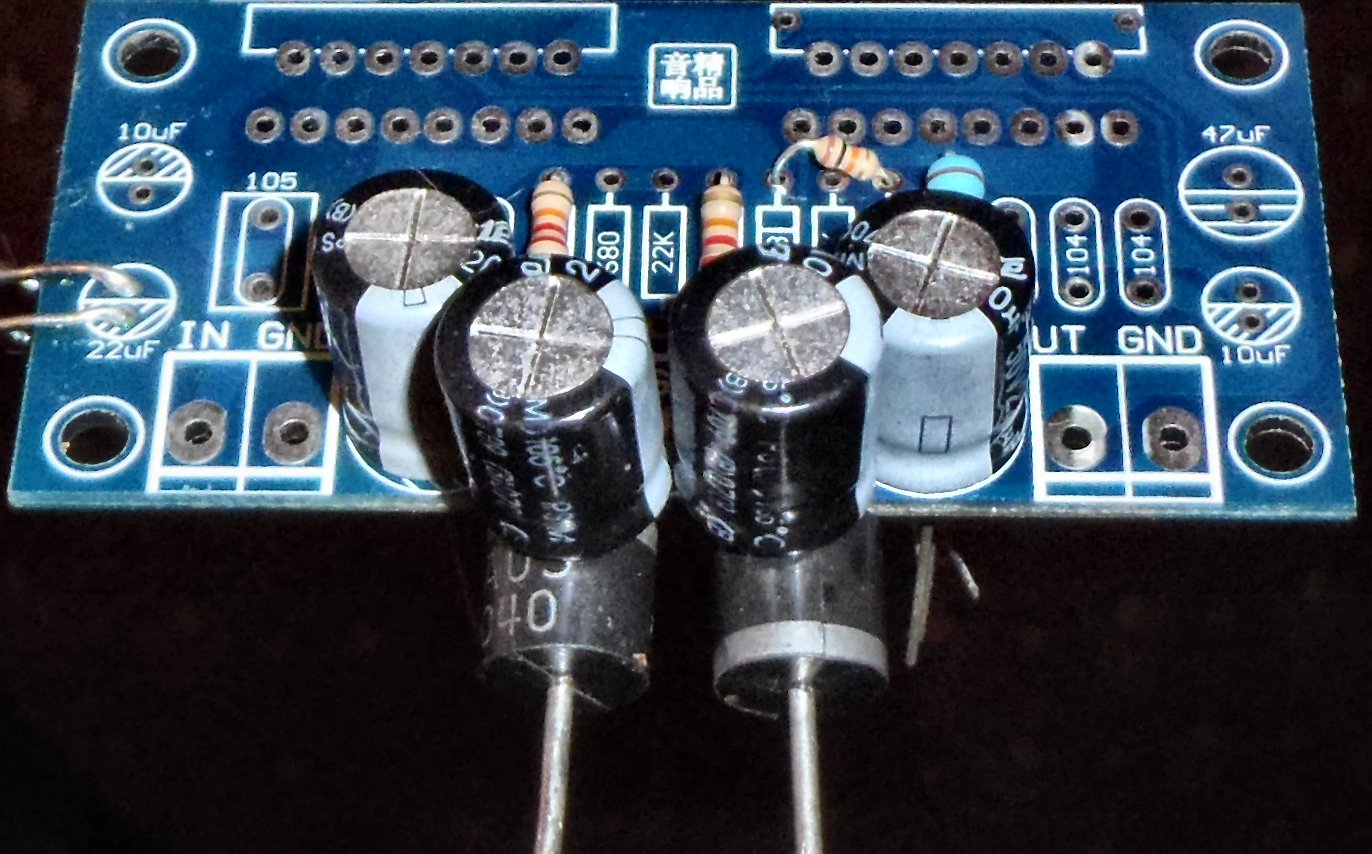

Looking recently for information to construct a simple set of amplifiers to complete my HTPC amp , I attempted to discuss the issue on the DX thread.
Since I was forced to modify the layout because of my application (stealth amp retrofit) , I could not use the DX board. I also have a surplus of 2sa992's , mje/ and other on- semi devices.
The amp in question was originally an RCA application note (1972)...
amplifiers
As most of us know , this is the "original" .. skillfully upgraded and modified by "uncle charlie" , aksa , and too many others to count.
Also very interesting is that on the other pages (link above), many of our DIY SS amps found their beginnings in these RCA designs.
This thread is to address ALL modifications that are possible to this simple topology (even minor ones). In other threads it was suggested
that the use of new high Ft devices would render both the sound and stability of this amp unusable AND that if a constructor does modifications,
strays from the path,or asks questions, they will learn nothing !! :confused:
I know this to be false , as many clones of the RCA exist of world class performance that DO use modern parts. (I already have 2 that are 1 year old :) )

The FINAL version with no errors.. (almost sure):
BTF50 (back to the future) is the name , since it uses the MJE's for drivers, one could use the MJL21193/4 and drive a sub with that one. Make 5 more with the $1.40 NJW's and stack all of them side by side for a dandy 5.1 HT setup. I KNOW they have good PSRR (have 2 already), so a single 25-0-25VAC 6-800VA trafo would do for all 6 channels.
[ ALL references to DX are removed ] I will begin to generate a PDF with BOM , tips . schema ,and other helpful stuff and it will be done soon.
OS
Hi Os,
Know this thread has been dead for a long time, but was wondering if this is the final layout and if you or anyone else has built it? Its quite compact and has inbuilt PS, was wondering if I could make use of it for a boombox.
regards
Prasi
edit: where does the speaker return go? directly at the chassis star?

Thanks Daniel for the reply. Its not for a "picnic" type of boom box that u can carry around, but for fixed in-house BB.
Ok. what I wanted to ask is following,
1. one wire comes from spk return to amp PCB
2. another wire goes from amp PCB to chassis ground.
Am I right in my understanding?
Speaker return = center tap = chassis ground
It is possible to finesse that a bit; however, it is true that those are all the high current ground.
" Has anyone built this"?
Ostripper updated a classic design. So, the answer is, thousands have build this sort of amplifier.
Awesome.
ok. Thanks for the info. I will try my hand in laying out this design that is convinient to me , small signal on-board heatsinks, faston/termi blocks, mounting on main heat sink , etc and post here for comments/improvements, for a stereo BB.
Wow, skip the terminal blocks, in favor of more secure soldered connections. Well, you're going to solder everything else, so why not have good quality connections throughout? Also, those Chinese terminal blocks frighten me.
