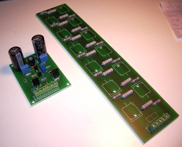

Simplified 300 watt MOSAMP. I have never built it for myself, photo courtesy Gokan and Ersoy from DIYaudioTurkey.

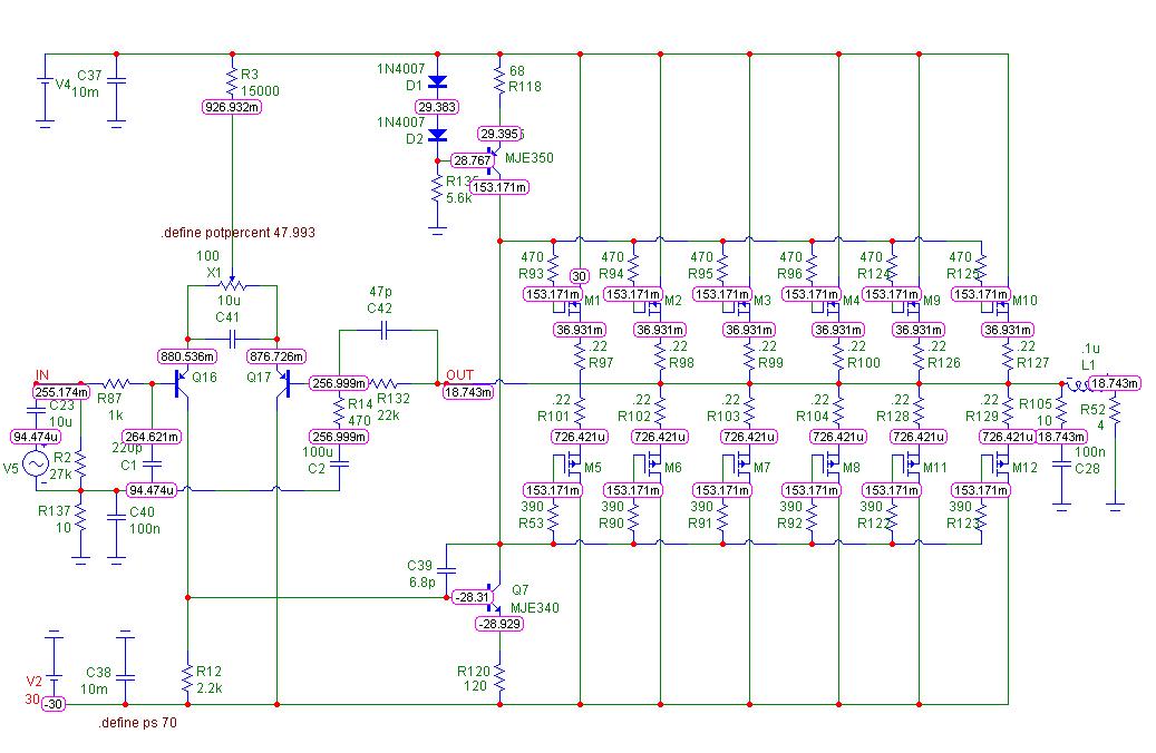

Waylene, I made some modifications to use with a ±30VDC supply so that the node voltages can be measured. Compare values to those you have. Also with such low voltage you could probably use loads of an ohm or even less.
Have a look at this schematic with node voltages, they are as near dammit to the actual but easier to show on the sim. We will work through your amp stage by stage to find what went wrong - ;)
By using X1 you can balance the off-set to near zero volts

Hi Mr Nico,
I build RAS300..this amp very good.Very quiet amp.Zero noise.Good mid and high. But i add 10k trimmer on D1 to adjust bias.

I wouldn't call it "badly designed". I wonder though why Nico has so little current in the VAS stage? The drive capability for the mosfets will be very low meaning a slow amp.
The amp will also run in class B (possibly) since the D1 and D2 is not enough and certainly not trimmable. The Gate threshold voltage is normally aroung 2 volts. This means that the two diodes must produce 4-5 volts at least compared to 1,4 volts right now. It's worth mentioning that the gate voltage can be down to zero volts so in this case you'll have trouble with too much idle current.

That design is from a Hitachi lateral mosfet application note.
It was designed about 1980.
Maplin took it for their lateral mosfet 75WRMS power amplifier.
Many hundreds were sold.
I have built a couple.
I even improved it for my own use and got a pcb made.
I added CCS on LTP. I replaced diode in current mirror with transistor. Added decoupling to front end to stop hum from power supply.
My version sounded much better.
