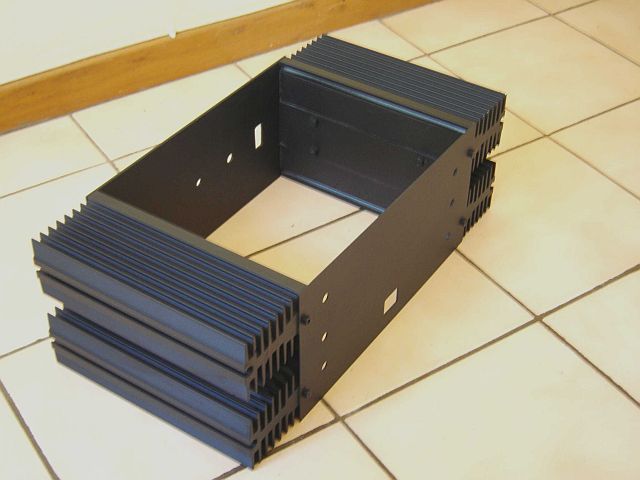

Here is the real >300 watt into 4 ohm version I have never posted before.
I don't make money with it so it really does not matter. What I will say is that I have modified the CCS to that Alex has suggested and it works pretty nicely. Thanks Alex hope you don't mind.
I have Gerbers of the PBCs if anyone is interested. I do not make or sell kits, PCBs, transformers or components, you may do with the circuit as you please.
This one has been made for my friend running the local country club for New Year's eve party, eight channels - installed and cranked up and tested for 5 hours - not bad at all.
I built mono blocks into my standard class A amp very simple case. Heat sinks are for our standard rectifier extrusions used in 500 Amp chargers @ 0.15w/deg C times 4.
Amps are placed at each Altec Lansing 22 inch with horn mid and horn tweeter- Connections to source are mono via RF audio extenders, to the mixing console. These speakers and amps are permanent installations near the ceiling about 3.5 -4 meters high.
The hall is about 60 x 40 m and running all is ******* deafening but he is expecting around 600 people which will change matters dramatically.
You can change this amp, make it better or worse, do whatever you guys please - it is now in the public domain.
Kindest Regards
Nico
Link is below:
http://digisec.co.za/ras/music/300w MOSFET AMP.pdf
