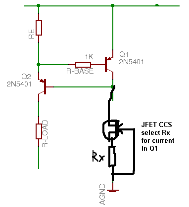

I think AndrewT advice of removing C1 in current source is alright.
The ultimate solution, used by perfectionists,
would be
Replace C1, R1, R2 with a JFET current source
I use many times JFET in, my BJT Bipolar amplifiers,
as current sources for my BC550C/BC560C LTP (long tailed pair) CCS.
I guess you know howto setup JFET for CCS.
1 JFET
1 Resistor
The important thing is: use some JFET that can take 42 Volt!!!
This avoids some other tricks to reduce voltage across JFET.
BF245 takes 30V, 2SK170 takes 40V
2SK117 takes 50V, 2SK373 takes 100V
You better check this - but I think I remember jfet voltage correct.
Of course there are other JFETs possible for such a current source.
Those that I personally do not know of.
Yet.

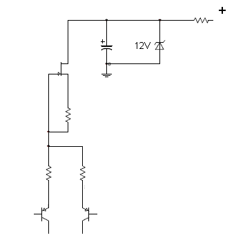

sixtek said:Lineup,
There is no need for min. 40-50V rated JFET if Tcpip chooses the following configuration (see attachment).
sixtek
I see what you mean.
This is an idea, of course. And it would work.
But using BJT, like 2N5401 for CCS to input pair might be better.
Besides 2N5401 takes more than 100 voltage,
JFET and BJT gives a bit different current, when used in current sources.
What I have understood, it has got something with capacitance in FET to do.
Maybe also noise is a factor.
So I still will recommend Tcpip
that he could, like I often do,
use one JFET CCS
to bias his 2N5401 current source.
Of course the final choice is his.
There are many ways to arrange a constant current source for
long tailed input pair stage.
Several of them would give equal good results.
Regards
lineup

lineup said:The ultimate solution, used by perfectionists,
would be
Thanks guys, but I think I'll use the existing BJT-based CCS for this version of the amp, and try to see if the amp works at all. I'm starting with a tried and tested circuit, so I'm trying to make only very small changes. Most of my changes have been to do with PCB layout issues, component placement issues (on-board versus off-board), or changes to decoupling caps, etc.sixtek said:There is no need for min. 40-50V rated JFET if Tcpip chooses the following configuration (see attachment).
As you know, this is supposed to be a very well-known schematic, so I'm just trying to learn how to take a given schematic and translate into a real amp, making as littlle change to the schematic itself as possible.
Larger changes I'll make in the next round.
tcpip said:
Thanks guys,
I have never suggested anything else!
You did not have time to read my post with my suggestion, did you?
Okay here I go again.
The ultimate solution, used by perfectionists,would be
Replace C1, R1, R2 with a JFET current source.
1 JFET
1 Resistor
So this is it:
If you do this, you reduce disturbance from supply lines further.
= higher PSRR, most probably.
If you look at my attachment, you will understand.
And I can tell it is a good model, quite often used in good amplifiers.
The good thing, it will not complicate your amp very much.
You remove 3 components and add 2.
And get better, theoretically, current source for the input pair.
Regards
lineup

tcpip said:
What does the FET do over and above the resistor in that ground leg?
How does it work?
Can you give me the part number for the JFET?
And will any small-signal FET do?
I answered 90% of those questions in my first post about this.
And if your friends in this project is just that: friends
They will inform you the rest.
There are many website links, we could learn 'bout using
JFET as Constant Current Source
As I did put it. See below:
I guess you know how to setup JFET for CCS.
1 JFET
1 Resistor
