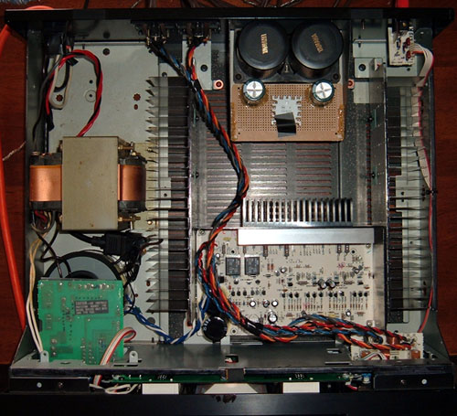

The Yamaha/Accurian Amplifier
The Accurian amp transformer is mounted under the power switch
board and wired into the old Auto Class A switch; the main power
still powers the meters; the old power supply caps and rectifier
will power the two Aussie amps to be mounted on the heat sinks
in the read of the unit.

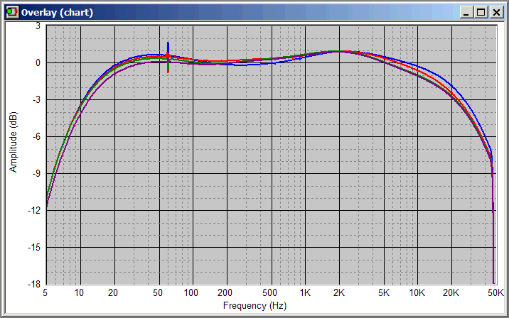

Jim Shearer said:The Accurian has a low freq limit of 50 Hz. I assume this is due to caps on the input to the pre-amp. Can the caps be changed to set the low freq limit down to 20 Hz? If so, then how (what exact parts?)
You can either bypass the input caps or increase their value from the 4.7uF electrolytics that are on the preamp board. There's also a cap on the input to the amp board, but I can't remember the value. I'm not sure you need to do anything. Based on my measurements, the FR is a little lumpy, but solid to 20Hz and has a -3dB of ~10Hz.
Here's all 4 channels of the 2 amps that I got. The tone controls don't have any center detents, so I had to fiddle to get them as flat as possible.
I'm not sure I'm going to keep them. I just don't feel like redesigning the preamp board.
Hope this helps...
--Greg
