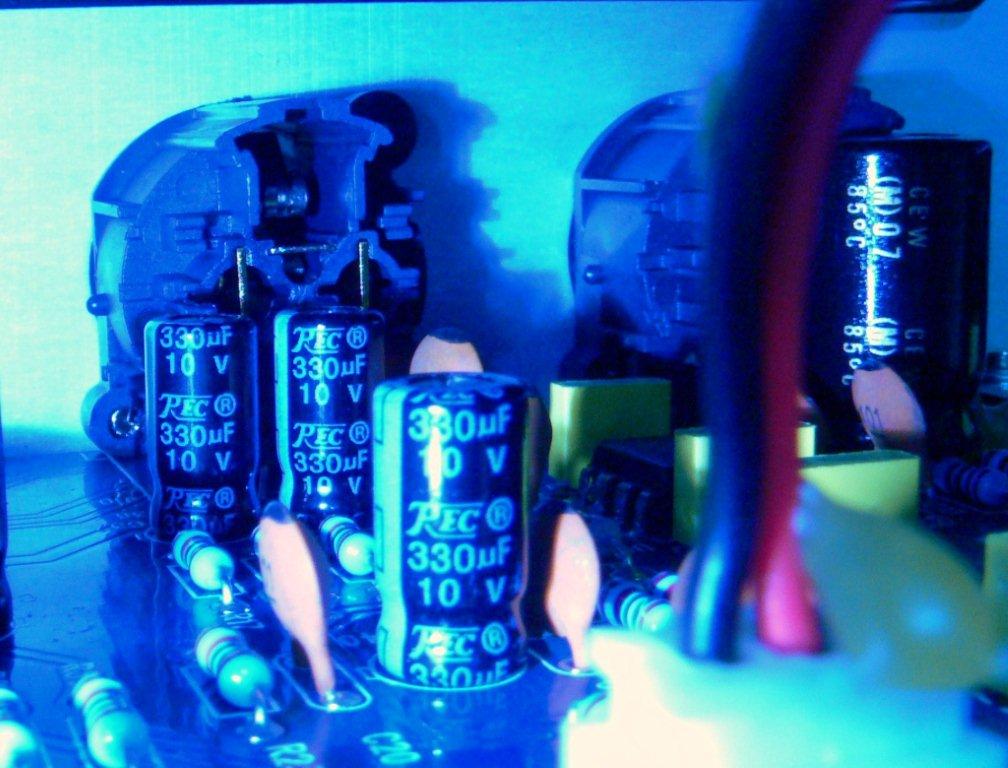

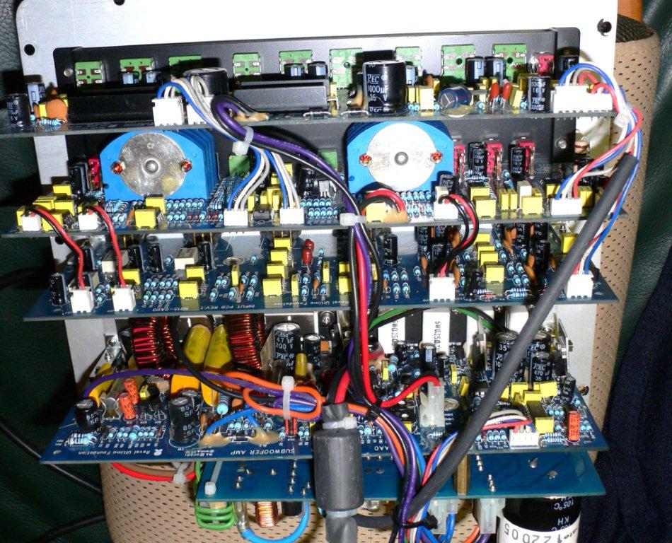

Tony & RJM1 - thanks for comments , please see below pictures , it is indeed 330uf 10v and of general quality , I would say , "Rec" unknown to me ,
there are 3 input caps , 2 for balance and 1 for single end , picture shows R channel , I have modified the L channel with 2 Blackgate 330uf 16v and it does tighten up the bass .
As I only have 1 Sub out from AV processor , I would prefer more gain , 6db at least so that I can have better in hand control , both Processor & Sub had been pushed up for max. out , it is just barely sufficient .
Any easy way to do that ??
Thanks all again !
Larry
