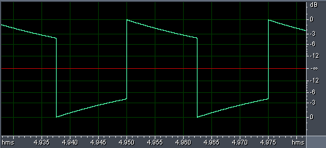

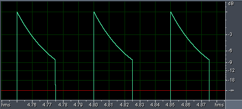

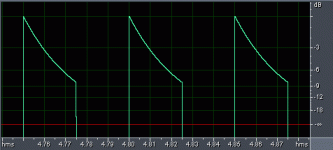

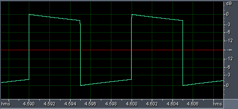

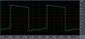

Yes, more to consider than FR: phase. Most people neglect the phase effects of high pass filter formed with blocking capacitors.
Group delay of 6Hz 1st order high pass filter badly smears phase response to well above 200Hz. Effects 20-100Hz in time domain are horrible; as easily seen when passing square wave through filter:
100Hz:
40Hz:
20Hz:
With speakers capable of real square wave performance, the audible difference is easy to distinguish.
National Semiconductor (acquired by Texas Instruments) application note AN-1490 states:
Likewise recording bass accurately is problematic with coupling caps found in recording chain.
Total impact of coupling caps alone makes truly accurate bass reproduction very difficult. This is further complicated by reactive behavior of speaker system.
Increasing filter order only makes matters worse.
100Hz:
40Hz:
20Hz:

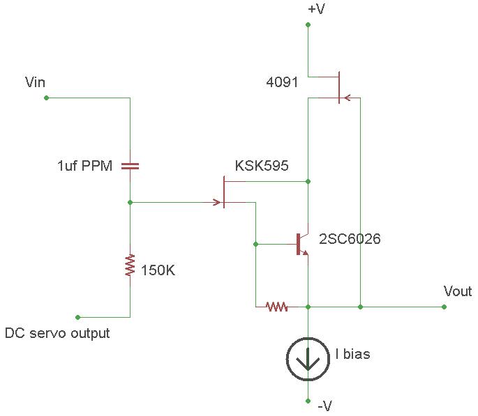

I agree. This type of phase inacuracy between the different bands of the audio spectrum can destroy the soundstage and perception of the music; DA distortion as well. I like to use 1uf PPMF, but this requires a high input inpedance >100K. Then use a simple buffer to drive the input stage. PPMF caps much larger than 1uf are impractical and expensive.
This buffer uses a tiny low conductance J-fet, intended for piezo mic applications. This J-fet acts as a summing point between the DC servo output or "virtual GND" reference and the input signal. The waveform is 20Hz square wave near full power.

That quote from National is a real eye-opener.
But I don't understand what you are trying to show with the plots of square waves at different repetition rates. I see zero phase effects. We wouldn't be able to see phase shifts, from those plots, anyway, since there is no reference to the original phase. A phase shift would mean that the vertical portions of the waveforms would move left or right, compared to the original.
If you are looking at the exponential decay of the tops of the square waves, that has nothing to do with phase. It is the RC filter time constant causing the temporarily-constant-DC voltage to decay, as capacitors always do, through a resistance. The lower repetition rates have longer periods, thus longer to decay, makiing the effect look more pronounced. You didn't mention what capacitance or resistance values were involved, either.
The solution for that exponential voltage-decay effect is trivial: Use a larger capacitance value, or a larger resistance. You can make them stay as flat as you want, for as long as you want. It might also be possible that the voltage-decay effect could be exacerbated by a source that can't supply enough current, or something in the circuit configuration that prevents it from doing so.

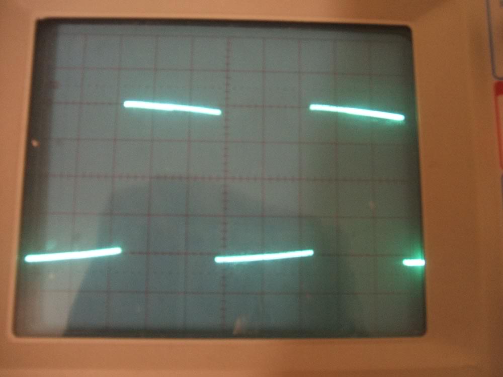

I agree that frequency-dependent phase inaccuracy could be bad for soundstage imaging. But I see no "smearing" of the vertical portions of the waveforms, in Andrew's post.
Also, I cannot see how using an input capacitor, even a "PPMF", would solve a problem caused by using an input capacitor. And if you are using a DC servo, then why have a blocking capacitor??
Also, it appears that your square wave is significantly distorted, maybe due to a blocking-capacitance value that is too low, or a resistance value that is too low, or a source that cannot supply enough current, for some reason. Or, maybe the DC servo's time-constant is acting too quickly, and trying to correct the temporarily-constant-DC parts of the square wave back to zero.
(Assuming your scope probe was properly compensated, the concave shape of the decay of the square wave voltage is not what would typically be caused by an RC discharge effect. So maybe it is just the servo...)

The filter applied in pictures is 1st order Butterworth filter with 6Hz corner.
Square wave is the reference. Everything seen changing shape of wave is phase effect. All harmonics remain at same amplitudes.
Increasing RC as solution seems trivial, but typical input/output impedance of audio electronics narrows choices.

A square wave, when put through a filter with significant frequency-dependent phase shift, which would vary the phase angles (start times) of the square wave's set of odd-order Fourier components (which arithmetically sum to form the shape of the square wave), would mostly show up as overshoot and ringing, of the output square wave, and also as slight distortions of the rising and falling portions of the leading and trailing edges.
Fat caps lose out to fat bonus for trimming costs, at least with commercial interests.
1-2dB droop in peak of every bass transient sticks out a lot more than dropping -100dB 2nd harmonic 1-2dB.
Andrew
HOGWASH.
Try a 0.2 Hz, or 0.02 Hz, corner frequency. Or try a 600 Hz repetition rate.
A 6 Hz corner frequency would never be used, if you wanted acceptable bass response.
Hmmm.... Now that I think about it, you might actually be correct about that being a phase effect (more likely a phase effect AND a way too high corner frequency). But you didn't mention anything about a Butterworth filter in your original post. You implied that the effects were due to a DC blocking capacitor.
At the very least, you should show the input and output square waves plotted on the same scale, and give full circuit details.
