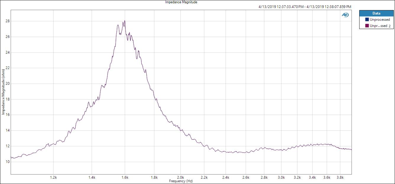

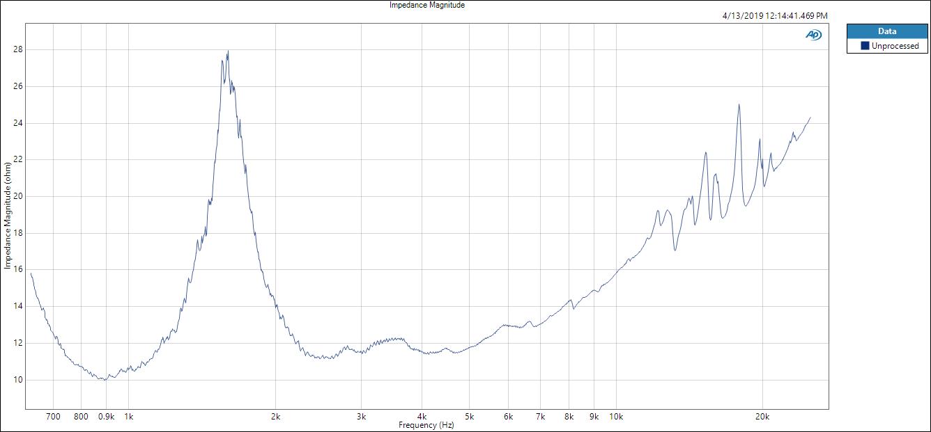

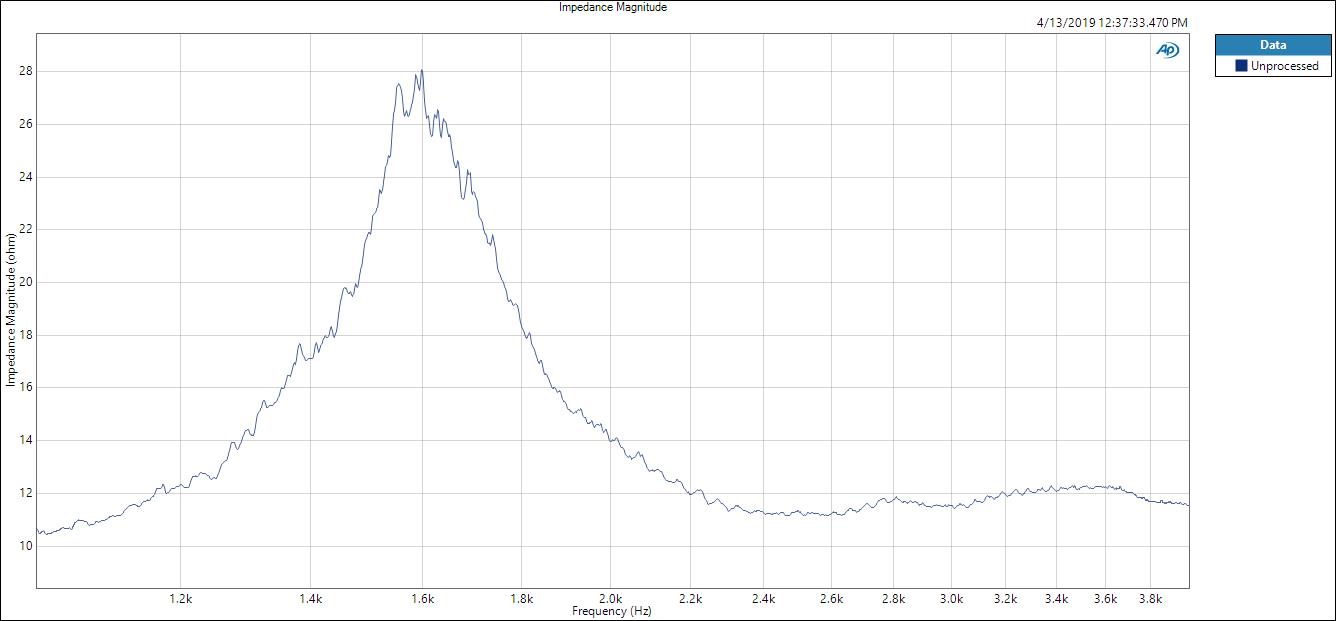

Here is another CD/ waveguide combination.
JBL2451J / JBL PT1010HF-1
The first plot is the first impedance plot of the JBL2451J / JBL PT1010HF-1 CD/Waveguide.
The second attached plot is the first sweep (note the time stamp) with a second sweep appended right on top of the first. The saw teeth are in the exact same positions on the graph.
The third attached plot is the same CD/waveguide with wider band width. Compare the saw teeth on this plot with the other two.
Thanks DT

The peaks are a mere 10-15 Hz apart. Is the building shaking?

There is an optimum smoothing that is based on the resolution of the ear. By using Moore or Zwicker's Critical Band Theory (CB) a smoothing that mimics the human ear can be created. Some smoothing makes a lot of sense because no measurement is without noise, which a lot of the sharp peaks and dips are. FYI they are about 1/20 octave at HFs going down to about 1/3 octave at LFs - but not linearly.

In terms noise I am not so sure that the peaks and dips on the raw impedance plots are noise. The peaks and dips are not random. They are recurring at the same frequencies and magnitude on subsequent plots. I have seen buildings shake due large rotational equipment; fans and compressors. I have seen ripples in the water pitcher on the conference room table.
Prior to software smoothing I am going to try a little damping with Dacron pillow stuffing, wool and 30ppi foam first.
